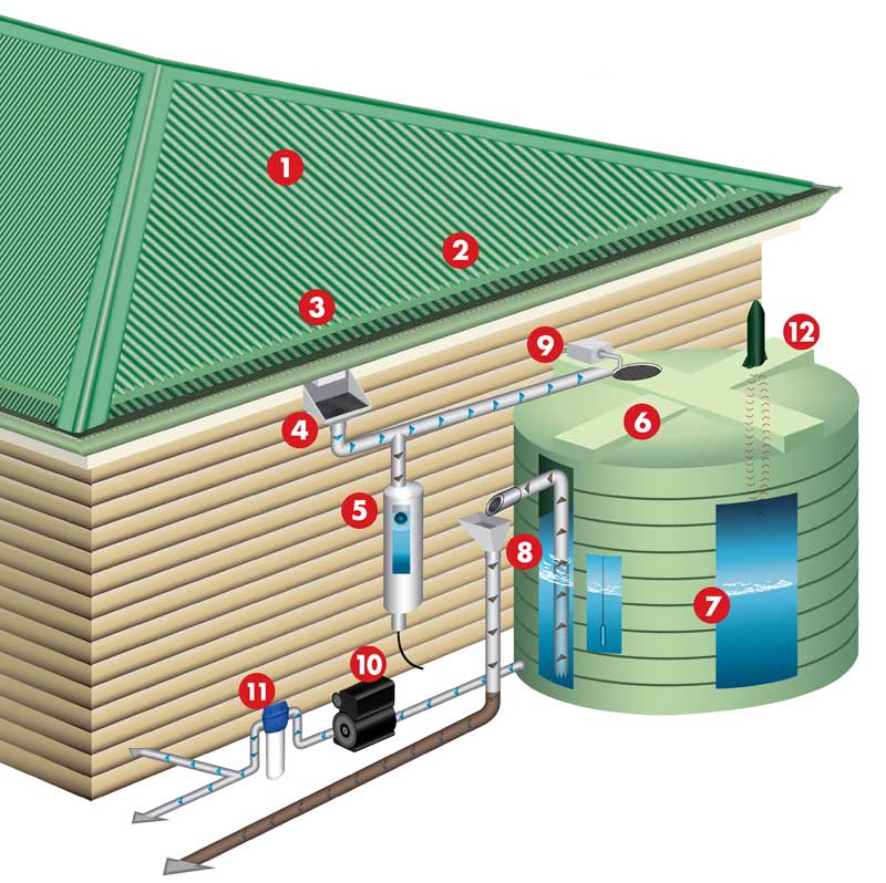

Russell griffiths Posted November 18, 2017 Share Posted November 18, 2017 In oz they fit a system called a first flush it allows the first so many litres to go straight to waste, a floating ball in a pipe then rises to shut off a valve this then diverts the water to a tank. Before the water even gets to the first flush the downpipes empty into a hopper with a stainless mesh in it this gets rid of the big things like leaves. Link to comment Share on other sites More sharing options...
Russell griffiths Posted November 18, 2017 Share Posted November 18, 2017 Like this pic. 1 Link to comment Share on other sites More sharing options...
