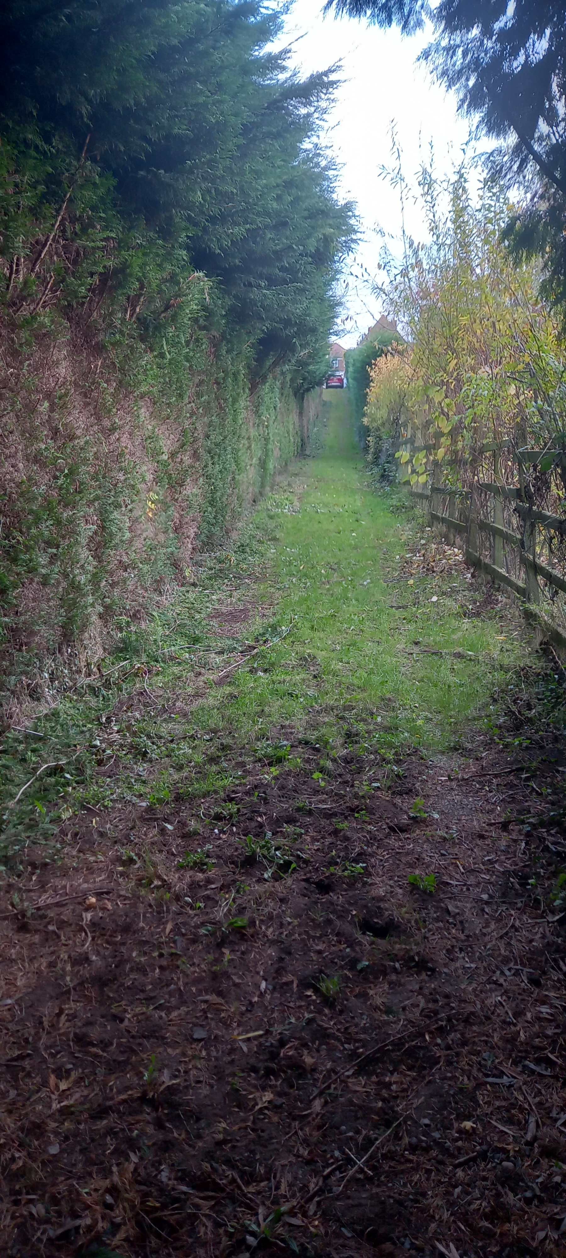

Oz07 Posted November 15, 2024 Share Posted November 15, 2024 I've read up other topics on here and am wondering about this access for fire service. Plot has full pp. Access is just over 2750 mainly around 2900 on average but this does depend on conifers being trimmed. The regs as I read them allow for this width for a reduced distance. It is an 80m run but will have a turning head at the bottom. Can't remember if I read max distance from appliance to nearest hydrant? According to pp the surfacing needs to stay as is ('nt), near non existent apart from some overgrown concrete and tarmac towards the top steep end. Im sure they would be ok with some extra hardcore. I suspect as suggested on other threads will be a case of getting in touch with bc or fire service prior to purchase and getting confirmation of suitability to insure myself. Link to comment Share on other sites More sharing options...
Mr Punter Posted November 15, 2024 Share Posted November 15, 2024 I cannot imagine the fire service agreeing to use a narrow sloping grass track to access the property. Link to comment Share on other sites More sharing options...

kandgmitchell Posted November 15, 2024 Share Posted November 15, 2024 The planners would not have considered FB access to the same degree as Building Control. Look up Requirement B5 in Approved Document B Volume 1 on line - that sets out the basic Building Regulation requirements. Link to comment Share on other sites More sharing options...

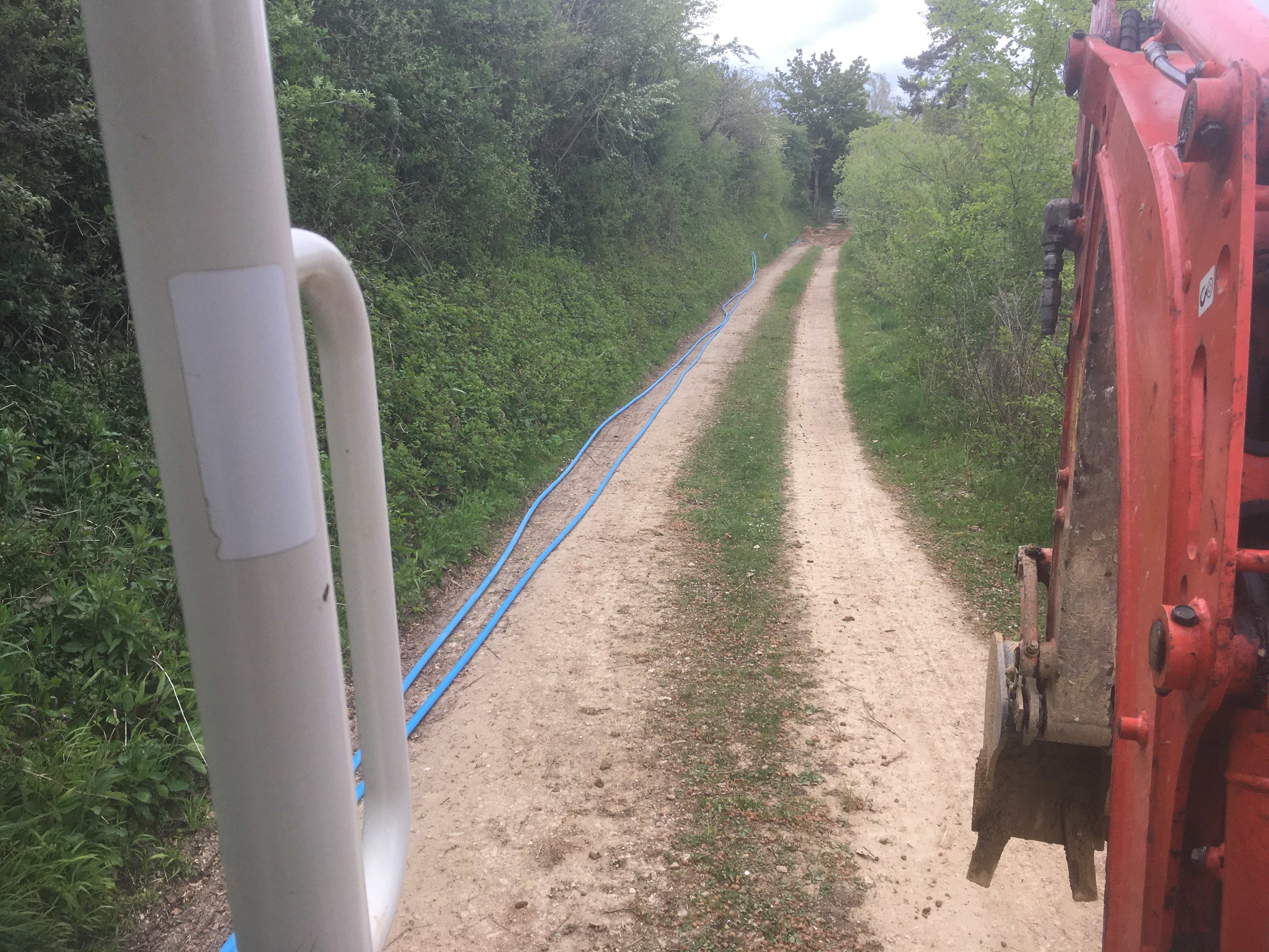

Russell griffiths Posted November 15, 2024 Share Posted November 15, 2024 this is my driveway, which looks huge in width compared with those pics of yours. building control walked up and down it for half an hour checking the width, it was one thing they where sticky about. Link to comment Share on other sites More sharing options...

Ferdinand Posted November 15, 2024 Share Posted November 15, 2024 IIRC the minimum reduced with is 2.75m so you are on the edge, and really need to make sure that your hedge is some way back form that. If if is' your hedge, one way is to replace it it with something better than conifers, and set it back further (which may mean make it thinner). If it is someone else's would they let you replace it. On the surface, I don't see why grass car park reinforcement would be a worse idea - it will be absorbed into the grass, and with little traffic would vanish into the earth / grass. Needs a careful reading of your PP wording, a conversation with the Fire Brigade or check of regs, and perhaps an application for a variation of the condition. Present it as something they did not consider? You could point out (or do if they say no) that you could consolidate the surface by legally driving up and down it 19645 times in a borrowed Fire Engine, so it would be better for all if they allowed it to be reinforced in an eco-friendly manner leaving it looking no different and less vulnerable to being turned into a mud-bath in the winter. A further option could be a sprinkler system, which mitigates risk of fires. 1 Link to comment Share on other sites More sharing options...

Oz07 Posted November 15, 2024 Author Share Posted November 15, 2024 Plot not been purchased yet so all I've got to do is make purchase conditional upon this issue being sorted beforehand. As long as they have in excess of the minimum width, with the turning head at the bottom and the track can support the weight (delivery wagons soon prove this) what can they say? When finished and used regularly track surface would finish up like @Russell griffiths above. Link to comment Share on other sites More sharing options...
