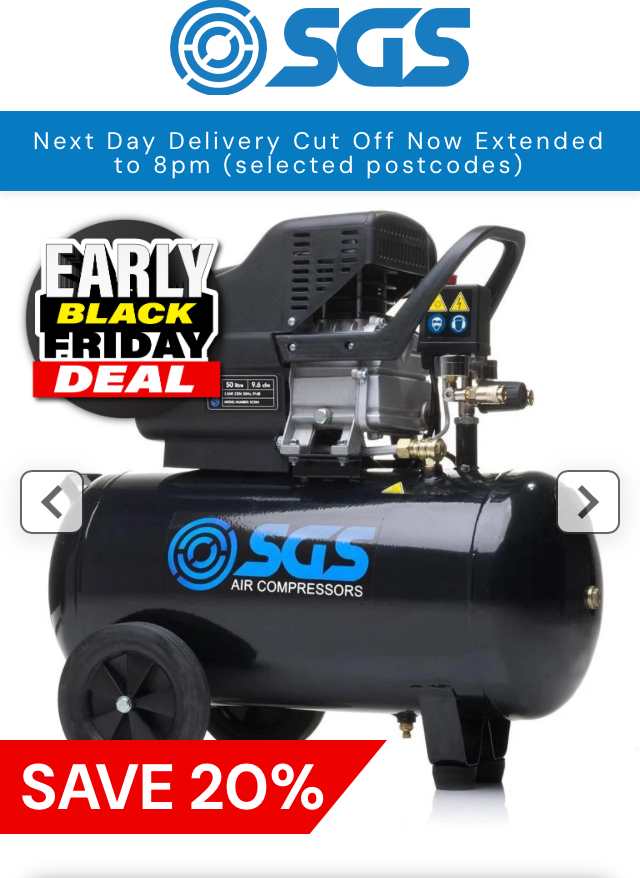

I got mine from here very pleased with it but it hasn’t had too much hard labour. Mainly spray painting, pumping up tyres and blowing dust around.

The oilfree vertical you've got aint 10cfm, maybe calculated but no way in the real world. The piston leaks like a sieve on them. Plus IIRC that model is a brush motor and revs it's n*ts off.
^ that one in the piccy above is the same unit that Lidl sell occasionally and is a real sweetie for the money, the pump is overbuilt compared to  SIPs and Sealeys of the same class
