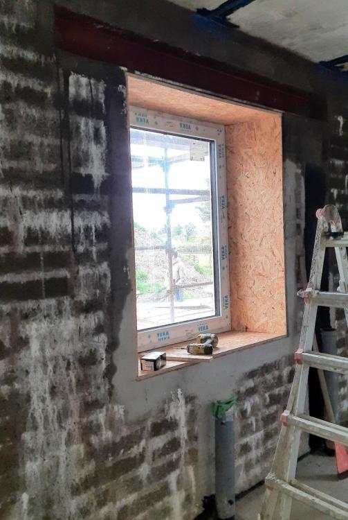

DannyT Posted November 8, 2024 Share Posted November 8, 2024 (edited) With regards to your last question. Some people build a plywood liner on the inside, blocking off the cavity and maybe giving the window something to fix too. something like the link below. https://forum.buildhub.org.uk/topic/19031-200mm-cavity-some-questions/ If your windows sit against the back of outer skin then they should be slightly bigger than opening in my opinion but the inner skin should also have larger opening than the outer to allow windows to be fitted from inside. Windows fitted into the opening should have maybe 4mm a side for allowance. a 1200mm window opening, 1192mm window. Edited November 8, 2024 by DannyT Link to comment Share on other sites More sharing options...
joe90 Posted November 8, 2024 Share Posted November 8, 2024 44 minutes ago, DannyT said: If your windows sit against the back of outer skin then they should be slightly bigger than opening in my opinion but the inner skin should also have larger opening than the outer to allow windows to be fitted from inside. I did this and it’s called check reveals, made the fixing of windows easy to the back of the outside wall, windows are within the insulation area (my reveals were angled as well to give better light penetration). Link to comment Share on other sites More sharing options...

syne Posted November 10, 2024 Author Share Posted November 10, 2024 Thanks all, so with an arrangement as above, the window isnt on the osb? Is the osb just to give a soilid fixing for plasterboard? Im planning on setting my windows in the cavity but they're going to have to sit on the outer leaf a little bit; 20mm or so, as the brick work isnt neat or square enough. If i've got this wrong let me know but my plan of work is; Cavity closers, Windows on straps from inner leaf, Compriband on the edges, Ply box that butts up to inner frame, Airtightness tape on frame to ply, +Airtight on ply reveal to walls? Plasterboard the reveals Then later.. Full fill eps beads,plaster Window board, sealant ect.. Link to comment Share on other sites More sharing options...
Iceverge Posted November 10, 2024 Share Posted November 10, 2024 21 minutes ago, syne said: Thanks all, so with an arrangement as above, the window isnt on the osb? Window bolted to the external leaf and resting on the concrete window sill. The windows is set behind the external leaf. OSB is to close the cavity, and provide Airtightness. It's a completely independent box to the window. Just joined by AT tape. It's foamed and AT painted to the inner leaf and the cavity is completely filled with EPS blown beads. I would alter the method I use the next time by screwing J beads to the windows. Do you have any pics of the openings as they are today? 1 Link to comment Share on other sites More sharing options...
