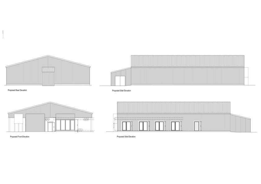

Hi All,
I hope someone sensible can help point me in the right direction or offer some useful comments on our project...!
We'd initially planned to heat the whole place using an oil fired boiler with a wet system - underfloor tray system for the office space with warm air blower to keep frost off the warehouse space in the winter. But now we're wondering whether we can heat the office area appropriately with an ASHP throughout the year, possibly supported with PV panels on the roof? (It's a large roof, approx 250sqm is south facing, unobstructed - we can trim the trees).
Outline as follows:

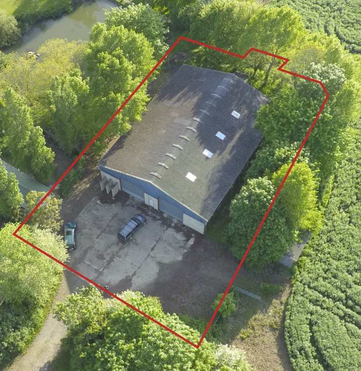

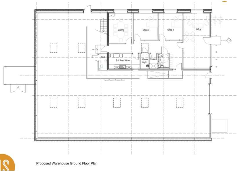

We have a steel portal frame barn which we're converting into a warehouse with internal offices. The existing asbestos roof and steel sides will be replaced with insulated Kingspan panels (KS1000RW 100mm for roof and 73mm for the sides - both with U Value of 0.18 W/m2). The building measures 25m x 17.5m, average height is 5.25m. (see plans)
Within the building is the office, which measures 8.3m x 15m x 2.6m.
Ignore the additional small building on west side it's being demolished.
When it's -3 deg C outside we'll need to maintain approx 10 deg C in the warehouse and 22 deg C in the offices. The place is only occupied during normal office hours. i.e. I'm not worried about keeping it warm at night, just that it doesn't freeze!
We guess our heat demand would be approx 4kW for the office area and 16kW for the warehouse. (Maybe someone can tell me if this is miles off?).

Proposed.pdf Floorplan.pdf birds eye.pdf

offices, you can build these to a very high standard inside the main building envelope, so easy to heat.
I would fit air conditioning units in here so you can cool in the summer and heat in the winter.
fit Solar to offset the cost of running the air conditioner in the summer.
the warehouse space is a different ball game, forget the u values of those sheets, unless you build this meticulously it will still be a draughty warehouse, you will struggle to get any form of sensible amount of heat in it without it escaping out of every roller door, or roof to wall junction, the floor is one huge cold spot sucking any warmth from the building.
either an oil or gas hot air blower system is the only thing I know that will heat that amount of volume.

You heat the office with ashp, and remember to insulate the walls to the warehouse, and the ceiling.
A lobby at the outside door will keep the heat in.
The warehouse doesn't need heating.  It would be hideously expensive to do so, and it would end up hot in the roof and cooler at the floor.
Heat loses through open loading doors are extreme, of course. Through a closed loading door there are still draughts especially at the spring unless you go for top of the range.
If your concern is for the product , then install a primitive gas or oil heater linked to  a thermostat. It may only fire a couple of times a year.
More importantly, keep the door shut.
