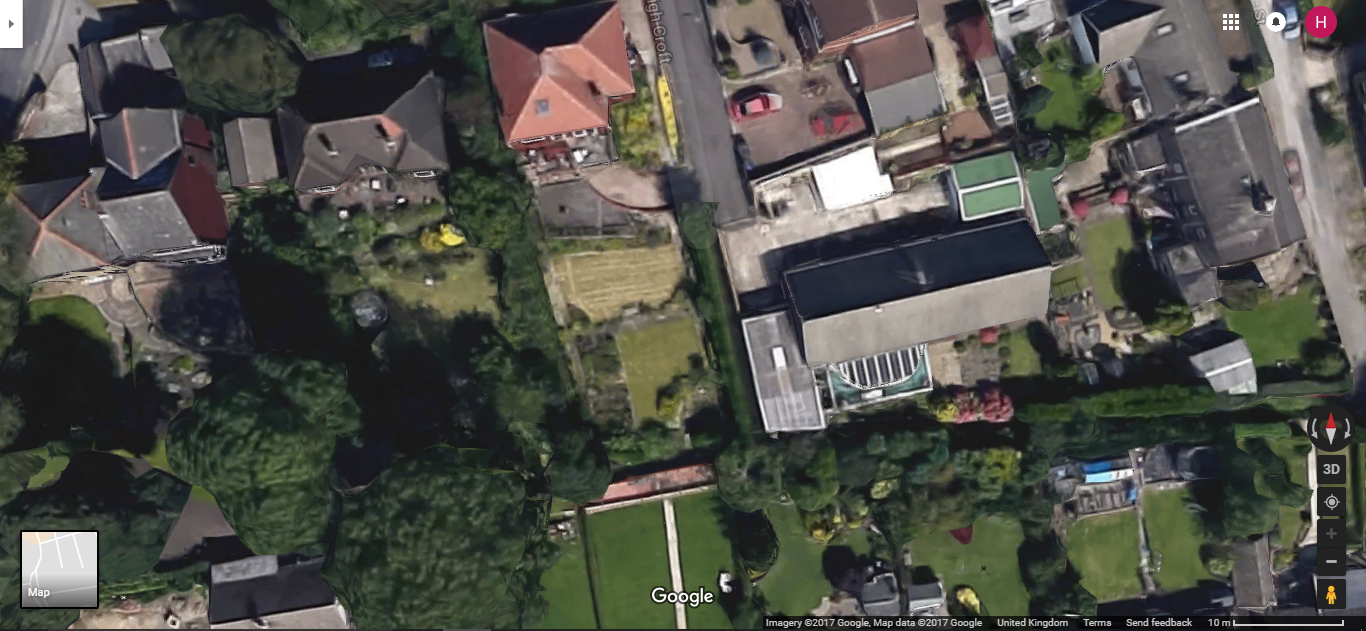

Hecateh Posted November 15, 2017 Author Share Posted November 15, 2017 (edited) The plot is in the garden of my bungalow, the red roofed one in the picture. You can see the trees to the south west of the site Edited November 15, 2017 by Hecateh personal info on photo Link to comment Share on other sites More sharing options...

Ferdinand Posted November 15, 2017 Share Posted November 15, 2017 (edited) @Hecateh Consider the opportunity to make sure your design allows room for a suitable access cul de sac that will not disturb the new or old bungalow, so that you can give access to the next 2 or 3 gardens at some point in the future. ANd the ones that face you back to back. An access route for 3 similar bungalows may be worth nearly as much as your whole plot with pp. It needs to be able to cater for access by fire engines and potentially dust carts etc. That town centre location looks to me to have potential for backlands development at some stage. Edited November 15, 2017 by Ferdinand Link to comment Share on other sites More sharing options...

Hecateh Posted November 15, 2017 Author Share Posted November 15, 2017 (edited) 9 hours ago, Ferdinand said: 9 hours ago, Ferdinand said: @Hecateh Consider the opportunity to make sure your design allows room for a suitable access cul de sac that will not disturb the new or old bungalow, so that you can give access to the next 2 or 3 gardens at some point in the future. ANd the ones that face you back to back. Looking at my photo to discover how you knew it was a Town centre location made me realise how much info I had left on there. Not that I think identity theft is likely on here but postcode, email etc on internet - not really a good idea lol. I have now edited the photo. Did you decide it was town centre just because of the photo or did you look up the location. As far as access is concerned - sounds great in principle and there could just about be room to put one in BUT I only just got this one passed as Barnsley (currently) won't approve tandem developments and a local councillor was trying to object on those grounds as the current bungalow has a garage (which will become just a store) under the lounge. The ground slopes a lot more than can be seen from the photo. Garden grabbing from all gardens without my new build would certainly have had scope for half a dozen houses with modern sized gardens. The main reason I want to stay in that location. Small town centre to the North and views to the South, New propety wont' have quite the same views as will lose depth but still amazing Edited November 15, 2017 by Hecateh Link to comment Share on other sites More sharing options...
Ferdinand Posted November 16, 2017 Share Posted November 16, 2017 (edited) @Hecateh I put the postcode into Google. The thing about preserving the *opportunity* for further access to potential plots is to keep options open, which is often easy, and that it actually uses far less space than most people imagine - I have a modern (less than 20 yeas old) development nearby where the access cul de sac is less than 5m wide for about 5 houses. If allowed, I think the minimum width for emergency services access is around 3.5m at a narrow point for up to 5 houses (varies by County Authority - it is I think a building regs matter not planning). Looking briefly at your PP before I forget where it is I think you have room for such an access through the new front parking space, but I would take perhaps 1-1.2m extra off the back garden of the existing house in that corridor when you sell it compared to the plans just to be sure. Boundaries are not a Material Planning Consideration, so the Planning Authority are very unlikely to do a thing about it and once in place it will not be expedient to do so. You will lose nothing, and will have kept the option open for the future. IMO in 15 or 25 years that site (ie next doors' gardens) will be crying out for a small retirement development of 3 or 4 bungalows walkable to town. Personally I think that - given the lack of housing land and ageing population we have - access to future potential plots inside community boundaries should be a material planning consideration, but currently it is not the case. Ferdinand Edited November 16, 2017 by Ferdinand 1 Link to comment Share on other sites More sharing options...
Hecateh Posted November 16, 2017 Author Share Posted November 16, 2017 (edited) @Ferdinand Thanks for that thought A combination of moving the house forward half a metre or so and pushing the boundary should achieve that - and like you say, nothing to lose. Will let you know if I manage it. Hopefully ground clearance starts beginning of December - Edited November 17, 2017 by Hecateh Link to comment Share on other sites More sharing options...
