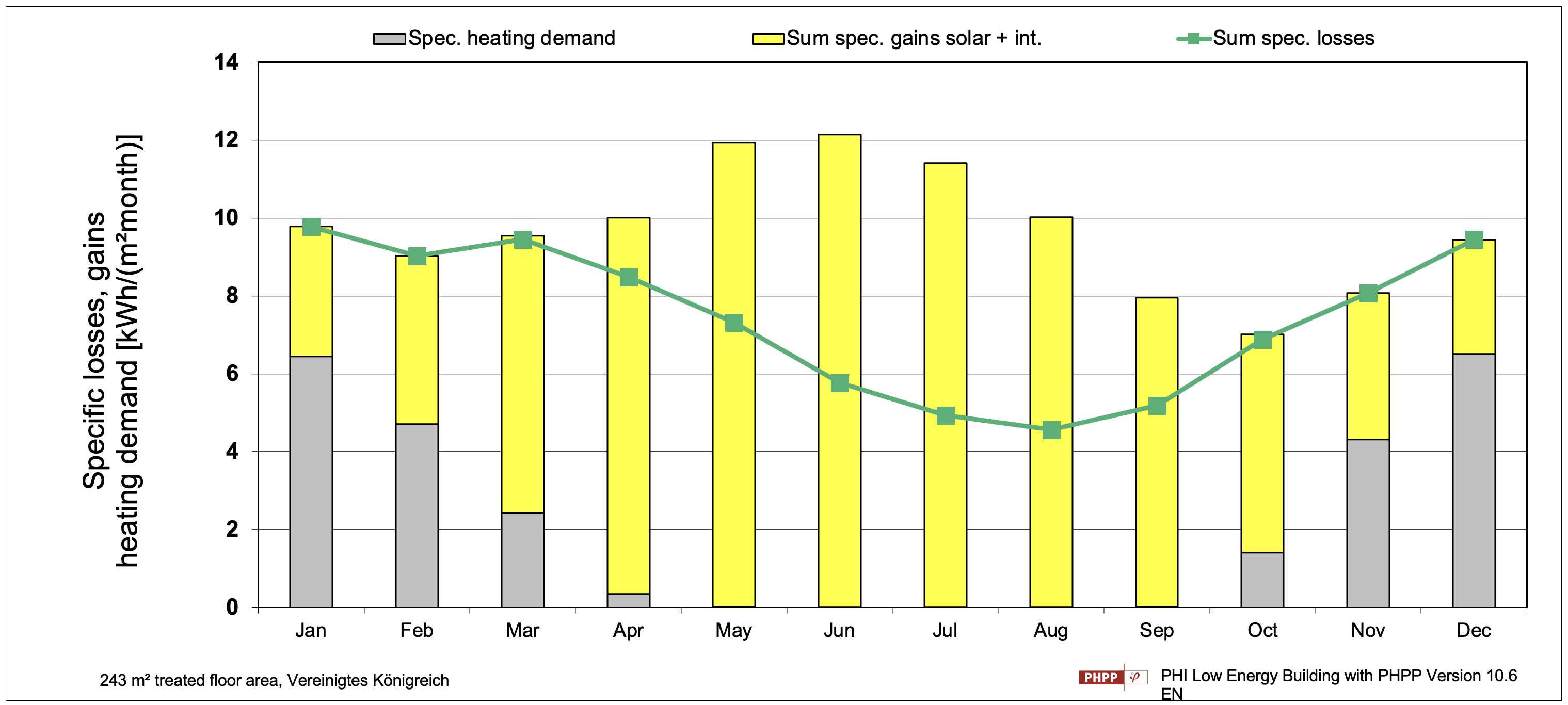

Muellar Posted October 27 Share Posted October 27 Hello It’s been a while since I posted as we’ve been busy with design updates, as well as being busy working to save money for a new build! I’ve also been reading articles here (thank you all) as well as doing my own attempts at calculating loads as there’s quite a mixed view and now I’m in a position to share what I did in the hope that maybe it’ll be helpful for someone else and to discuss on this forum. Some key figures about the house are: 1. New build ICF on a hillside outside Antrim 2. Nearest weather station is Aldergrove but I adjusted for exposed site 3. Zinc/Ali clad for 30% of the perimeter then timber cladding for the remainder 4. Total NIA is 290m2 and habitable (excluding garage and plant room) is 243m2 5. Internal volume is 946/822m3 respectively. It’s large as we have a few vaulted ceilings to make the most of the views out towards Lough Neagh 6. There’s 186m2 of external walls with 91m2 of glazing 7. U values I’ve got are walls will be 0.14, floor 0.13 using TLA, vaulted ceilings/roof is coming out at around 0.1 and windows will be a mix of DG/TG – DG purely for sliding doors due to weight 8. Will install UFH with an ASHP, maybe GSHP as there’s a lot of digging anyhow Using the spreadsheet provided by Jeremy Harris I got a total heat loss of 6394 watts. I then went a decided to buy the PHPP software to learn more, and put in all the data needed. That took a lot of effort and I had to fiddle the windows section but that came up with a lower figure so I’m having to work through it again when I get some free time. The profile from PHPP looked right however, max heating in Jan/Feb/Nov/Dec and correlated with what a couple who built an ICF home in the area back in 2019 have found with their GSHP. Here’s a copy of the PHPP losses profile: The initial PHPP results are coming out at 28 kWh/(m2a) and a heating load of 15 W/m2 which was arrived at from a max total of 65.7 kWh/(m2a) which was then reduced by solar/internal heat gains of 38 kWh/(m2a). I need to spend more time on this PHPP sheet to ensure I’ve got it right as the figures just seem too low, and I’ll do that when I get the time. We are now producing the necessary working drawings and will get the electricity load calculated on the basis of a 7kW heat pump unit. Link to comment Share on other sites More sharing options...

Muellar Posted October 28 Author Share Posted October 28 @Russell griffiths @Nickfromwales DG/TG conundrum is really down to weight and value for money on the extra cost of TG against benefit gained. We will decide when we get quotations. Should be easy for a supplier to give us both once they've got the sizes and type entered. @Conor being in tropical Co Down you've made me think about resizing up our heat pump as we'll be up on a hill outside Antrim (210m above sea level) so it'll be a lot cooler than where you are is my guess. I thought i'd accounted for this but your comment re running it for 20hrs has made me think... we were going to have a wood stove but removed that, now I'm wondering! In terms of the glazing thanks for the comment re Feneco; the largest sliding doors we'd have would be 2.3m wide, we've got a few sets of them. Link to comment Share on other sites More sharing options...

Muellar Posted October 28 Author Share Posted October 28 @Nickfromwales@JohnMo sound advice and is what i've done previously, it'll be intersting to see the relvative cost difference between D/TG from the same supplier, that is where I'd be looking at the pricing in detail than purely going for a cheap set of windows. Interesting comments on bi-fold v sliding. My head was in the place that sliding would be more water/air-tight than bifold (fewer moving parts/less seals etc).. Your 'bifold over sliders every damn day' has got me thinking. Just to give you some context, we have 3 main large openings. Main bed = 5.5m, Kitchen/Dining/Lounge = 8.4m and Rear onto patio = 4.4m. Our SE has managed to design in a beam so the 8.4m opening can be clear span. 1 Link to comment Share on other sites More sharing options...
JohnMo Posted October 28 Share Posted October 28 13 minutes ago, Muellar said: 3 main large openings. Main bed = 5.5m, Kitchen/Dining/Lounge = 8.4m and Rear onto patio = 4.4m Big openings, hope you have done something to manage thermal gains from the sun. You may fry with low spring and autumn sun. Link to comment Share on other sites More sharing options...
Muellar Posted October 28 Author Share Posted October 28 23 minutes ago, JohnMo said: Big openings, hope you have done something to manage thermal gains from the sun. You may fry with low spring and autumn sun. I did wonder about that JohnMo, however the PHPP came up with no issues on overheating when I put in the stats for natural ventilation and as we're on a hillside outside Antrim we can readily open up and ventilate - fly screens needed! I'd seen more benefit from the heat gains in late autumn/winter/spring than a risk on overheating given location (temp/wind) and the limited days of sun/warmth we have. lol Link to comment Share on other sites More sharing options...
JohnMo Posted October 28 Share Posted October 28 Good you've looked. 1 Link to comment Share on other sites More sharing options...
Muellar Posted October 28 Author Share Posted October 28 40 minutes ago, JohnMo said: Good you've looked. I should have added that I the main bed will have a balcony so the windows are quite set back, same for the larger 8.4m so we'll also look at practicalities of shading as we get more into it but I guess you can only design so much out/in. Not sure if you saw my original post when I joined, but we've got these windows all there becuase of the view out over Lough Neagh. We did toy with reducing window area, but we felt we'd just ruin the point of building where we would be, and thermal gain/overheating was on the top of my worry list. But great that you mentioned it. Thanks. Link to comment Share on other sites More sharing options...
JohnMo Posted October 28 Share Posted October 28 4 minutes ago, Muellar said: but we've got these windows all there becuase of the view out over Lough Neagh. We did toy with reducing window area, but we felt we'd just ruin the point of building where we would be We are in a similar position on a hill over looking a Loch, we have loads of glass also. We use UFH in cooling mode and it effective in knocking the thermal gains down a bit, but importantly reduces the recovery time to normal temps, quite quickly. It not Aircon, but effective enough, for no cost. 1 Link to comment Share on other sites More sharing options...
