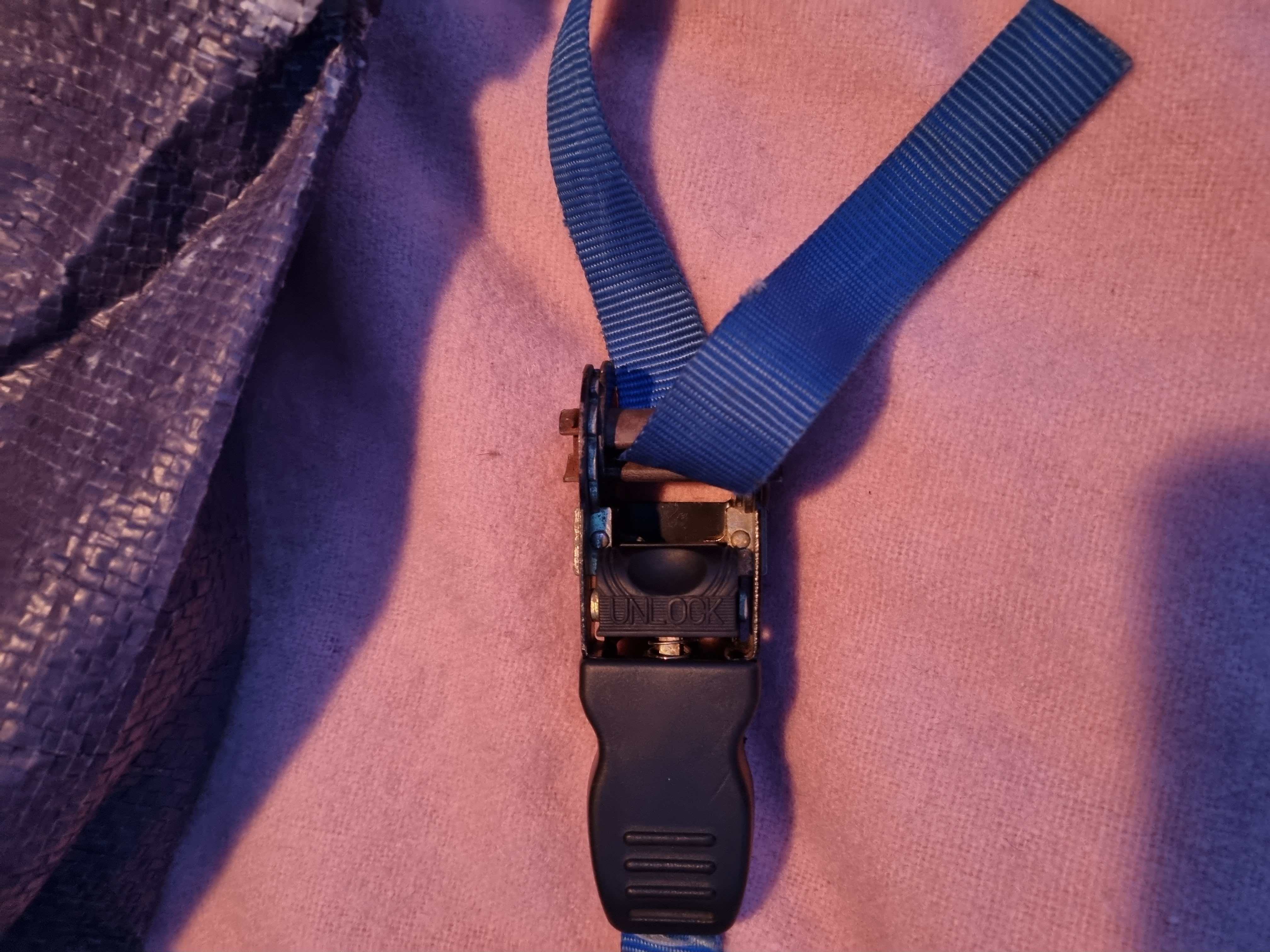

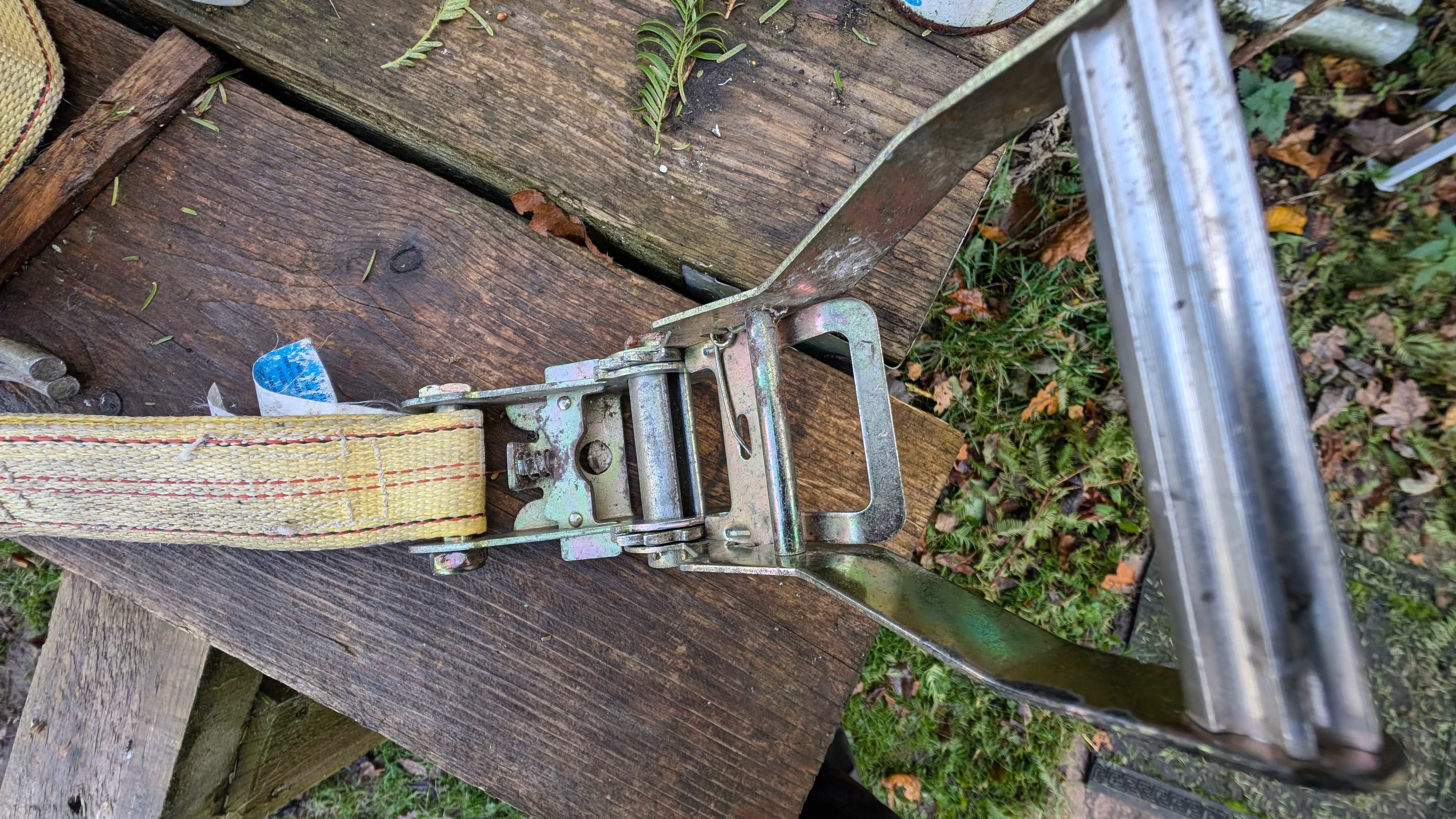

ToughButterCup Posted October 26, 2024 Posted October 26, 2024 (edited) ... ratchet strap 9 years in and I still have to work out how -quickly- to lead the loose end into the ratchet so that the loose end can be tightened easily (doesn't double-up or get in the way of the ratchet handle) stowed neatly loosened easily. I take good care of the ratchet mechanisms. I stow the strapping out of the sun and weather. I've watched God knows how many YT videos.... I still can't do it quiclkly and easily. And this morning a lad who works for us gardening on Saturday mornings asked me to teach him how to use one. Got myself into a bit of a lather getting it wrong - as usual. Told him I'd show him next week. Most of the year they stay in their dry store, packed away neatly. But when you need one - you really need it. And I feel more of a plonker than usual when it takes about 6 goes to get it right. First Time . Anyone have a fail-safe way of threading the strap through the ratchet correctly? First time? Edited October 26, 2024 by ToughButterCup

Kelvin Posted October 26, 2024 Posted October 26, 2024 (edited) Open the ratchet and lay it flat. Feed the strap through the mandrel slot and then fold it back over the top of the mandrel and through the ratchet. If the strap is very long you might need to pull a lot of the excess through. Attach the hooks and then tighten the ratchet. I have the hooked straps and some straps without hooks which are an absolute swine to use. If you look at lorries you’ll often see they put a twist in the strap to stop it sliding off the load it’s securing. Edited October 26, 2024 by Kelvin
ToughButterCup Posted October 26, 2024 Author Posted October 26, 2024 43 minutes ago, Kelvin said: Open the ratchet and lay it flat. ... Ok, but - which way up?
G and J Posted October 26, 2024 Posted October 26, 2024 1 minute ago, ToughButterCup said: Ok, but - which way up? On mine it doesn’t matter. I find it easier to lay it on the floor, take up a couple of turns so the strap won’t slide out, then attach it to the job. Doing it in situ is much more fiddly.
ToughButterCup Posted October 26, 2024 Author Posted October 26, 2024 10 minutes ago, G and J said: .... Doing it in situ is much more fiddly. Yes. Exactly. Invariably I'm fiddling about up a ladder, loose end in hand but drop the standing end - (or some other variant of that) , swearing under my breath . I'll try putting it on the ground first, take up a bit of the strap first and then hook up. Thanks Ian
Kelvin Posted October 26, 2024 Posted October 26, 2024 38 minutes ago, ToughButterCup said: Ok, but - which way up? On its back. Whichever way allows you to operate the ratchet
G and J Posted October 26, 2024 Posted October 26, 2024 15 minutes ago, Kelvin said: On its back. Whichever way allows you to operate the ratchet On mine I turn the spindly bit with me fingers to get it started, dead quick.
ProDave Posted October 26, 2024 Posted October 26, 2024 A small ratchet, if needing to tighten with a long tail, rather than pass it all the way through, double it up and pass the dead end doubled up a little way through and start ratcheting. There is no right or wrong way.
Kelvin Posted October 26, 2024 Posted October 26, 2024 13 minutes ago, G and J said: On mine I turn the spindly bit with me fingers to get it started, dead quick. The main thing is to avoid winding on too much of the strapping. I loaned a set to an old neighbour one time. I asked him if he needed instruction on how to use them. Aw naw he says. Dun it loads. I got back a mangled mess of strap and ratchets. Took me two hours to unravel the mess he’d made of four sets of them. So there’s definitely a wrong way to do it. The same guy couldn’t mount the strimmer wire for his strimmer. Wouldn’t accept any help and spent his time strimming a bit then taking the reel apart to unwind more wire and strimming some more.
BotusBuild Posted October 26, 2024 Posted October 26, 2024 Ratchet handle "closed". Have the slot which the strap goes through in the position you can see through it (may need to ratchet it round before closing the ratchet.) Feed the fly end, or the loose end, of the strap from the bottom of the slot up towards you - you should be able to see it coming through if the slot is lined up nicely as above. Pull the loose end through as much as you can to take up the slack. Holing the loose end hand tight, now start ratcheting. Tie off any spare strap 2

ToughButterCup Posted October 27, 2024 Author Posted October 27, 2024 @BotusBuild - that's the one..... Thanks so much. @G and J highly likely to be correct. Add that to me needing to get something strapped quickly, doing it up a ladder, cross and tired at the same time, sure I'm going to mess it up...
