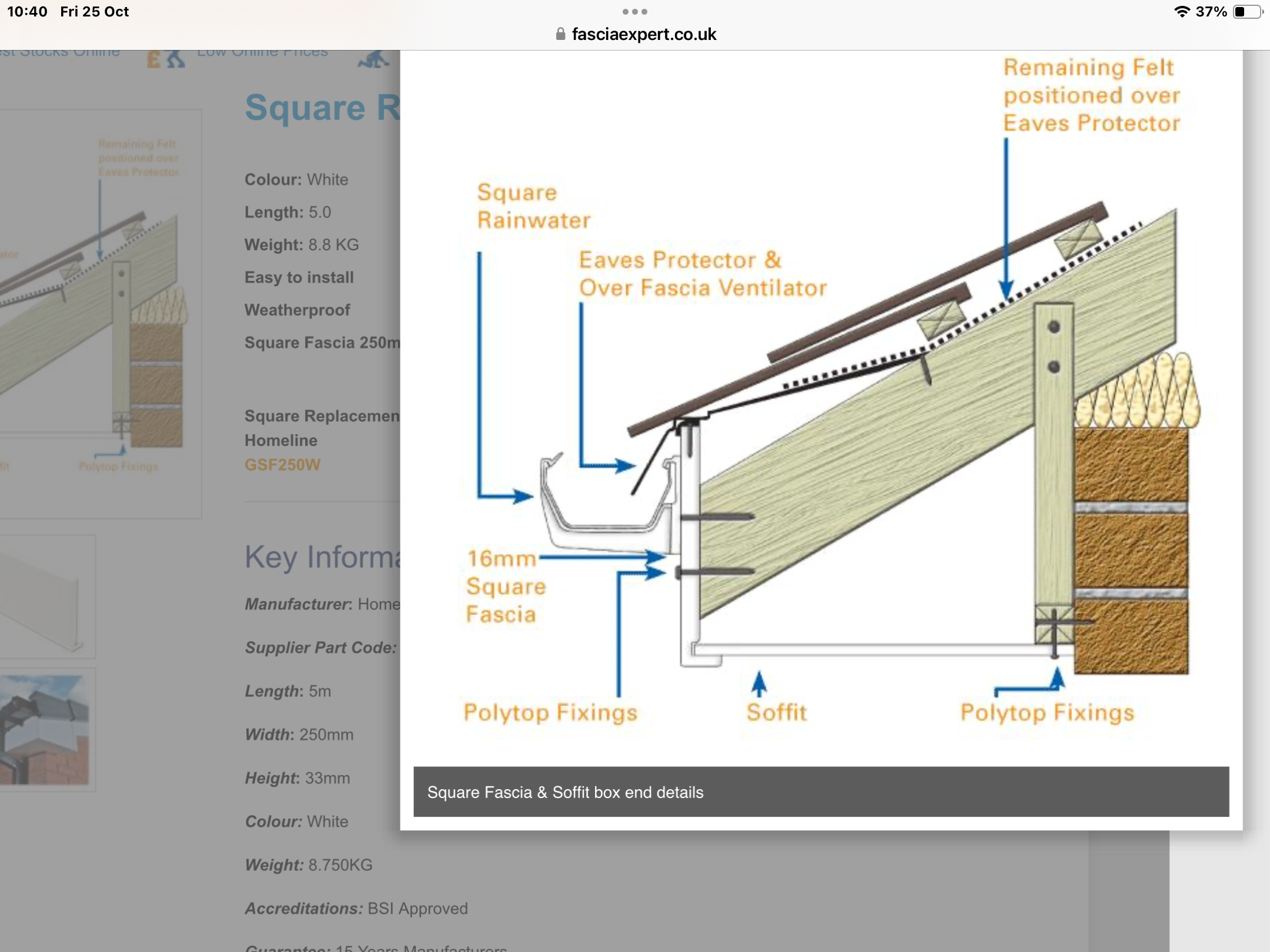

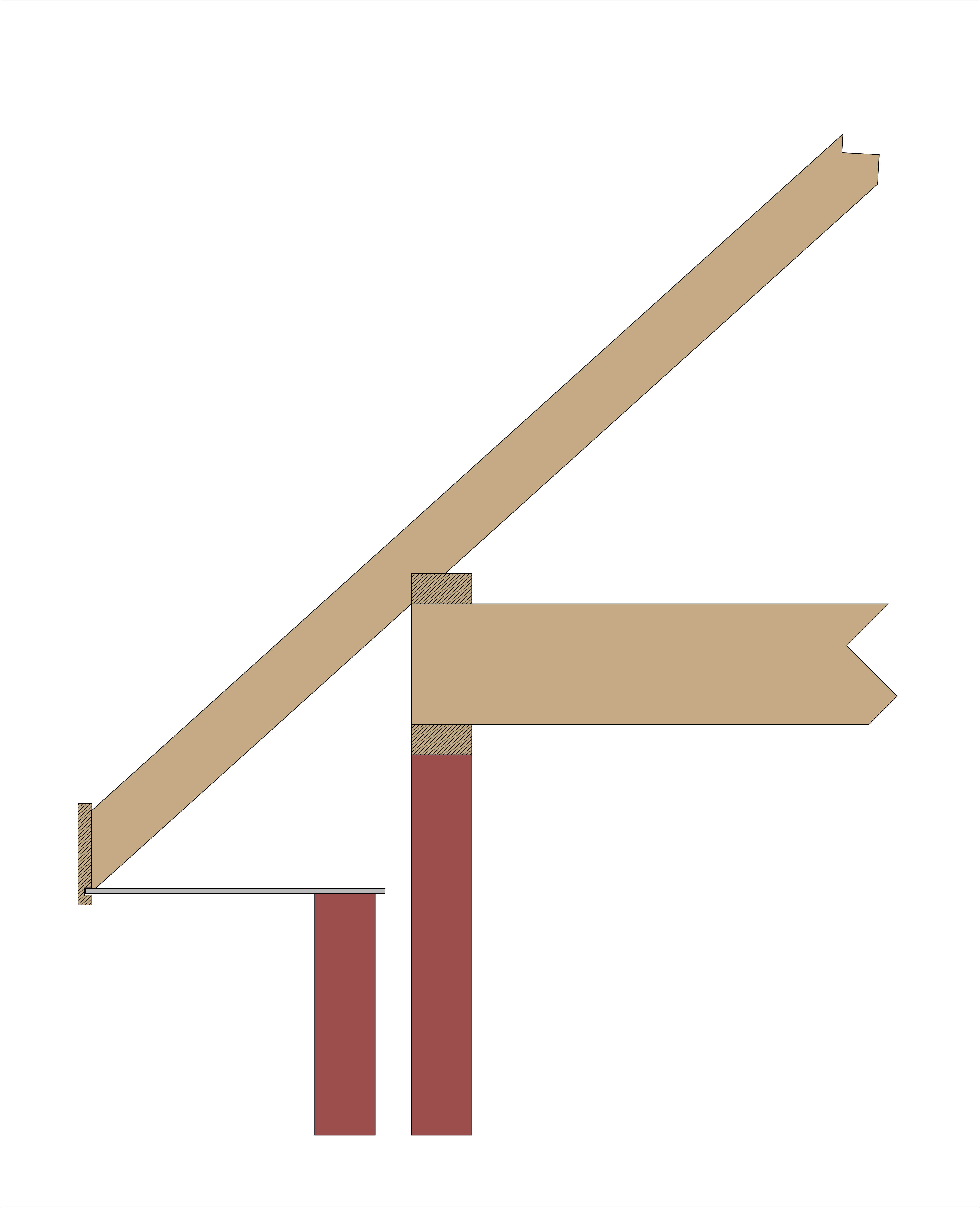

Del-inquent Posted October 24 Share Posted October 24 We are having all the soffits on our Chalet Bungalow taken out shortly as they're asbestos cement and the window installers want it gone first. I'm just not sure about how to replace them, never done any on a roof structure like this before. There is nothing at all supporting the soffits at the moment, they're just sat upon the external leaf and held in place by a groove on the back of the fascia panel, nothing to attach any replacement to at all. The facia's may well be replaced as well, will have a look at the condition of them once the soffits are down as they're currently capped with UPVC (badly). Soffits are 380mm from wall to fascia. I wanted to replace them with UPVC, cheap and cheerful and as little fuss as possible and if the fascia's do need replacing (pretty likely) I'll use 18mm UPVC ones. How would you approach it? Link to comment Share on other sites More sharing options...
saveasteading Posted October 24 Share Posted October 24 Fix a triangular batten under the rafter against the fascia, and screw up into it? 1 Link to comment Share on other sites More sharing options...
Del-inquent Posted October 24 Author Share Posted October 24 9 minutes ago, saveasteading said: Fix a triangular batten under the rafter against the fascia, and screw up into it? Would you bother with any additional support for the soffit - like ply run underneath the batten before the soffit goes on, or just straight up with some soffit? Link to comment Share on other sites More sharing options...
saveasteading Posted October 24 Share Posted October 24 Depends on the soffit. Is it stiff and can pan that distance? You will have to fix it at the wall side too. A batten on the wall. Link to comment Share on other sites More sharing options...
Del-inquent Posted October 24 Author Share Posted October 24 4 hours ago, saveasteading said: Depends on the soffit. Is it stiff and can pan that distance? You will have to fix it at the wall side too. A batten on the wall. I guess as it'll be sitting on top of the wall and pinned every 400mm (or thereabouts) plus supported by the fascia, probably should be okay. Can't put a batten on the wall as the wall stops just below soffit height lol Link to comment Share on other sites More sharing options...

Russell griffiths Posted October 25 Share Posted October 25 far easier to find you a pick than try and explain. 1 Link to comment Share on other sites More sharing options...
Gone West Posted October 25 Share Posted October 25 2 hours ago, saveasteading said: Will it displace if you hose it, brush it, ir with the wind? Will gaps fill with insects? The wind has never moved it. I've not tried hosing it because I didn't want water going in the vent slots. I have brushed it with a broom and it was ok. To a degree it is held in place by the slot in the fascia. I won't be altering it for the time being. Link to comment Share on other sites More sharing options...
Del-inquent Posted October 25 Author Share Posted October 25 12 hours ago, Russell griffiths said: far easier to find you a pick than try and explain. Interesting, I’d never have thought that would be sufficient on the width but I do have a habit of over-engineering everything. Link to comment Share on other sites More sharing options...
Russell griffiths Posted October 26 Share Posted October 26 10 hours ago, Del-inquent said: Interesting, I’d never have thought that would be sufficient on the width but I do have a habit of over-engineering everything. Run the horizontal batten the full way around the house, not just little bits, you can add a batten front to back as well. 1 Link to comment Share on other sites More sharing options...
