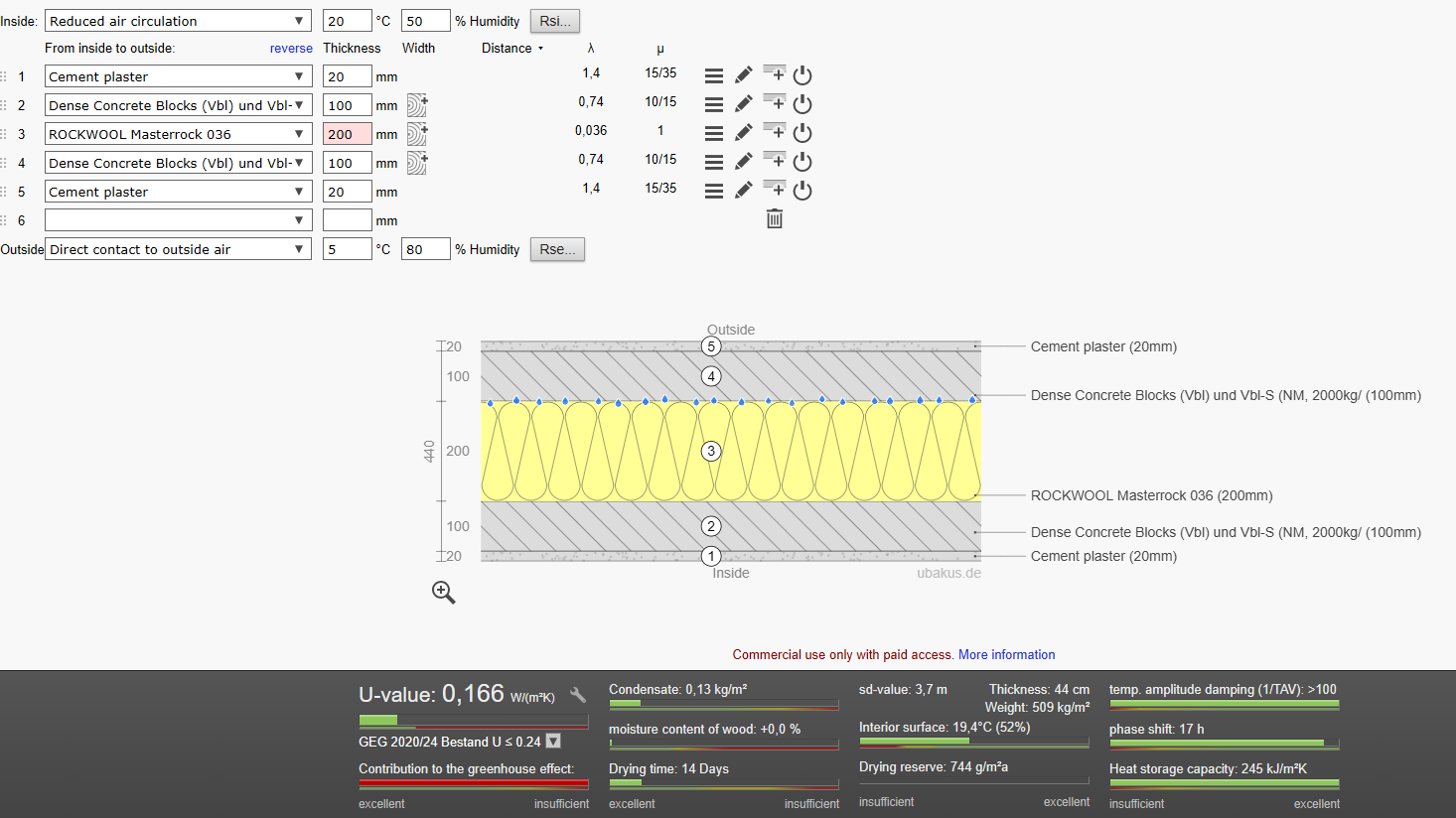

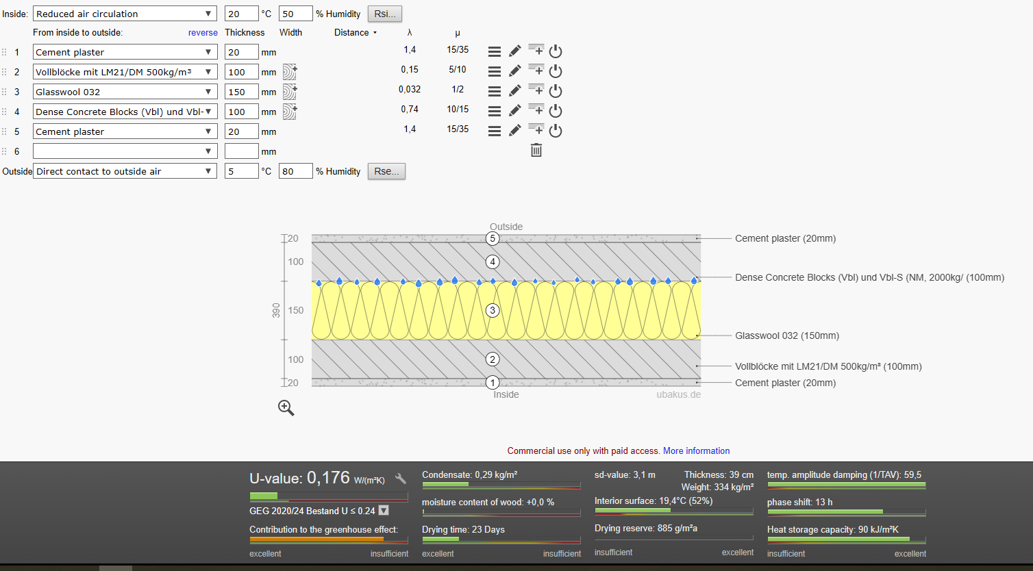

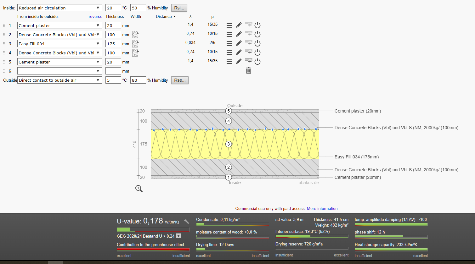

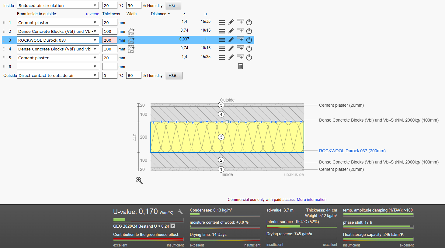

Ben1984 Posted April 26, 2025 Posted April 26, 2025 6 minutes ago, Conor said: Just have a wider cavity. Yeah, this is an option I am considering. But even if I go with a 200mm cavity it still makes sense to use a thermally efficient block for the inner skin if it can take the S&C render without cracking

Iceverge Posted April 26, 2025 Posted April 26, 2025 24 minutes ago, Ben1984 said: still makes sense to use a thermally efficient block for the inner Have you done the calculations on it? I suggest you do to get a feeling of how little a difference thermolites make. I wouldn't use them. To cracky and brittle and expensive. There's airtightness and then there's airtightness. Ok might be the best you can do with dot and dab if you're careful but wet plaster is the way forward if you want a really tight house. We got well below passive requirements on ours.
Ben1984 Posted April 27, 2025 Posted April 27, 2025 10 hours ago, Iceverge said: Have you done the calculations on it? I suggest you do to get a feeling of how little a difference thermolites make. I wouldn't use them. To cracky and brittle and expensive. There's airtightness and then there's airtightness. Ok might be the best you can do with dot and dab if you're careful but wet plaster is the way forward if you want a really tight house. We got well below passive requirements on ours. Yeah, I've run some calcuations (using some of the online calculators): based on a rendered block outter skin, 150mm cavity filled with mineral wool you would need to use a thermalite block on the inner skin to hit 0.18 u value. I suppose my question is really this: Can I hit 0.18 with a rendered 100mm block outter skin, 150mm mineral wool cavity and a wet plaster finish internally? Is there a block that I can use on the inner skin that is thermally efficient enough to hit 0.18 without causing me loads of issues with cracking? My current thinking is that it can't be done. I would either have to use a thermolite type block to hit the 0.18 which would then be a nightmare to plaster onto or I could use a concrete block on the the inner skin but increase the cavity to 200mm to hit < 0.18. I would prefer to keep a 150mm cavity but not sure this can be achived given my desire for a wet plaster finish internally.

torre Posted April 27, 2025 Posted April 27, 2025 2 hours ago, Ben1984 said: hit 0.18 u value I dislike Thermalites too. If it helps, for a new build the limiting value is actually only 0.26 (table 4.1 of Part L) which gives you flexibility to use a different block, as long as you make adjustments to improve efficiency elsewhere - it may be easy to add 10-20mm of PIR to your roof or floor, say, to achieve the same SAP score.
Ben1984 Posted April 27, 2025 Posted April 27, 2025 10 minutes ago, torre said: I dislike Thermalites too. If it helps, for a new build the limiting value is actually only 0.26 (table 4.1 of Part L) which gives you flexibility to use a different block, as long as you make adjustments to improve efficiency elsewhere - it may be easy to add 10-20mm of PIR to your roof or floor, say, to achieve the same SAP score. Thanks, this is excatly the kind of advice I was hoping for! I was already planning to add extra PIR to the floor so it sounds like I can have the wall makeup I want (150mm cavity and get rid of thermalites) without having to make any further adjustments.
JohnMo Posted April 27, 2025 Posted April 27, 2025 8 minutes ago, Ben1984 said: Thanks, this is excatly the kind of advice I was hoping for! I was already planning to add extra PIR to the floor so it sounds like I can have the wall makeup I want (150mm cavity and get rid of thermalites) without having to make any further adjustments. But before running away think job done and I'll take the easy way out, note what table 4.1 actually says NOTE: To meet the target fabric energy efficiency rate set out in Section 1, the energy efficiency of some elements will need to be significantly better than the limiting standards in Table 4.1. So it's an average, lots of walls at 0.26 means roof and floor have to loads better than min standard. So you may need to get to below 0.1 on floor and roof to compensate, based on what windows you have and area. There isn't really that much wiggle room. Base U value rates are for building regs section 1 in England are... External walls U = 0.18 W/(m²·K) Party walls U = 0 Floors U = 0.13 W/(m²·K) Roofs U = 0.11 W/(m²·K) etc... I really wouldn't compromise on U values or airtightness, it will cost you every heating day there after, plus you will have way more heating days as well.
Iceverge Posted April 27, 2025 Posted April 27, 2025 There's an option with the lightweight blocks on the inner leaf. I'm not sure of prices in the UK but in ireland they're three times the price about, €20 more per m2. If you were to use the below 200mm config you could easily drop from batts of 0.032W/m2K to 0.037 which are much much cheaper. Knauf cavity 032 Batts at 150mm are £22.58/m2 and 036 batts at 200mm are £16.38 . About £6/m2 less. https://www.insulationshop.co/150mm_knauf_dritherm_32_ultimate_cavity_slab.html?srsltid=AfmBOooJlH4JJCo9Jukz208_v9VOXP0dZLtipM00uCQZqYL56HiU5rk3 https://www.insulationshop.co/100mm_dritherm_cavity_slab_37_standard_knauf.html Add in a slight difference for longer stainless steel cavity ties and you're still £20 per m2 better off going for the wider cavity. That could be easily £5k for a house.
Ben1984 Posted April 27, 2025 Posted April 27, 2025 9 minutes ago, JohnMo said: But before running away think job done and I'll take the easy way out, note what table 4.1 actually says NOTE: To meet the target fabric energy efficiency rate set out in Section 1, the energy efficiency of some elements will need to be significantly better than the limiting standards in Table 4.1. So it's an average, lots of walls at 0.26 means roof and floor have to loads better than min standard. So you may need to get to below 0.1 on floor and roof to compensate, based on what windows you have and area. There isn't really that much wiggle room. Base U value rates are for building regs section 1 in England are... External walls U = 0.18 W/(m²·K) Party walls U = 0 Floors U = 0.13 W/(m²·K) Roofs U = 0.11 W/(m²·K) etc... I really wouldn't compromise on U values or airtightness, it will cost you every heating day there after, plus you will have way more heating days as well. Thanks John. I am not looking to comprimise much on the u-value of the walls. I could achieve 0.18 if I used thermalite type blocks on the inner skin, but I don't like thermalites generally and certainly not keen on the idea of plastering directly onto them. Swapping thermalites to medium density concrete blocks would increase the u-value of the wall by 0.01, I can't imagine this will make a significant difference to my heating bills. However this was a problem when I was, incorrectly, under the assumption I had to achieve 0.18 on the walls. I still might opt for a 200mm cavity for the increased u-value, but it's helpful to know that it's possible to achieve the wall make up I want with a 150mm cavity.
JohnMo Posted April 27, 2025 Posted April 27, 2025 11 minutes ago, Ben1984 said: 200mm cavity Then bonded poly beads fully filled?
Ben1984 Posted April 27, 2025 Posted April 27, 2025 8 minutes ago, Iceverge said: There's an option with the lightweight blocks on the inner leaf. I'm not sure of prices in the UK but in ireland they're three times the price about, €20 more per m2. If you were to use the below 200mm config you could easily drop from batts of 0.032W/m2K to 0.037 which are much much cheaper. Knauf cavity 032 Batts at 150mm are £22.58/m2 and 036 batts at 200mm are £16.38 . About £6/m2 less. https://www.insulationshop.co/150mm_knauf_dritherm_32_ultimate_cavity_slab.html?srsltid=AfmBOooJlH4JJCo9Jukz208_v9VOXP0dZLtipM00uCQZqYL56HiU5rk3 https://www.insulationshop.co/100mm_dritherm_cavity_slab_37_standard_knauf.html Add in a slight difference for longer stainless steel cavity ties and you're still £20 per m2 better off going for the wider cavity. That could be easily £5k for a house. Thanks, another really helpful response. What software/calculator have you used to produce this? It appears to be vastly superior to what I have been trying to use. I have the space to accomodate a 200mm cavity, I was reluctant to go down this route initally because of the increased costs. Your post suggests that a 200mm cavity could, infact, be more cost efficient that a 150mm. I will need to look into this in more detail.
Ben1984 Posted April 27, 2025 Posted April 27, 2025 2 minutes ago, JohnMo said: Then bonded poly beads fully filled? Possibly! I had, until this morning, been looking at ways of making a 150mm mineral wool cavity work. Based on the responses i've recevied so far I am now inclined to favor a 200mm cavity. I don't know enough about the bonded poly beads to compare them with mineral wool in a 200mm cavity. I will need to look into this.
