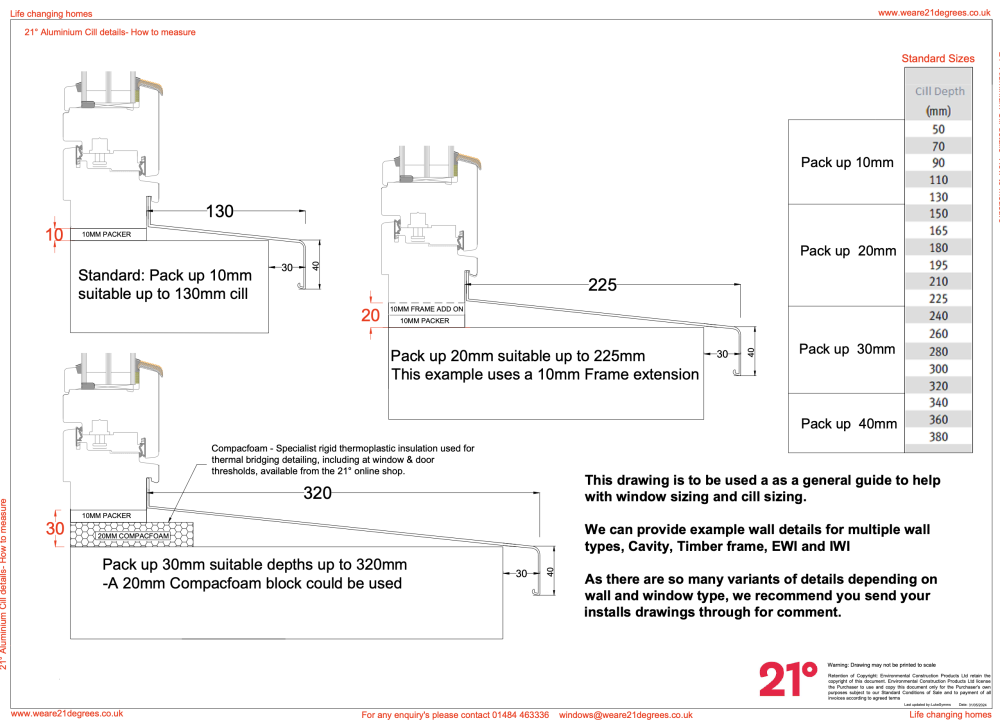

we're not as yet in contract but we will almost certainly be using Nordica - who use Viking and Slowinscy. We have decided on the latter. Transparency with regard to the manufacturter / actual product* They will be providing a deeper base to window to ensure adequate fall on extended sill.  Extract from their proposals:
1* Frame packer 30x105mm (A30*105_40_M)
Length 700 mm, color: Lacquer
Regarding fall on sill there's nothing in building regs!   Which are supposedly there to protect us - there is lots of good stuff in there, don't get me wrong, but there is lots of daft stuff (some ridiculous) in there too as we all know.  But there are simple things missing too which is just as daft!  Whilst talking to numerous people/companies i discovered not unusual for extended sills to end up flat / almost flat. Which in theory complies with regs - because there isn't one!  Wouldn't suprise me if some end up running backwards perhaps!!

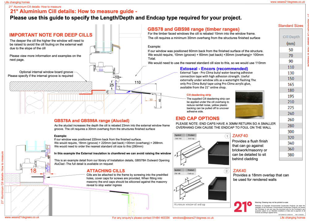

moving on from the supply chain does anyone have a detail please for the reveals externally?  We have flat boards with windows set back midspan of insulation and doors futher back on the structural stud with compacfoam at base. Battens and timber cladding to outside. Windows and doors fixed back to internal 140mm structural studs and sealed direct to boards - or am i missing something here? should they be lined first with membrane???  I don't think so but seems to a detail thats top secret!   Timber frame company leaving openings covered by membrane to avoid ingress of rain whilst waiting for windows, so this won't be opened up until window fitters ready.  Windows and doors will be fully sealed with air tight and precompressed tape etc.  But doing some serious head scratching here how the connection is made at the outside to avoid moisture ingress into boards.  Or am I overthinking it?  Timber frame company / window installer all saying 'by others' - need to get this right!  Also now thinking is there any risk of condensation under extended sills?
extract of drawing and image example of intent herewith..............
any thoughts appreciated please.............kr   ....mextract ref pro passiv to reveals.pdf

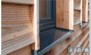

Aluminium cills as above are available with push end caps but there’s not any suppliers in the UK that I’m aware of that make them.
If you need any help with cills let me know.
