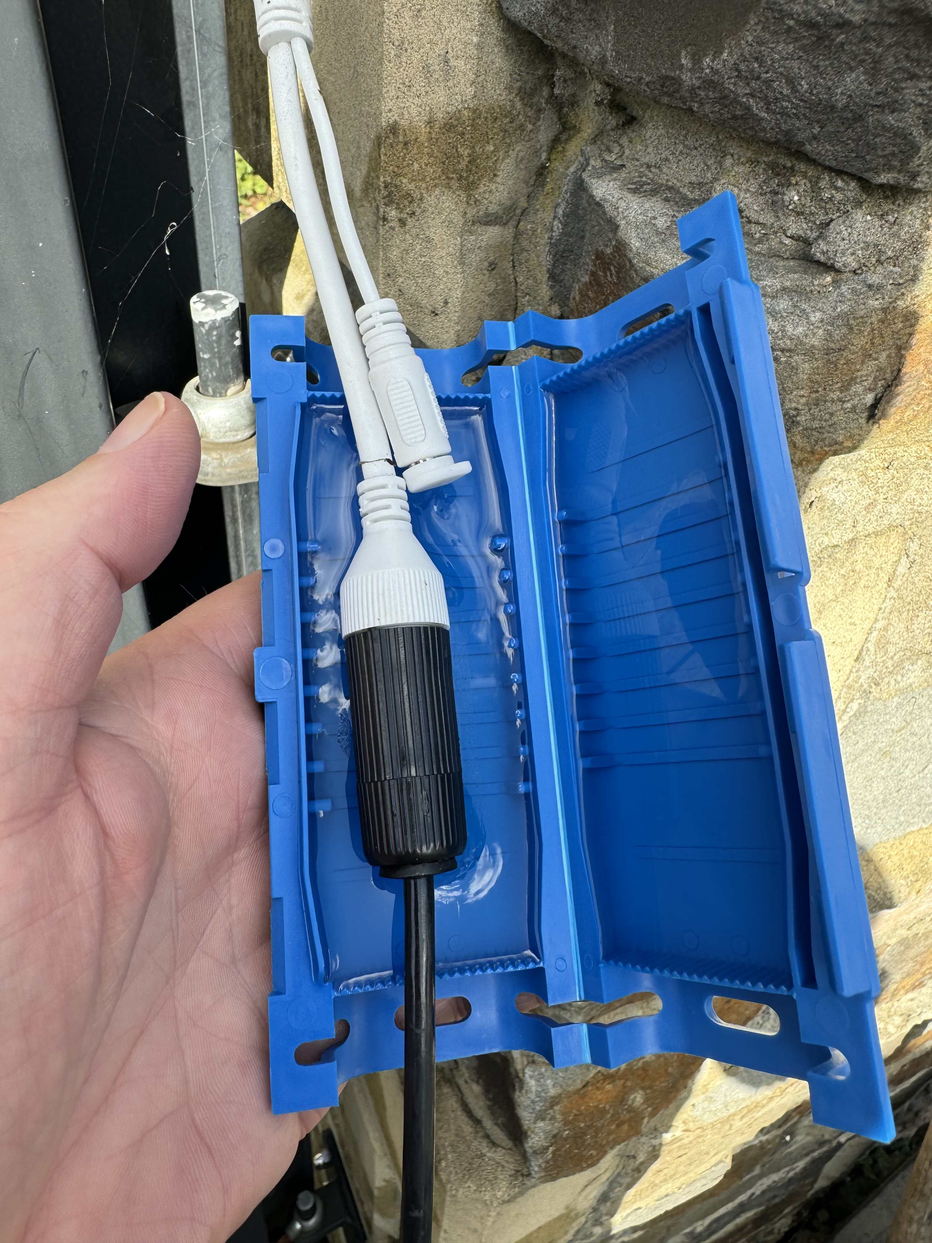

Pocster Posted October 10 Author Share Posted October 10 Ordered a wago gel box ( 20 quid ffs ! ) . Only one that seemed large enough . Will report back . Link to comment Share on other sites More sharing options...

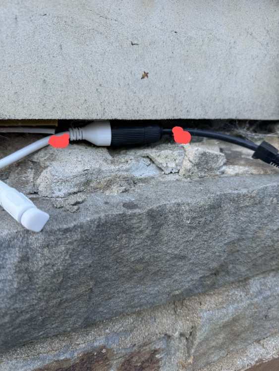

Onoff Posted October 10 Share Posted October 10 Pay attention to the rear entry points marked red. You can easily get moisture in them through capillary action. You'll probably be good with just the ACF-50 for a couple of years but a smear of silicone grease never goes amiss. https://www.amazon.co.uk/servisol-AV-701-143UK-Silicone-Grease-50-White/dp/B0058223PU/ref=asc_df_B0058223PU/? Deffo wrap the whole lot in amalgamating tape past those red marked bits. Link to comment Share on other sites More sharing options...
Pocster Posted October 10 Author Share Posted October 10 45 minutes ago, Onoff said: Pay attention to the rear entry points marked red. You can easily get moisture in them through capillary action. You'll probably be good with just the ACF-50 for a couple of years but a smear of silicone grease never goes amiss. https://www.amazon.co.uk/servisol-AV-701-143UK-Silicone-Grease-50-White/dp/B0058223PU/ref=asc_df_B0058223PU/? Deffo wrap the whole lot in amalgamating tape past those red marked bits. The white one is a moulded plug I.e part of the camera . Other side is a potential issue . I’m going to remove the joining sleeve and just put male and female together in gel box . Link to comment Share on other sites More sharing options...

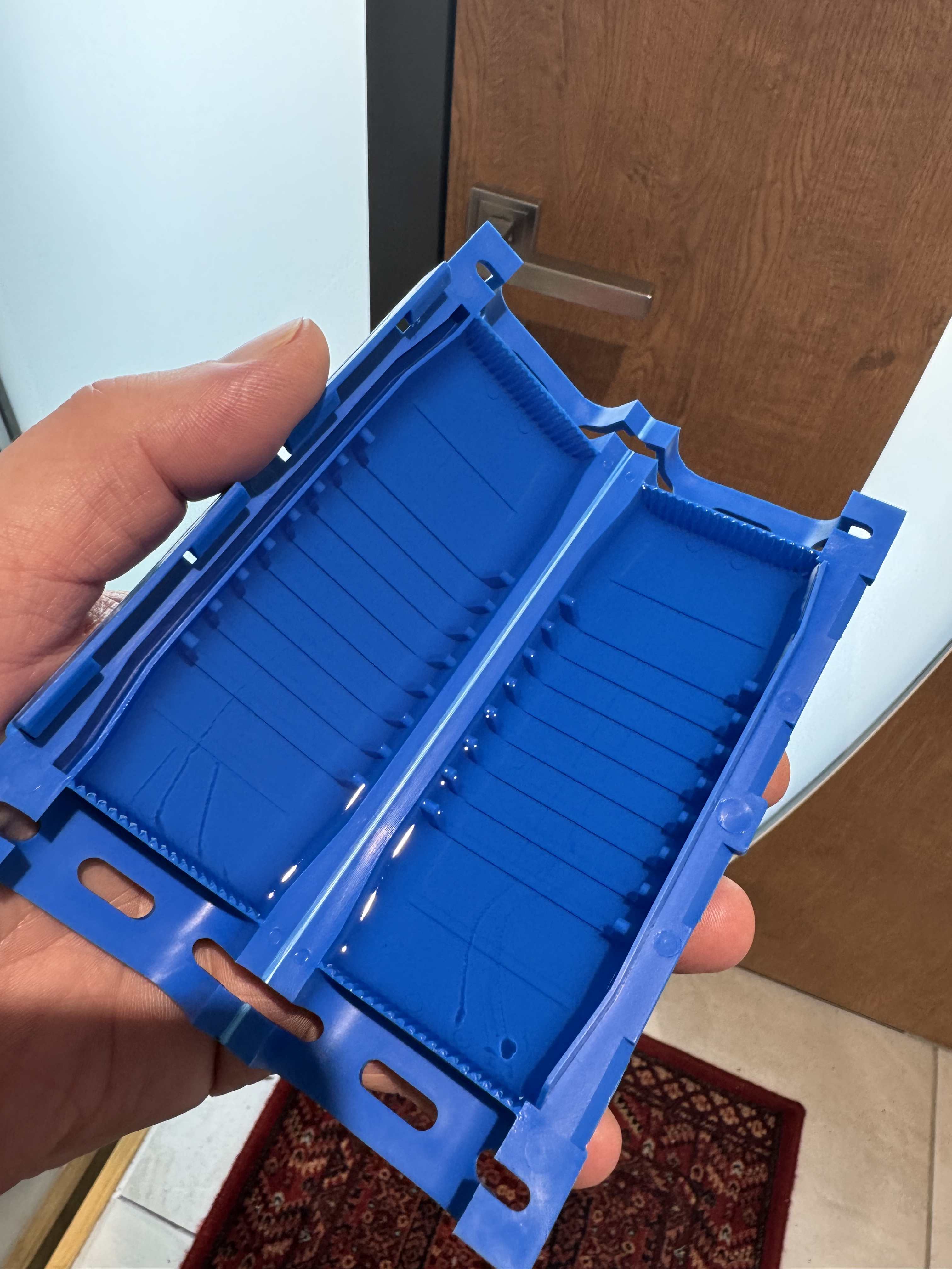

Pocster Posted 17 hours ago Author Share Posted 17 hours ago Struggled to find a gel box the right dimensions for what I needed . Didn’t fancy buying a suitable box and gel … So , tight fit but seems good Link to comment Share on other sites More sharing options...
