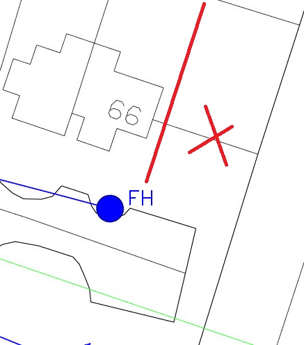

mike2016 Posted November 8, 2017 Author Share Posted November 8, 2017 Thanks - I have to realign the driveway anyway to maximize the plot size and dig a trench to access the fibre broadband which sweeps through the front garden. I could get this done in advance for sure. Sewage and storm drainage is at the back of the site and easily accessed from my site during building works later. The service maps place Water (Blue line on map) & Electricity (Red Line on Map) on the road. Is it possible to hook those up in advance? I wouldn't have thought so. I hope the Fire Hydrant can be moved? I'm guessing you mean to finish any work that needs to take place directly on the property I'm selling (No. 66 below ) and manage the later trench out on the road during build with a steel cover while services are being hooked up? Does that sound plausible? Thanks as always! Link to comment Share on other sites More sharing options...

ProDave Posted November 8, 2017 Share Posted November 8, 2017 Yes I was meaning get all works in or under No 66 complete before you sell it. I don't see the Fire Hydrant as an issue. My Sister's house has a fire hydrant set into the pavement right in front of the dropped kerb to her driveway. I assume you are creating a parking space in front of No 66 so any adjustment the the hydrant cover could be done then. Water can be connected to the site just to a stand pipe, then routed into the house later. Likewise electricity can be connected. You can either get a "building supply" and have a meter and consumer unit in a temporary box on the site boundary, then have the supply moved into the house when ready. Or you can do as some of us have and make the meter box on the boundary a permanent fixture to avoid moving it later. At least if you get all the connections done before you sell then the buyer knows there is a bit less disruption to expect. It should be pretty obvious where the new house is going in that situation with or without footings to show it. Link to comment Share on other sites More sharing options...
