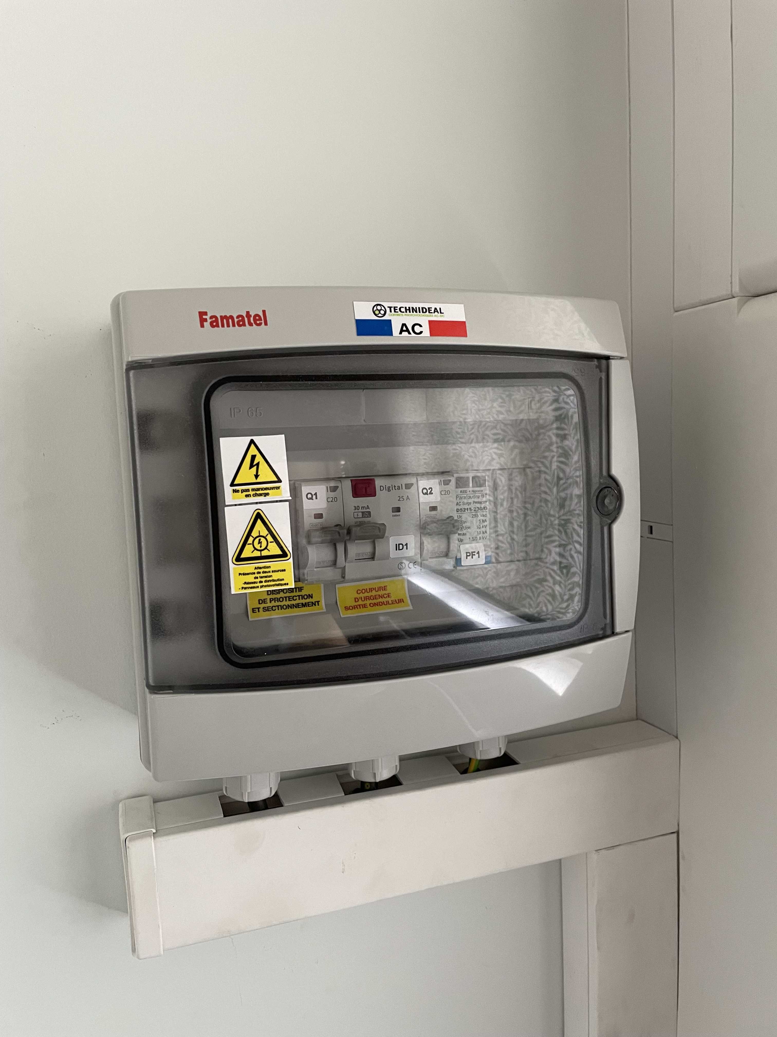

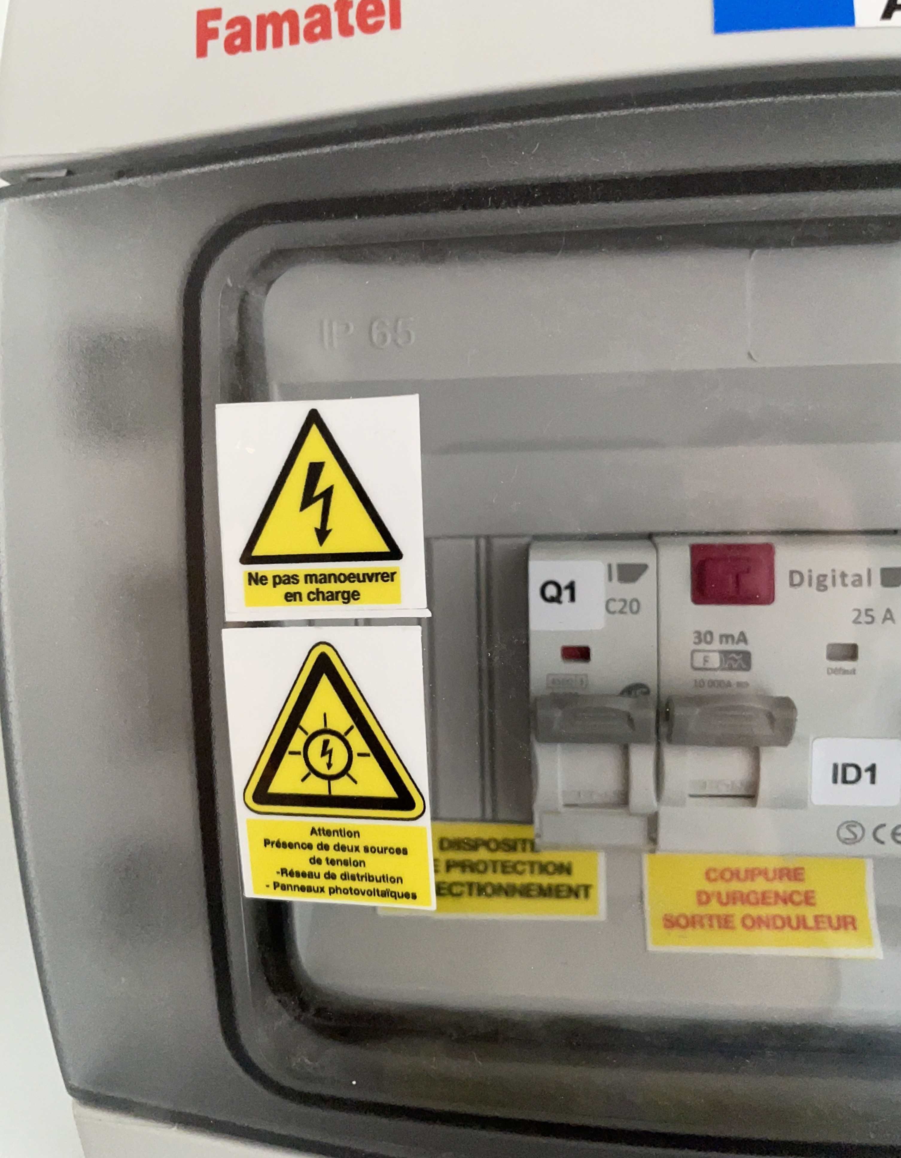

ProDave Posted yesterday at 21:28 Share Posted yesterday at 21:28 Can you post pictures of exactly what you have inside, i.e. inverter and any switchgear and what is connected already and more importantly what is NOT connected? It sounds like you have a very different way of connecting and metering to us in the UK and until we understand how it is connected we can't advise much. It might be as simple as it is already connected but you are awaiting a separate export meter to be installed to enable payments of exported power. Link to comment Share on other sites More sharing options...

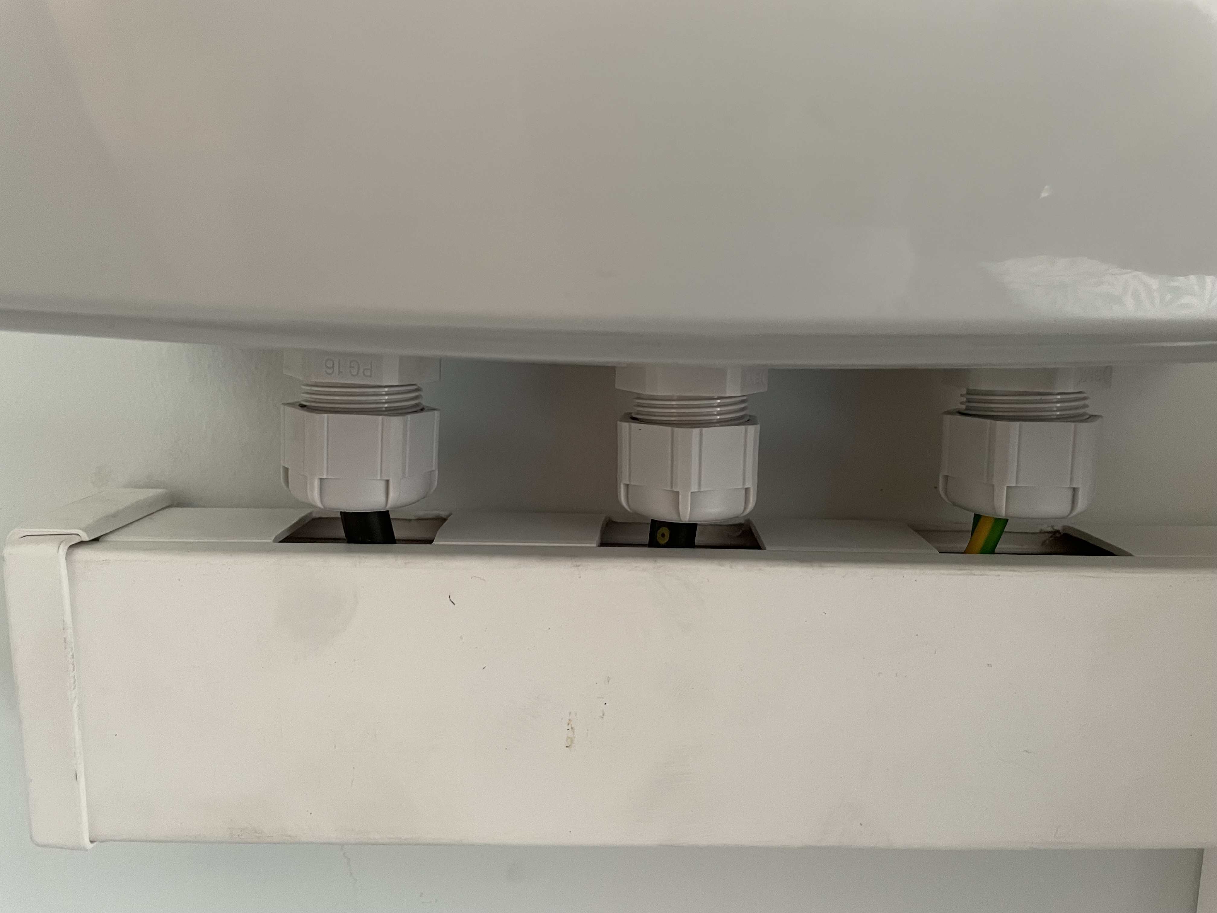

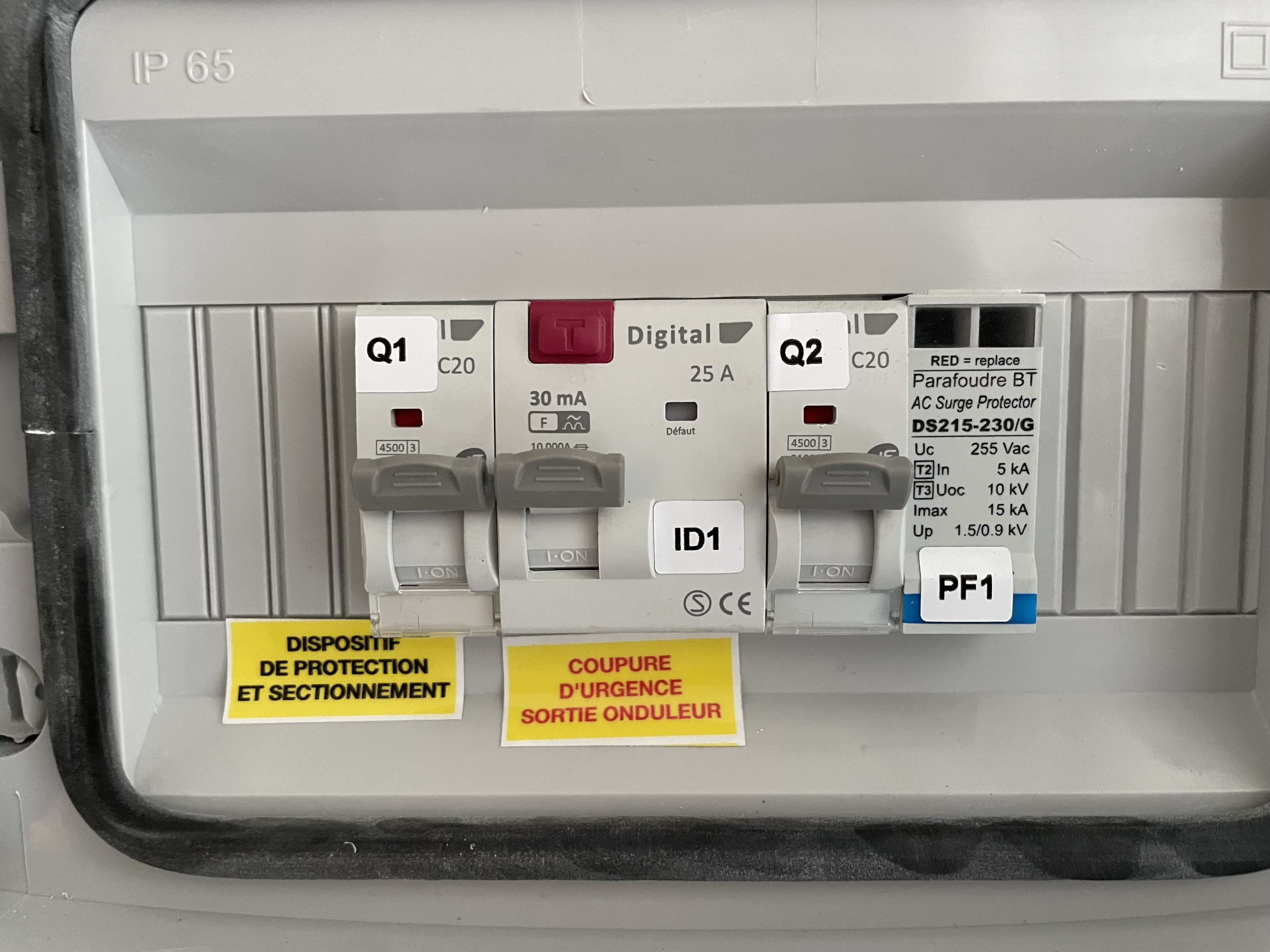

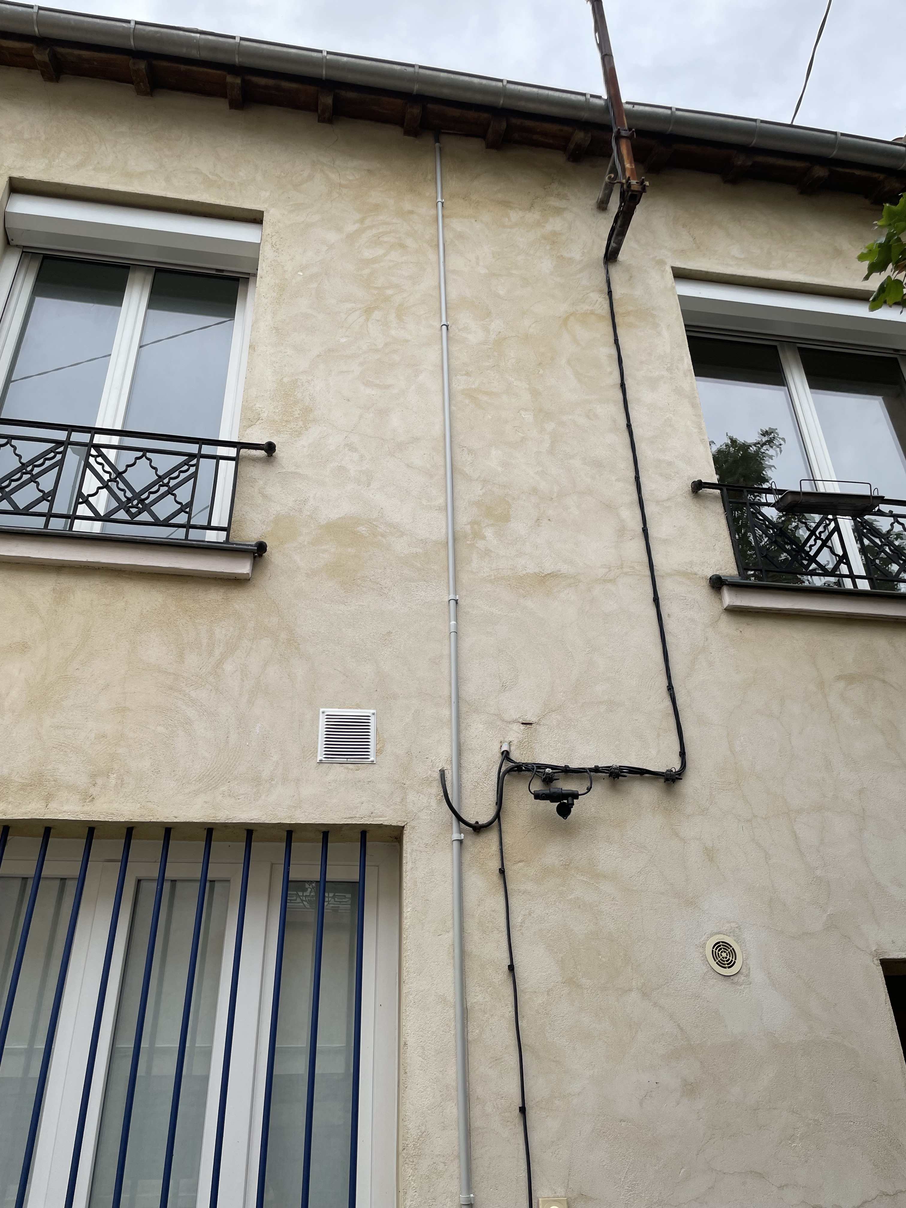

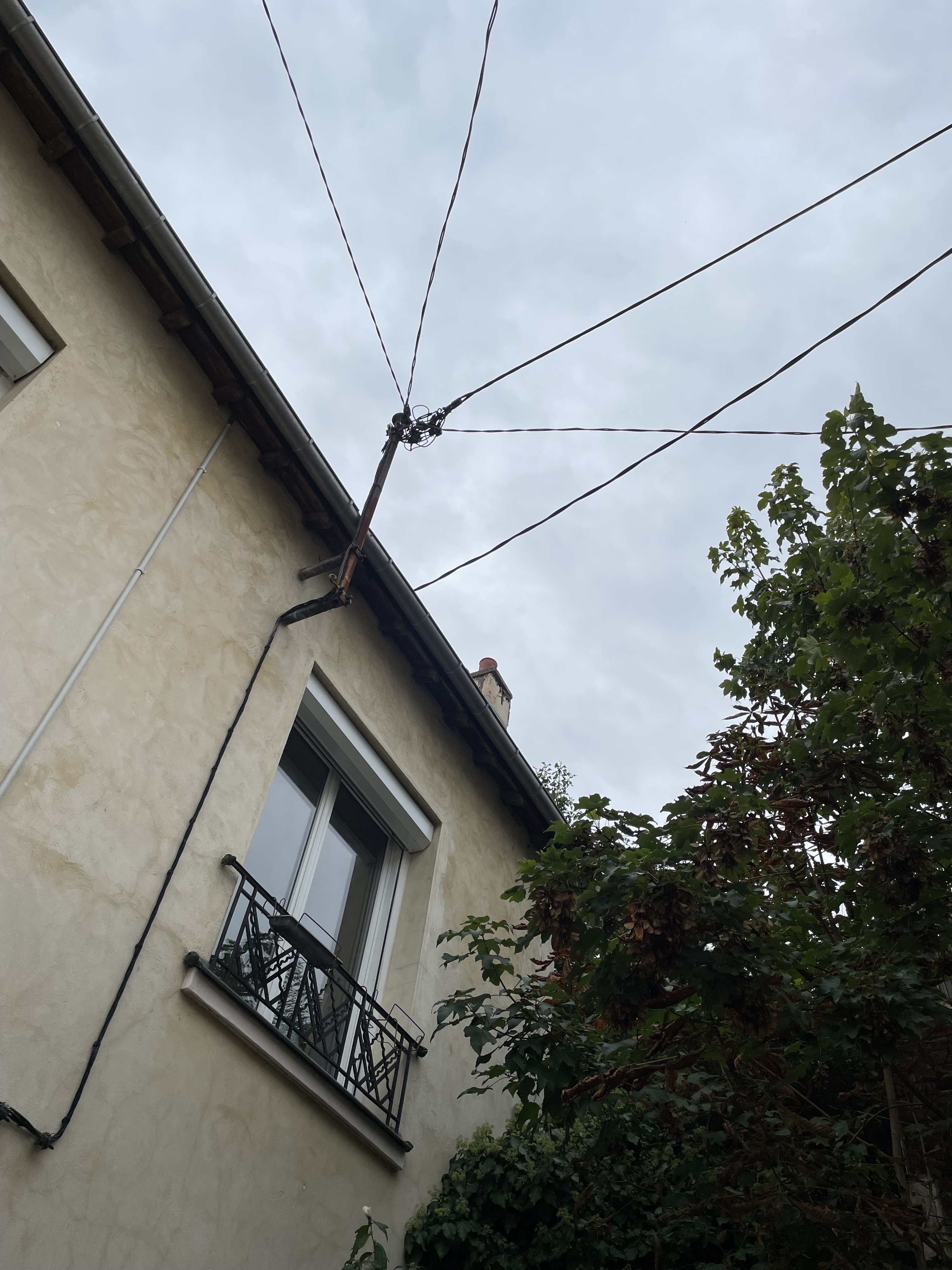

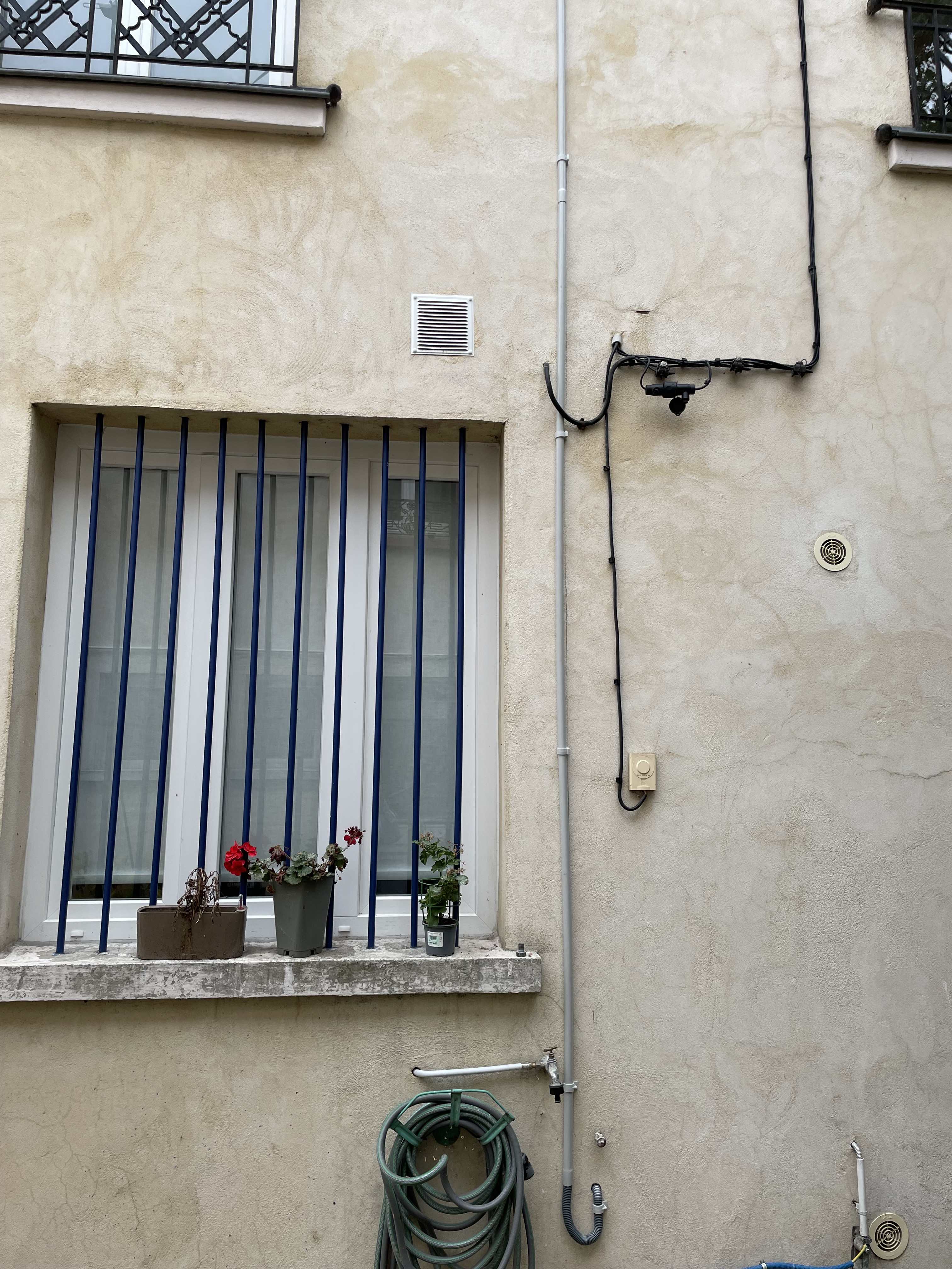

Garald Posted 12 hours ago Author Share Posted 12 hours ago Sorry if I came off as rude - certainly not my intention! Here are some pictures. The cables from the new electrical board inside to the panels on the roof are contained in the grey tube you see on the outside, parallel to the black cables that connect the house to the grid (and to my neighbours‘ building, in a bizarre aerial installation). Link to comment Share on other sites More sharing options...
Garald Posted 11 hours ago Author Share Posted 11 hours ago (edited) More pictures. Edited 11 hours ago by Garald Link to comment Share on other sites More sharing options...

ProDave Posted 11 hours ago Share Posted 11 hours ago 52 minutes ago, Garald said: Can you post pictures of all the other bits that connect to that white plastic trunking? there should be an inverter and some switches and possibly meters and things. I enjoy your posts here, please don't stop, it is interesting to see how other countries do things, the only frustration is we don't know the regulations in France so can't make much comment on what is correct from a French regulation point of view. Link to comment Share on other sites More sharing options...
Garald Posted 9 hours ago Author Share Posted 9 hours ago Here are some more pictures. Is this enough? This panel is next to the main panel (and connected to it). Not sure I can show much more without wrecking things. Link to comment Share on other sites More sharing options...

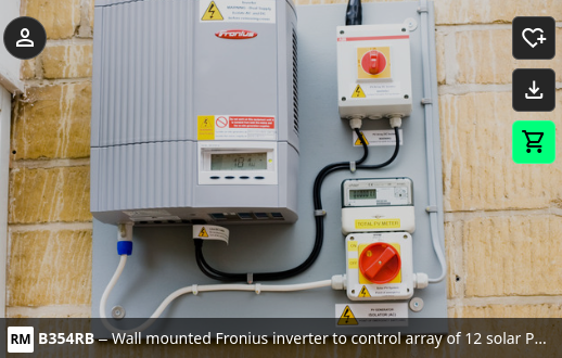

ProDave Posted 8 hours ago Share Posted 8 hours ago No I mean zoomed out other bits of equipment not more details of the ones you have show. Somewhere there should be an inverter, here is one as a random picture to give you an idea what it might look like It may not even be in the same room, but I would have thought it likely to connect to that run of white trunking running down the wall from the consumer unit you already posted. Link to comment Share on other sites More sharing options...
SteamyTea Posted 7 hours ago Share Posted 7 hours ago 15 minutes ago, ProDave said: Somewhere there should be an inverter May be micro inverters on the back of the modules. Link to comment Share on other sites More sharing options...
Dillsue Posted 6 hours ago Share Posted 6 hours ago 42 minutes ago, SteamyTea said: May be micro inverters on the back of the modules. Fair chance. Grey conduit from roof is AC from micro inverters to surge protection then to Q2. Connection to main consumer unit is via RCD and Q1??? 2 cables and earth in the cable glands. All switched on so maybe already running or needs MCB in main consumer unit switching on?? Could be something completely different but micro inverters would work with what's been shown so far. Link to comment Share on other sites More sharing options...

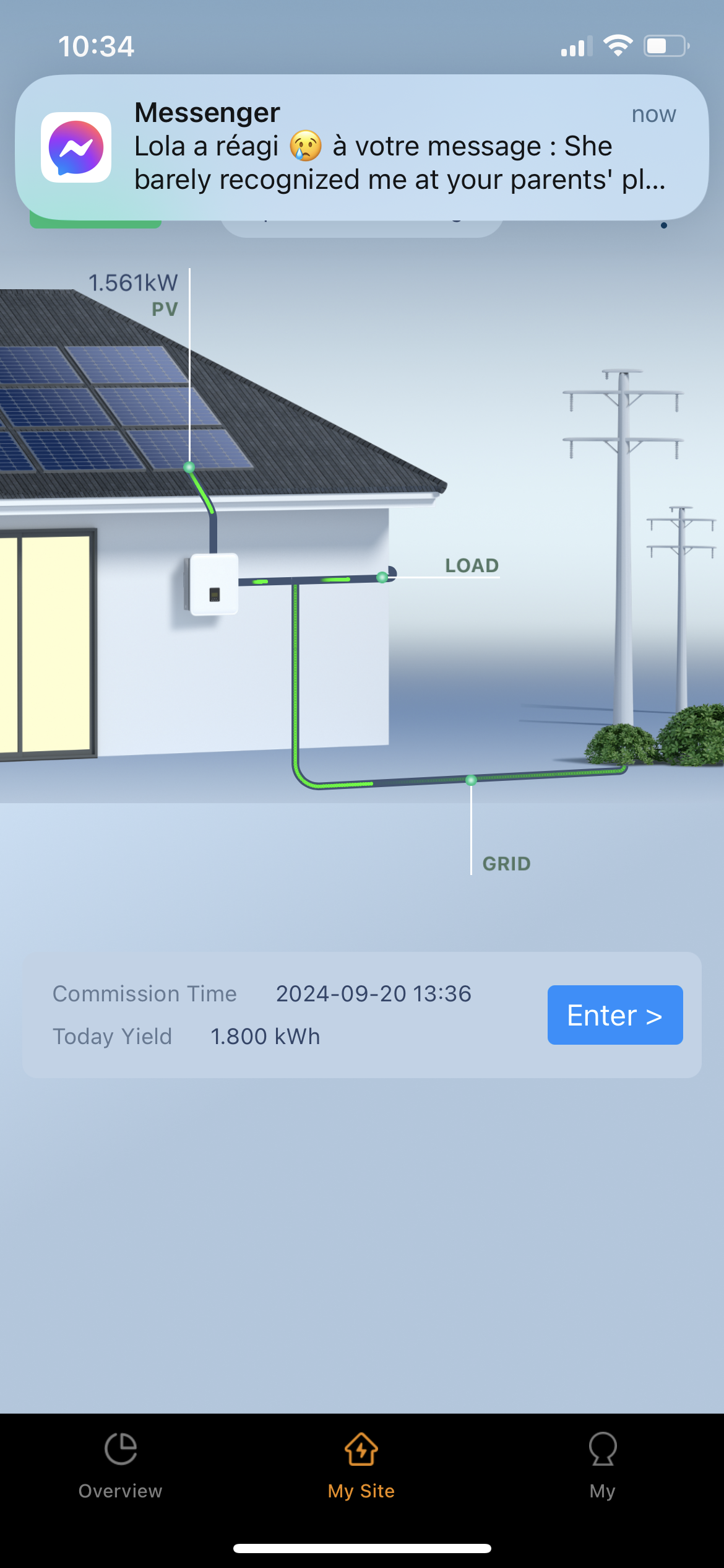

Garald Posted 5 hours ago Author Share Posted 5 hours ago (edited) I take “micro-onduleurs” means the same as “micro-inverters”? See page 5 in the attached file. An app on my phone shows me how much the panels are producing, but it doesn’t yet show how much I am using. devis_DEV-28851_28851.pdf Edited 5 hours ago by Garald Link to comment Share on other sites More sharing options...
Dillsue Posted 4 hours ago Share Posted 4 hours ago Google translate says 3 " MICRO-ONDULEURS THALEOS TRANSFORMER 2 "are micro inverters. If the app shows the panels generating then youre up and running. Anything you generate will be used to power your house and if there's anything you don't use it'll likely go the grid to power your neighbours 1 Link to comment Share on other sites More sharing options...
