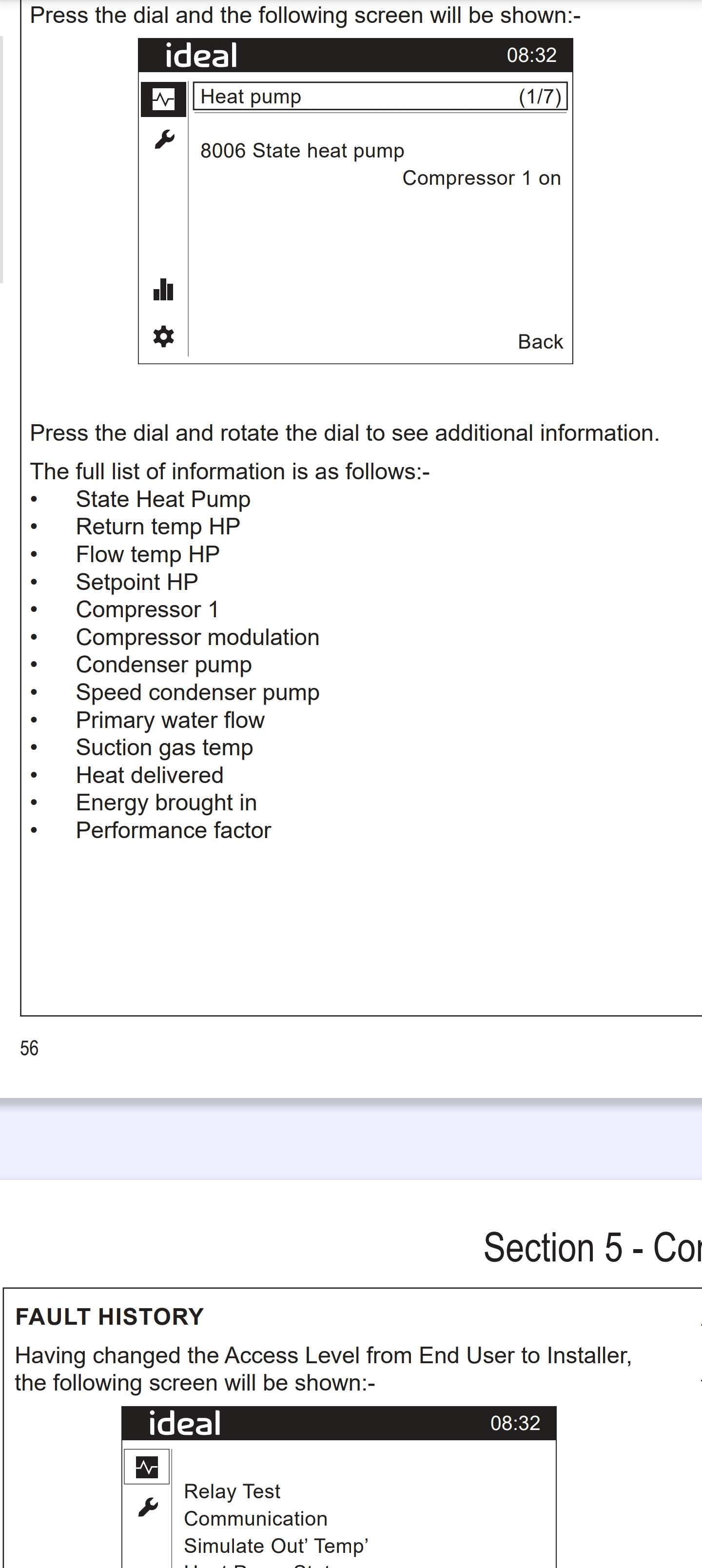

Dam0 Posted September 15, 2024 Author Share Posted September 15, 2024 5 hours ago, JamesPa said: What ashp do you have. Openenergymonitor and home assistant are both free software, any cost is the interface to the system which depends on the system you have. Several native controllers give basic stats Its an ideal logic air ashp. Plus a matching UVC and controller. Do you know if any of the monitoring software will work with this system? Thanks Thanks for the reccomndations. I love the idea of the level 3 monitoring but realistically I only need the basics. Link to comment Share on other sites More sharing options...

JohnMo Posted September 16, 2024 Share Posted September 16, 2024 15 hours ago, Dam0 said: ideal logic air ashp A quick look you get everything you need out the box. Last 3 items on the list Link to comment Share on other sites More sharing options...
Dam0 Posted September 17, 2024 Author Share Posted September 17, 2024 On 16/09/2024 at 09:19, JohnMo said: A quick look you get everything you need out the box. Last 3 items on the list Incredible work. Thanks for taking the time to help. Link to comment Share on other sites More sharing options...
