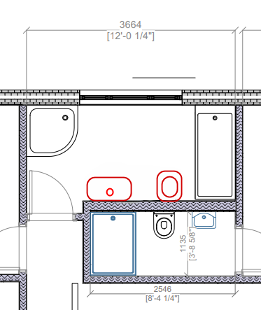

Rick734 Posted September 11, 2024 Share Posted September 11, 2024 Hello guys, New here so TIA for any help received. Hoping @Nickfromwales can comment on this one, from what I've seen of previous threads as a lurker. So in my house refurb project I have decent size bedroom that I've turned into a bathroom and ensuite. Not massive but big enough. Not sure if the bathroom shower is going to be a bit too much but we'll see. The issue I have is that the sensible layout for both rooms will have the two wall-hung WC frames back-to-back behind each other - slightly offset, but the majority of the frames will be literally back-to-back. I've partially built the wall in 145x45 timber to provide some solidity for the frames and some extra depth - I figured I could get away with a couple of slimline frames plus boarding off one side of the wall in 25mm OSB/ply underneath the tile backer board to give me 20-25mm extra depth. However just trying to figure out if I will be able to fix the frames securely enough, given that one of the top main bolts won't be able to be fixed, as it will be behind the other frame. Obviously I can stick the frame in place, fix sideways and upwards through timbers, etc - will that be enough? I could potentially drill some holes through the top of the frame and bolt them together to share the load (hopefully they're both in use at the same time to balance it out 😆)Hope that makes sense... The wastes are a different story...we'll come onto that shortly... Link to comment Share on other sites More sharing options...

Rick734 Posted September 11, 2024 Author Share Posted September 11, 2024 Thanks Onoff - I've already built quite a bit of the wall... so don't want to redo unless I really have to. Originally used 145 as I didn't want to add too much weight or bulk to the whole wall, as I've only just got enough depth in each of the rooms anyway (and I didn't give the plumbing enough thought :)). Figured that if I just boarded off to get the extra depth it might give me more flexibility later (e.g. I could sink the end of the bath into the wall by just trimming the board around it....) But also still need to sort the problem of not having a brace or stud behind one end of the WC frames... Link to comment Share on other sites More sharing options...
Rick734 Posted September 11, 2024 Author Share Posted September 11, 2024 And this is my plan for the waste, unless anyone has a better idea... The wall has to be positioned where it is due to the minimum sizes wanted in each room, so I figure this is the only way I can get both wastes into the main soil pipe. Obviously the two wastes from the WCs are offset, so one is behind the other in the image shown. Not ideal using a flexi but I don't think anything else is going to work for that type of bend - down, turn under the opposite WC frame and then down again into the main soil. Is that workable? Link to comment Share on other sites More sharing options...

Mike Posted September 11, 2024 Share Posted September 11, 2024 4 hours ago, Rick734 said: I don't think anything else is going to work for that type of bend - down, turn under the opposite WC frame and then down again into the main soil. Geberit make connectors for back-to-back WCs - https://catalog.geberit-global.com/en-NT/systems/CH3_102113/products. I guess others probably do too. Link to comment Share on other sites More sharing options...

Rick734 Posted September 11, 2024 Author Share Posted September 11, 2024 1 hour ago, Mike said: Geberit make connectors for back-to-back WCs - https://catalog.geberit-global.com/en-NT/systems/CH3_102113/products. I guess others probably do too. thanks Mike - not sure there's anything short enough for what I need though... Link to comment Share on other sites More sharing options...
