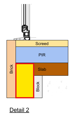

SBMS Posted September 2, 2024 Posted September 2, 2024 I think this might have been done to death, very often with no good conclusions, but we've got a significant amount of door thresholds on our ground floor (quite a bit of glazing). I'm trying to solution the different options and have summarised three possible details (traditional brick and block with a 200mm cavity - blown EPS beads, not that that matters). Can anyone comment on whether any of these options are not recommended, or whether the additional effort/cost, say, of running marmox or compacfoam (Detail 3) outweighs the potential heat losses from thermal bridging? Does option 2 work (with the doors effectively bearing onto PIR and screed)? This is to allow bottom fixing and support for a 160mm triple track slider system, and also sitting into the cavity as much as possible.

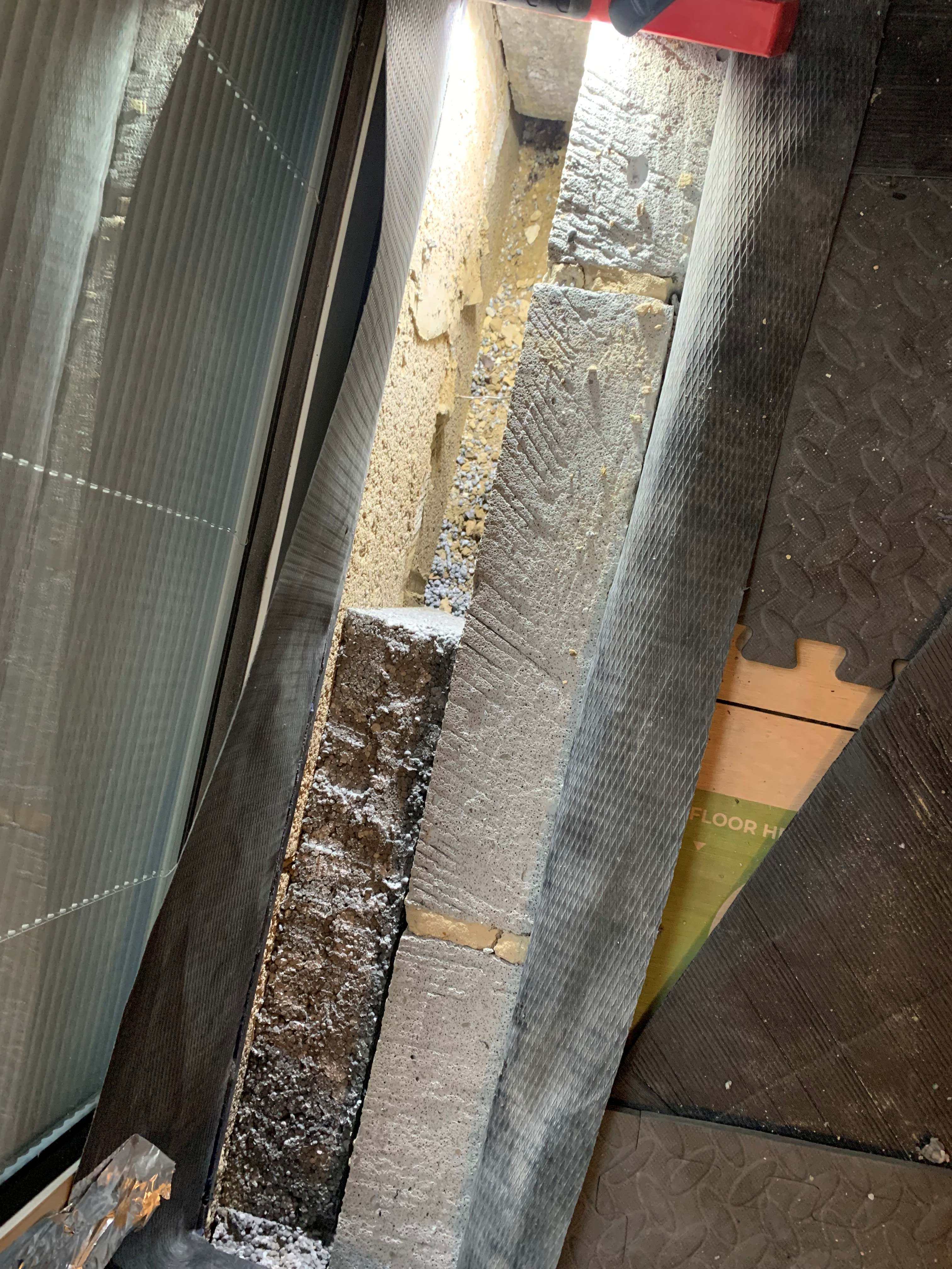

nod Posted September 2, 2024 Posted September 2, 2024 Detail 2 you need to break the block away and take the membrane and insulation right up to the outer skin To avoid cold spots Have a look at previous posts I put quite a few pics up showing this
SBMS Posted September 2, 2024 Author Posted September 2, 2024 (edited) 3 minutes ago, nod said: Detail 2 you need to break the block away and take the membrane and insulation right up to the outer skin To avoid cold spots Have a look at previous posts I put quite a few pics up showing this Is this sufficient support for 9m of aluminium triple glazed sliding doors to sit on? The PIR/Screed won't cause undue deflection? Also, if building from scratch, can you not just finish the inner block at that height, rather than breaking it away? Edited September 2, 2024 by SBMS

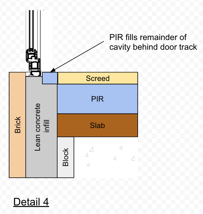

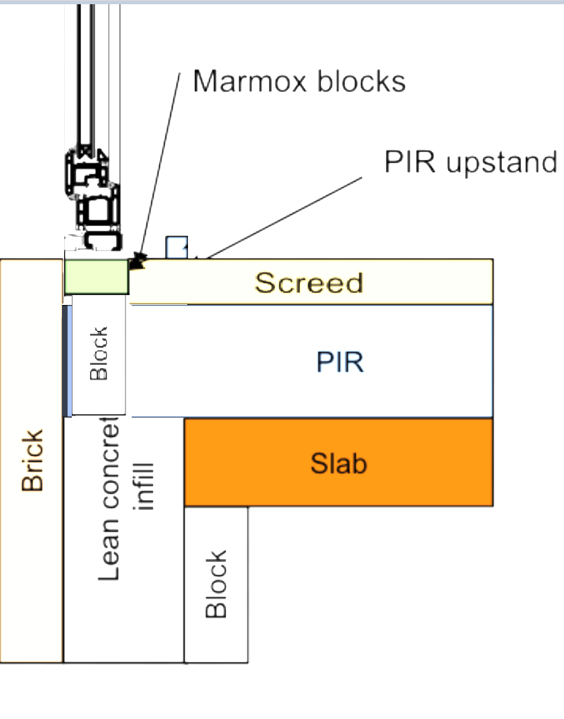

SBMS Posted September 3, 2024 Author Posted September 3, 2024 29 minutes ago, Andehh said: With the above in mind, I'd prob do detailing 3 but then aerogel as a thermal break against the block to the screed? Fix it in place prior to screeding so it is sandwiched. We also have a flush threshold - so our track is sitting so its flush with FFL/screed level (adjusted diagram below). You've got me thinking.. Is the majority of the thermal bridging from the 'back' of the door track, and would the following detail - which is a variation of detail 1, help reduce that bridging - effectively reduce the cavity to the known bearing width of the door track and then do detail 1 with a PIR upstand adjacent to the screed: I don't know where the majority of the bridging would occur.. obviously the track would still suck up heat from the concrete, but would transmission be limited with the PIR behind??
Dave Jones Posted September 3, 2024 Posted September 3, 2024 if you want a level threshold, which you probably do. to thermal break it marmox directly under the cil same level as screed. Dont fill behind it with foam or any other non load bearing material as this is your finished floor surface. You are extending your internal floor to the outside skin and at same time breaking the thermal bridge with the PIR under the screed and the marmox block at screed level. 1

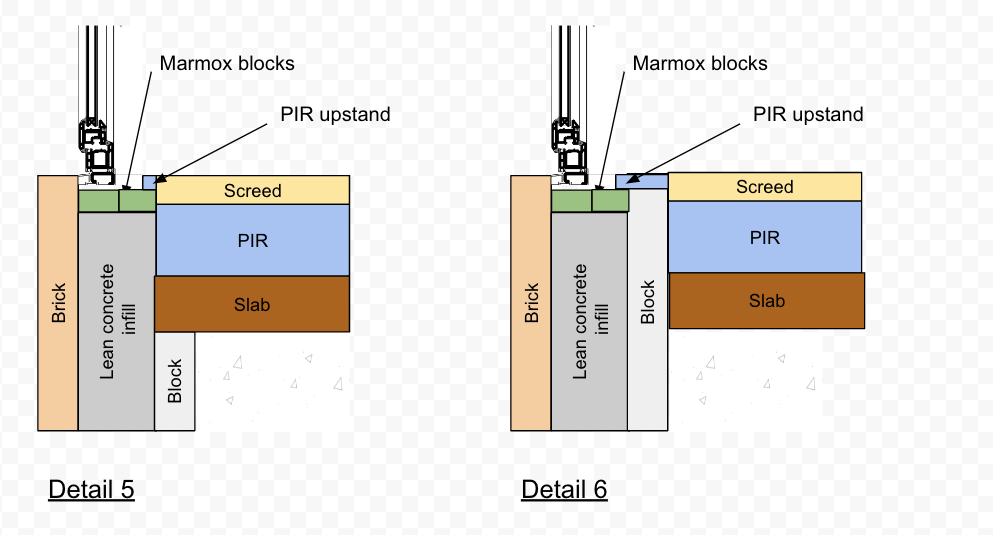

SBMS Posted September 3, 2024 Author Posted September 3, 2024 1 minute ago, Dave Jones said: if you want a level threshold, which you probably do. to thermal break it marmox directly under the cil same level as screed. Dont fill behind it with foam or any other non load bearing material as this is your finished floor surface. You are extending your internal floor to the outside skin and at same time breaking the thermal bridge with the PIR under the screed and the marmox block at screed level. Hi @Dave Jones Is the below right? Detail 5 or Detail 6?
SBMS Posted September 3, 2024 Author Posted September 3, 2024 54 minutes ago, Dave Jones said: neither. need to look like this @Dave Jones - would only one row (deep) of marmox across the cavity be required for a 186mm deep sliding door track? With your detail above most of the doors and track are bearing down on the PIR?
Dave Jones Posted September 3, 2024 Posted September 3, 2024 (edited) no, the cill sits on and is fixed through the marmox block. insulation butts upto it. the photo i posted shows it clearly. Edited September 3, 2024 by Dave Jones
SBMS Posted September 3, 2024 Author Posted September 3, 2024 19 minutes ago, Dave Jones said: no, the cill sits on and is fixed through the marmox block. insulation butts upto it. the photo i posted shows it clearly. Marmox block = 65mm width. Track depth = 186mm. So where under the track is the marmox block positioned?
Mr Punter Posted September 3, 2024 Posted September 3, 2024 1 hour ago, SBMS said: Marmox block = 65mm width. Track depth = 186mm. So where under the track is the marmox block positioned? The Marmox are 100mm wide or optionally 215mm. Depth (height) is 65mm or optionally 100mm.

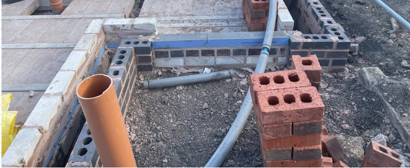

JohnMo Posted September 3, 2024 Posted September 3, 2024 Mine looks pretty close to this, but just used thermolite blocks, but installed a 70mm wide PIR upstand inside the blocks before the screed (in our case 100mm concrete), our doorway straddles the block and PIR, weight taken by brickwork.
Dave Jones Posted September 3, 2024 Posted September 3, 2024 you need the 25mm pir the full perimeter, can include against the marmox but not needed.

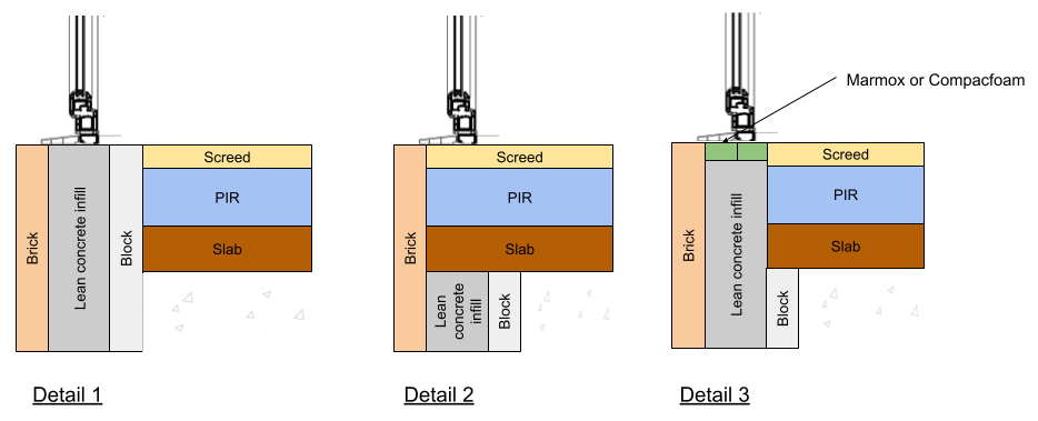

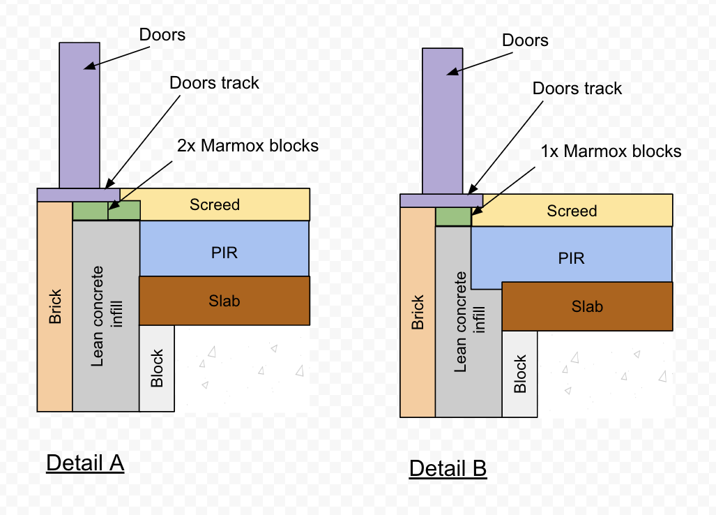

SBMS Posted September 3, 2024 Author Posted September 3, 2024 3 hours ago, Mr Punter said: The Marmox are 100mm wide or optionally 215mm. Depth (height) is 65mm or optionally 100mm. Is the thermal break just required across the cavity to outside brick junction (irrespective of the depth of the track), or should it extend past the inside edge of the track? My example scenario shown below with a 186mm deep track: Detail A looks much easier to construct? 1
Mr Punter Posted September 3, 2024 Posted September 3, 2024 Your door track is creating a thermal bridge between the brick and the screed. A small strip of PIR before the screed would solve this.
SBMS Posted September 3, 2024 Author Posted September 3, 2024 48 minutes ago, Mr Punter said: Your door track is creating a thermal bridge between the brick and the screed. A small strip of PIR before the screed would solve this. @Mr Punter in both details or just in detail 2? Is the second matrix block required in detail 1? 1
Spinny Posted September 6 Posted September 6 Hi, Still wondering how to resolve the 'how do you close the cavity under a door' issue for my own door (see photo) and came across this thread. Please can I ask what exactly is 'lean concrete infill' ? In my case I have concrete blocks on the outer leaf, and celcon blocks on the inner leaf. I am concerned that if I use a partial infill of concrete that it may not adhere well to the side of the celcon block. I need some reliable way to support what would otherwise be a floor cantilever over the cavity.
FranArch Posted Friday at 18:25 Posted Friday at 18:25 (edited) Detail 2 but use Yellow as full filled cavity insulation (mineral). Otherwise you will have a massive thermal bridge. This is a standard detail. The doors should be moved left on the brick and the frame should overlap the cavity insulation at least 20mm for building regs. Edited Friday at 18:30 by FranArch
