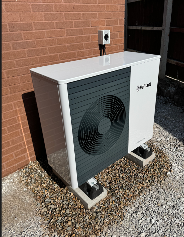

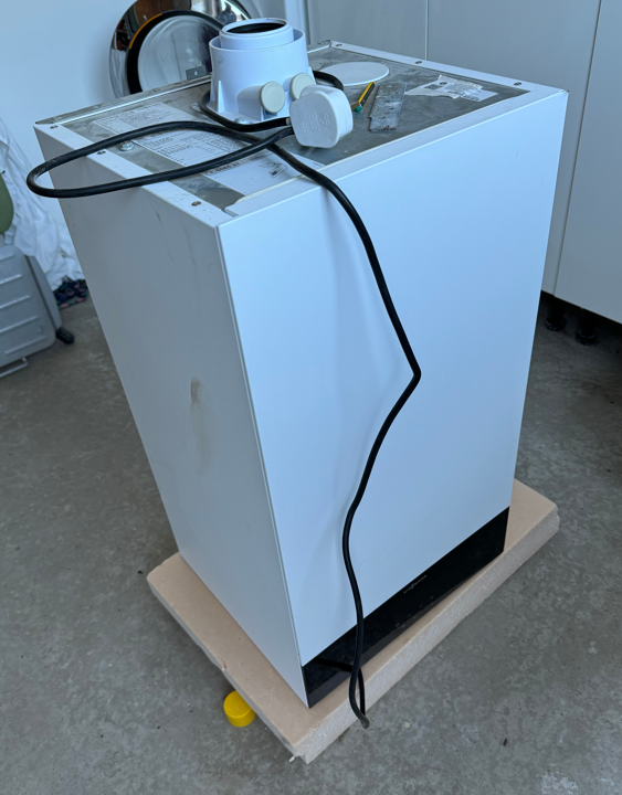

mk1_man Posted August 31 Share Posted August 31 Chuffed to bits, finally finished my diy install of my nice shiny 7kW Arotherm. Have only used for dhw but working a treat once I realised that my esbe diverter valve was wired back to front and I was heating the ufh ! Just need to finish off wiring the OEM stuff. Old boiler out : New unit : Primary Pro and anti-freeze valves 8 Link to comment Share on other sites More sharing options...

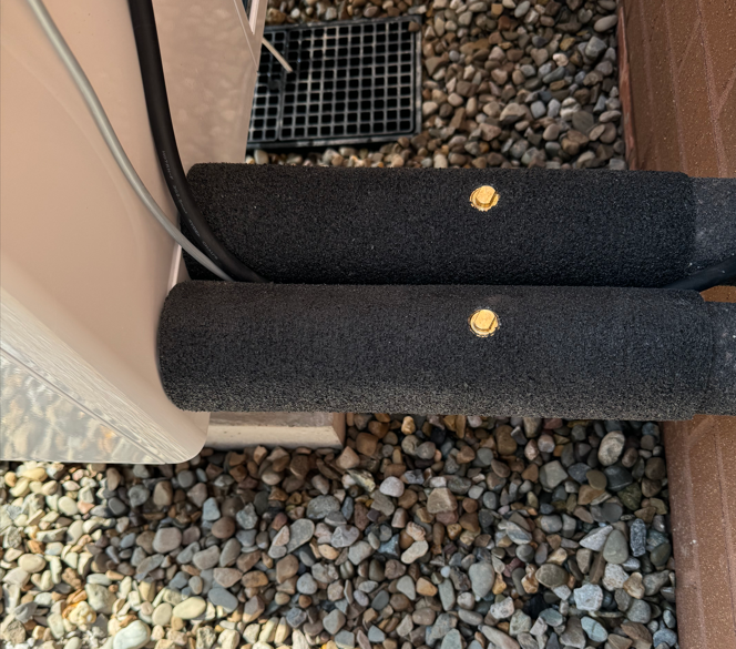

ReedRichards Posted Thursday at 07:32 Share Posted Thursday at 07:32 I'm not sure that foam insulation is suitable for outdoor use. It's certainly not the type that is usually used. Link to comment Share on other sites More sharing options...
joe90 Posted Thursday at 07:56 Share Posted Thursday at 07:56 21 minutes ago, ReedRichards said: I'm not sure that foam insulation is suitable for outdoor use. It's certainly not the type that is usually used. I wrapped mine in tape self amalgamating. BT use it for waterproofing cable joints. https://www.toolstation.com/self-amalgamating-repair-tape/p55262 Link to comment Share on other sites More sharing options...
crispy_wafer Posted Thursday at 08:13 Share Posted Thursday at 08:13 (edited) Looks like the primary pro stuff to me? Primary Pro 28mm x 19mm Insulation - 1 metre length (midsummerwholesale.co.uk) Edited Thursday at 08:15 by crispy_wafer 1 Link to comment Share on other sites More sharing options...

mk1_man Posted Thursday at 11:44 Author Share Posted Thursday at 11:44 4 hours ago, ReedRichards said: I'm not sure that foam insulation is suitable for outdoor use. It's certainly not the type that is usually used. The insulation is Primary-Pro, brilliant stuff and possibly the best for external use. I am however going to be putting a sort of lid over it made up of some 40mm xps foam board I have. Conscious of need to maintain air to the anti-freeze valves. Link to comment Share on other sites More sharing options...
crispy_wafer Posted Thursday at 12:18 Share Posted Thursday at 12:18 QQ, How did you deal with the insulation through the wall? I see they have plastic interface thingies for tidying the hole up, in two minds as to whether they are worth it though. Link to comment Share on other sites More sharing options...
