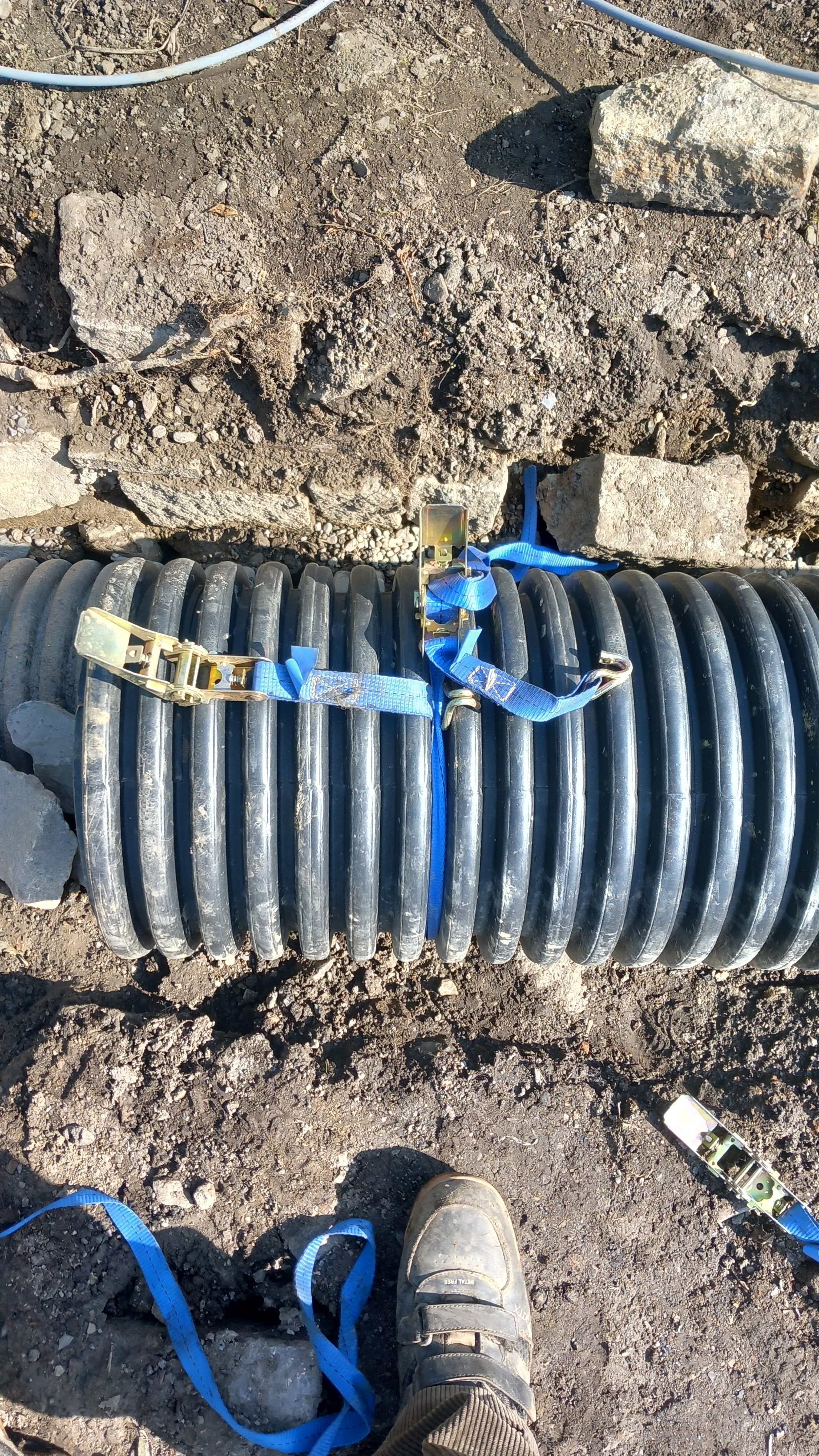

this is what I have come up with
use one smallratchet around pipe to ancor another one
then do same around bend
then pull them together
need another man to do it so cannot do it today

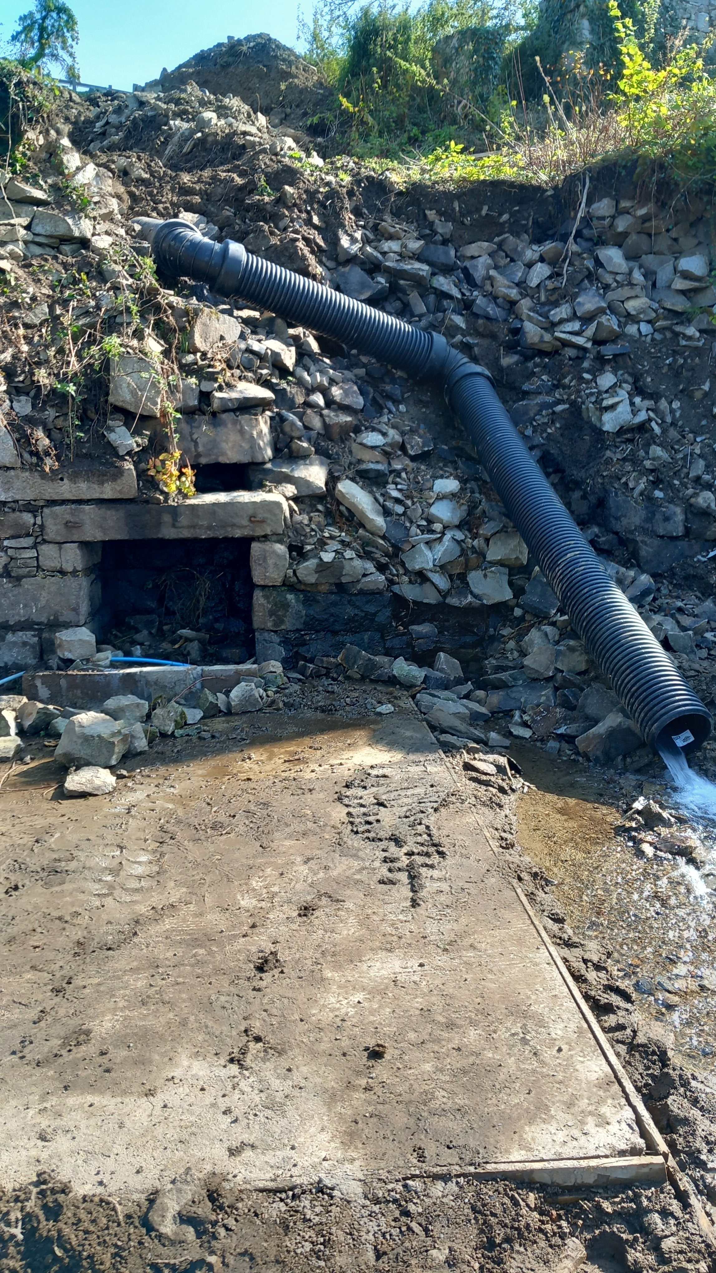

 also showing water flow today --which is just above average summer flow-1/2 tp 3/4 full in winter

they will go inwith the ratchet strap method  of that i,m sure --not sure iwill be able to swivel them if needed
