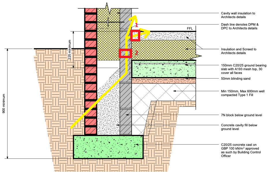

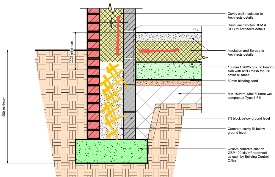

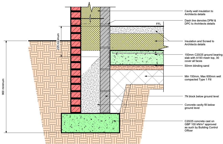

We currently have the following 'standard' detail for foundation arrangement:
We are using EPS beads for cavity insulation.
Have seen a number of different schemes to reduce thermal bridging.
Enhancement one: the 'denby dale detail' where the bottom four courses of inner block are switched out to aerated concrete.
Enhancement two: putting a course of marmox thermablock adjacent to the screed to minimise bridging (about £1400 additional cost for that).
Enhancement three:  instead of the concrete cavity fill before ground, we could bring the beads right down below ground level.
Which of the above would recommend incorporating into the above detail with regards to a cost vs benefit analysis?
Start by looking at continuity insulation.
First place its missing on the edge of the screed. So enhancement is required there, add insulation width equal to being flush with the inner edge of the skirting
Second your inner wall of blocks is directly connected to ground, so you need a thermal break there. Two rows of aerated blocks will be fine. Move dpm so the aerated blocks are inside and stay dry.
Enhancement two adds nothing to the party already being done by aerated blocks
Enhancement three brings nothing additional to the party there is no thermal bridge there.

Thanks. Architect has specified PIR upstand around screed (not on engineer drawings above). Is that what you mean?
Just to clarify - your two courses of aerated blocks - are they the ones directly below FFL (adjacent to the slab, insulation and screed?)
Where do you mean regarding the DPC movement?

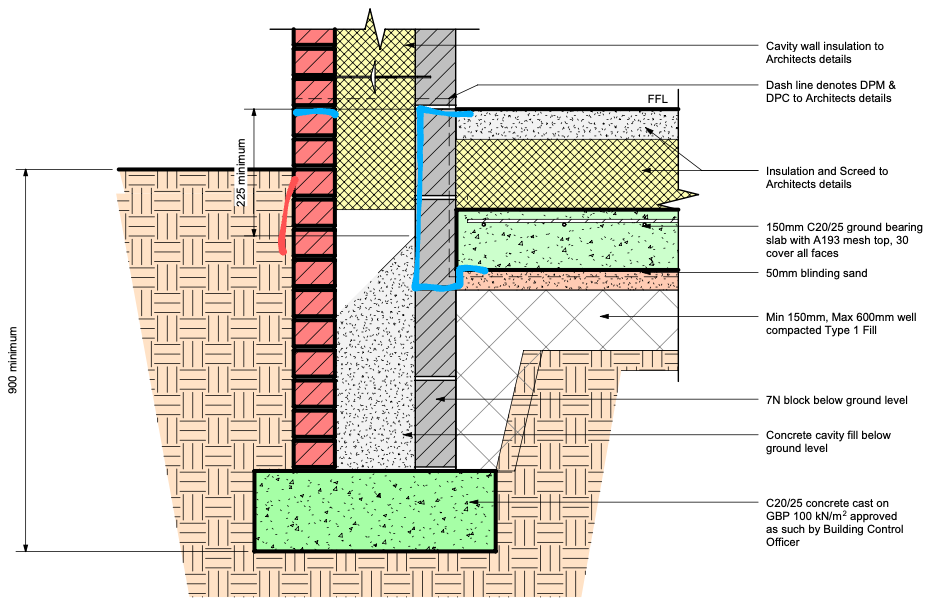

Yes, but make a thick as practical especially if you have UFH.
Start at top of screed and down 2 levels.
DPC to keep aerated blocks dry
image.png.d4a56559dcd5baf2ae530fee2fc7848a(1).png.d5d2fad146976435cc5184ea4cf67316.png
Thanks. Out of interest if this is as effective as marmox thermablock - why would anyone use them instead of the above detailing?

With that DPC - how would we get the beads below the DPC?

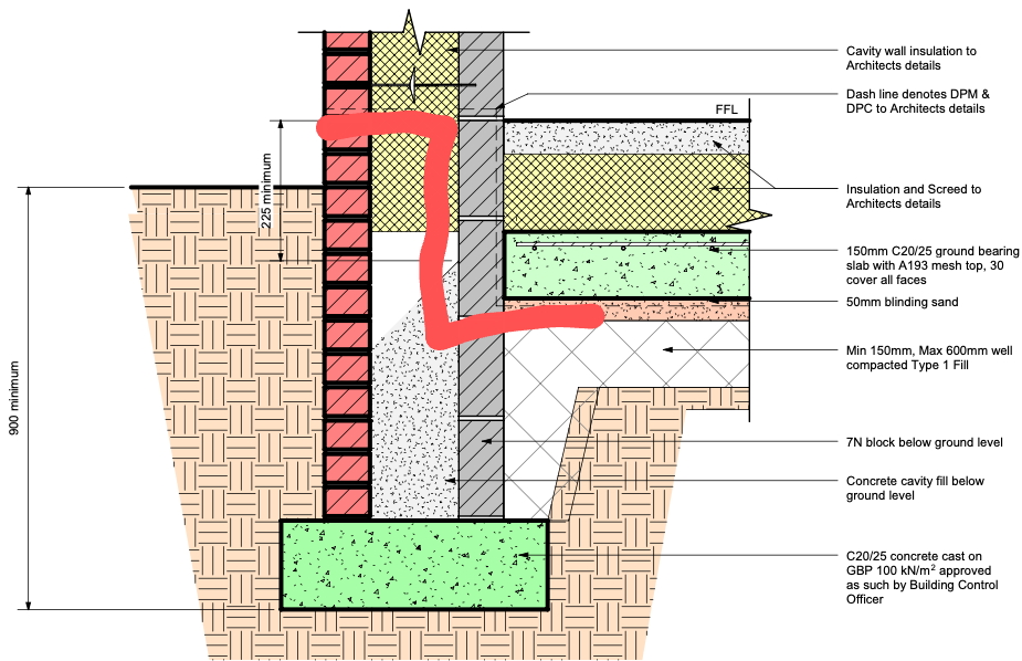

Is there any reason why aircrete blocks would be needed if we brought the cavity insulation (EPS beads) right down to the bottom of the cavity?
Would that negate any thermal bridging? I don’t know whether a Cavity tray at DPC level would still be needed.
Link to comment
Share on other sites
No! This thermal bridge would remain, your aercrete blocks get rid of this.

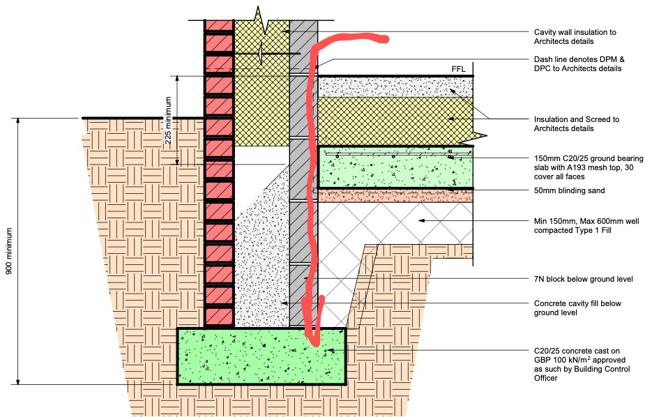

At the risk of sounding daft (I don’t mind!).. if the cavity below ground is filled with insulation, how is this thermal bridging any different to above ground - ie the same makeup with a block wall and then 200mm of insulation? Is it because it’s a solid mass below ground on the inside of the wall as opposed to mostly empty space (ie a
room) above the DPC? Or is the primary reason for using aircrete
blocks simply to negate the thermal bridging of the bottom most block sitting on the foundations?
I hope my naivety will be useful for others!

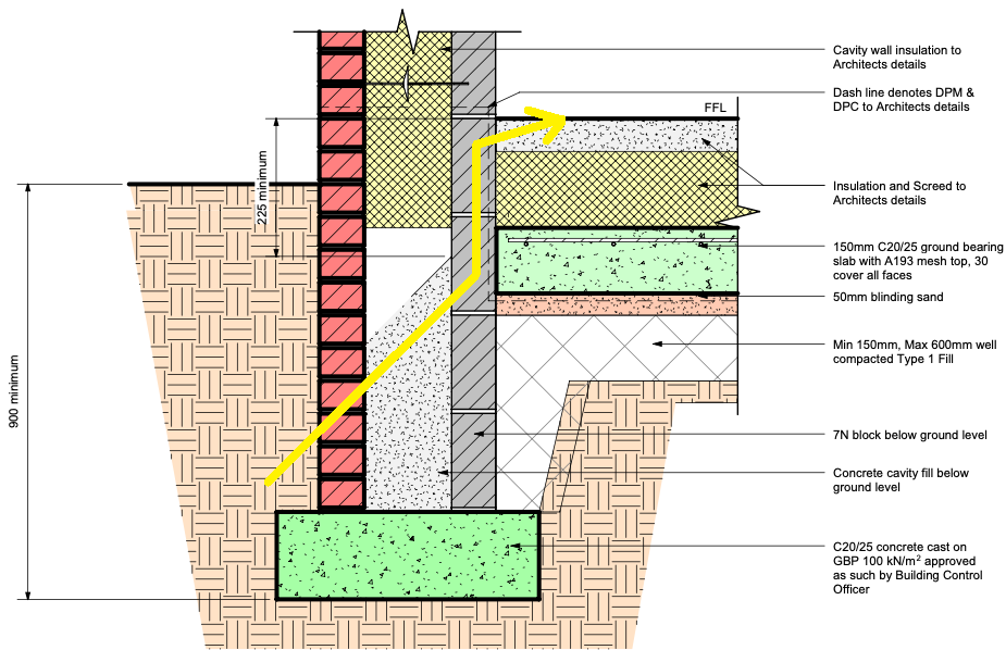

Couple of basics,
Heat always moves towards cold, in any direction. Sideways, up or down it doesn't matter.
You need to be able to draw an unbroken line around any cross section of the building, the line follows the insulation. This line determines if you have a thermal bridge. Below the red line is broken by the concrete block.
image.png.d4a56559dcd5baf2ae530fee2fc7848a(4).png.440d859e1b522281188726d4fb864349.png
So with the cavity fully filled with insulation. And no aercrete blocks, you have a gap in you insulation. The heat inside the room will pulled down toward the ground. Insulation within the cavity has no effect on this. Having insulation in the area I have cross hatched in yellow serves no gains.

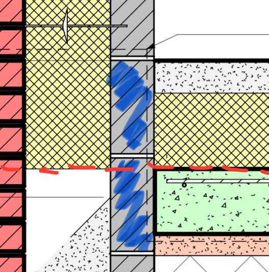

Got you. I think the thing I couldn’t make sense of is why I’ve read in a few places on here that members have taken their insulation to the bottom of foundations. In my head in only makes sense to take it to the same depth as the slab insulation (dotted red line below) Am I correct on that?
So in summary, I just need to change the two courses of inner block immediately below DPC (marked blue below) to aircrete blocks and that’s it?
Link to comment
Yes correct.
Just about and take the dpm up inside the cavity to keep the aircrete blocks dry. Or even paint with a bitumen paint on the cavity side would work.

Thanks @JohnMo got it now.

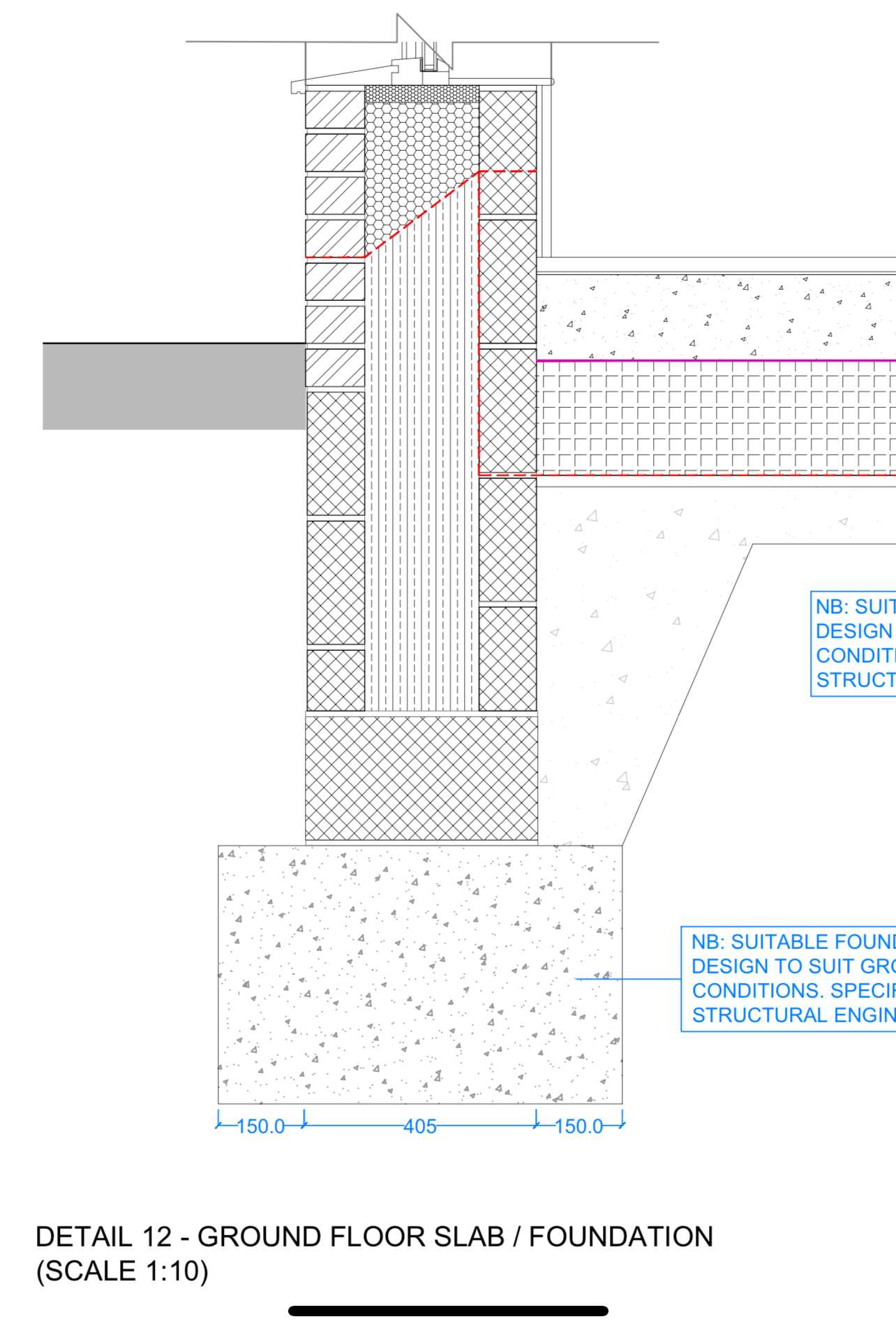

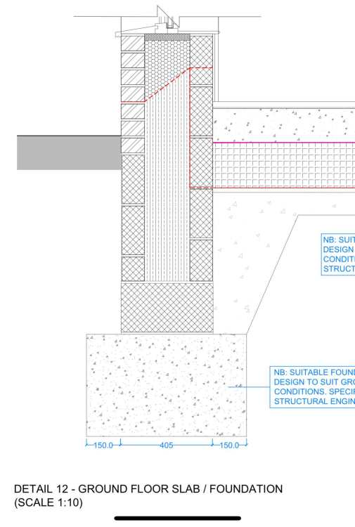

Out of interest how would one typically ‘stop’ the EPS beads 225mm above the concrete cavity fill? A cavity tray?
FYI this is the architect detailing showing the DPC/cavity tray in red dotted line - does this catch the EPS beads?
Edited by SBMS
Link to comment
I dont think you need to stop the beads they are not going to wick. Cant they sit on the conc infill? I had dritherm bats so managed to keep 3" off conc with the ties but pretty sure eps could go down to bottom.
I did the aircrete blocks kept dry on my current place. You dont nessecarily have to wrap the dpm back in although it would be neat. You will have another dpm at finished floor level anyway

12 hours ago, SBMS said:
Did you do similar detailing re DPC as suggested? Were you on PIR for cavity insulation or beads?
Yes: radon membrane under slab, continues horizontally under the aircrete the turns up inside the cavity join the horizontal DPM throgh the wall.
I'm at the design stage too and haven't specified the insulation for the cavity, so reading this with interest to see what options are available. Mine is twin wall timber frame with cellulose fill, so my above ground cavity insulation is a separate consideration. Because of this, I'll probably run the radon membrane under my foundation cavity insulation then up the inner face of the external block to keep both insulation and aircrete block dry.
General question for you & others: I'm not sure on the value of 2x300mm aircrete blocks? With insulation above the slab the top block is pretty much continuous with this and limits both the horizontal and vertical bridges. What does another lower insulating block add?
