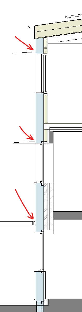

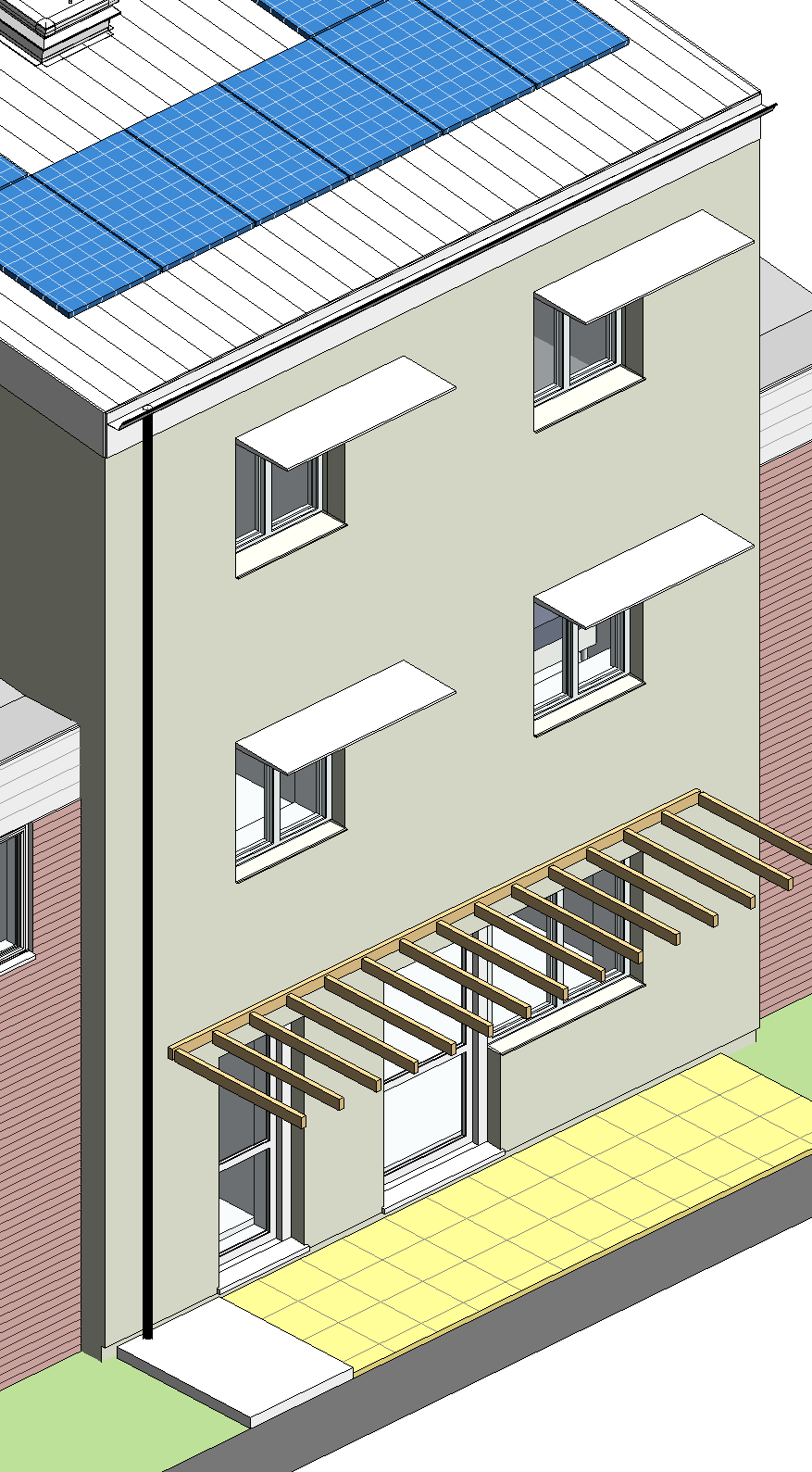

Crispy75 Posted August 26 Share Posted August 26 Hi, long time reader first time poster As part of a comprehensive retrofit and extension project I will be insulating my existing brick and new timber frame walls with at least 200mm EWI. I'm comfortable with specs/details for the basic buildup, but would like some advice WRT to through-insulation fixtures, in particular: I want to install brise soleil or awnings to south-facing windows to cut down on summer solar gain. I also plan to support one edge of a pergola at ground floor (so a long beam fixed to the wall). I can't seem to find a standard method for achieving this. I don't want to simply bolt something direct to the brick with a Farat pad and insulate/render around it. I'd rather provide a secure surface directly behind the render so the awning, beam etc. can be as simply fixed as if it was a solid wall. I've found the SWFix product, but that doesn't seem geared to anything heavy or cantilevered. Has anyone solved the same problem in an elegant and robust way? I'm not going to just bulk it out in timber am I? Link to comment Share on other sites More sharing options...

TommoUK Posted August 26 Share Posted August 26 Timber will be cheapest but may not give you the look you want. Have a look at horizontally mounted aluminium brise soleil systems. Lower profile than timber, light weight and easy to fix to the structure. Most suppliers will provide recommended fixing details and /or brackets Link to comment Share on other sites More sharing options...

Crispy75 Posted August 26 Author Share Posted August 26 Thanks for the replies! Yeah I'm not too fussed about cold bridges from a few screws or bolts, but doing an offset frame in timber will be a pain to fit the EWI round. Lots of cutting and glueing and scraping and cursing. Thought there might be a "big chunk of GRP or nylon with nice square edges and concealed fixings" kind of solution. My experience in the construction industry has lead me to believe that you have to make things as simple as possible for builders if you want anything approaching a careful job. Much rather spend extra upfront on a clever product than have my carefully annotated NASA-grade details ignored or bodged. Link to comment Share on other sites More sharing options...
