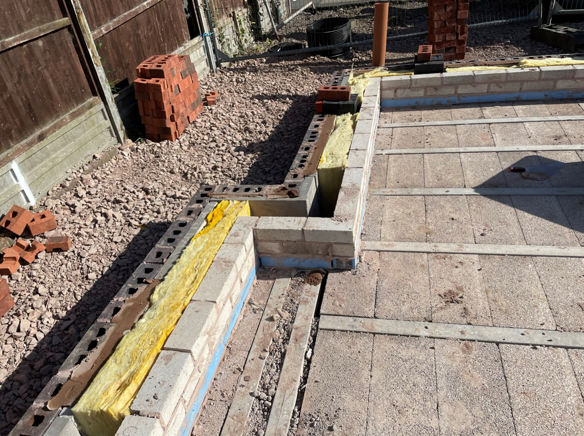

Dave Jones Posted August 26, 2024 Posted August 26, 2024 (edited) we have a passive equivalent slab using block and beam. Marmox perimeter to eliminate any thermal bridging, 150mm PIR or if you have depth 300mmm XPS for same price. Edited August 26, 2024 by Dave Jones 1

zzPaulzz Posted August 26, 2024 Author Posted August 26, 2024 (edited) On 26/08/2024 at 09:59, Dave Jones said: we have a passive equivalent slab using block and beam. Marmox perimeter to eliminate any thermal bridging, 150mm PIR or if you have depth 300mmm XPS for same price. Expand Nice! Who did the design for you? Edited August 26, 2024 by zzPaulzz

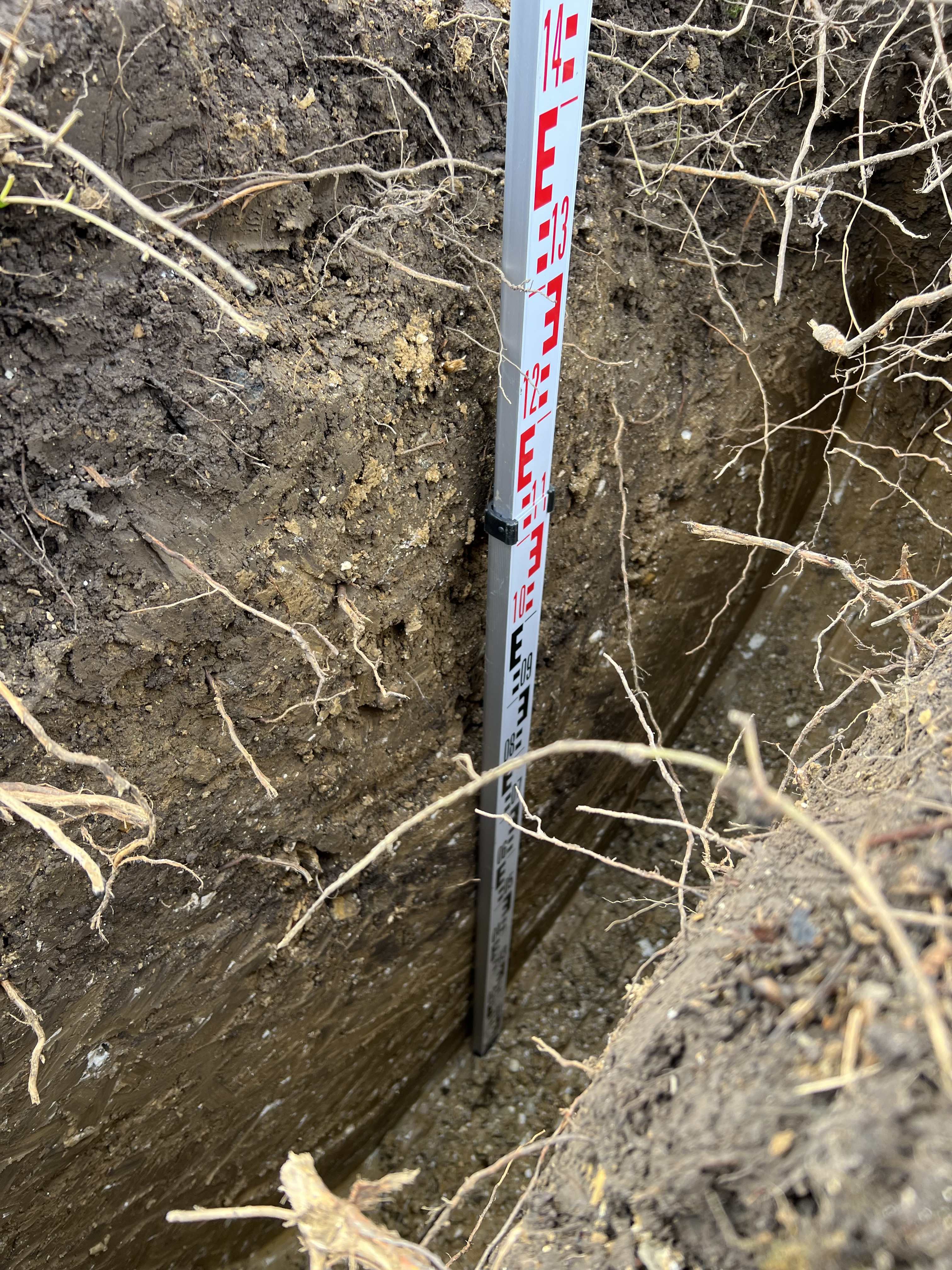

zzPaulzz Posted August 26, 2024 Author Posted August 26, 2024 I dug a deeper hole. Sharing for your enjoyment if you like that kind of thing.
Dave Jones Posted August 26, 2024 Posted August 26, 2024 On 26/08/2024 at 11:45, zzPaulzz said: Nice! Who did the design for you? Expand me. its normal build, nothing special. 1

FarmerN Posted August 27, 2024 Posted August 27, 2024 We had a meter of clay over wet sand with trees close by. Was more or less forced into piles down 4.5 M by structural engeneer , who was worried about clay shrinkage in summer due to tress. Ended up with Beam and block foundations with 180 mm insulation under 90mm screed. Perinsula under perimiter walls at insulation level. My dream when we started out was a passive raft, possibly on Foam glass aggregate ( Geocell ) as the site needed building up a bit.

FarmerN Posted August 27, 2024 Posted August 27, 2024 I suppose I was just not committed enough to the Passive house. Also wanted to use local people and was just getting no support from two different SE or architect. The theoretical u values of the floor are still good, but I have no faith in the whole beam and block construction, cold air beneath the floor instead of solid earth . Yes also worried about thermal bridging It’s all built now so got to live with it. A thermal imaging camera in winter will be interesting. We have GSHP, MVHR , PV and battery Yet to live through a winter, so February will be interesting.
