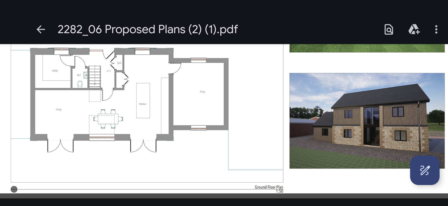

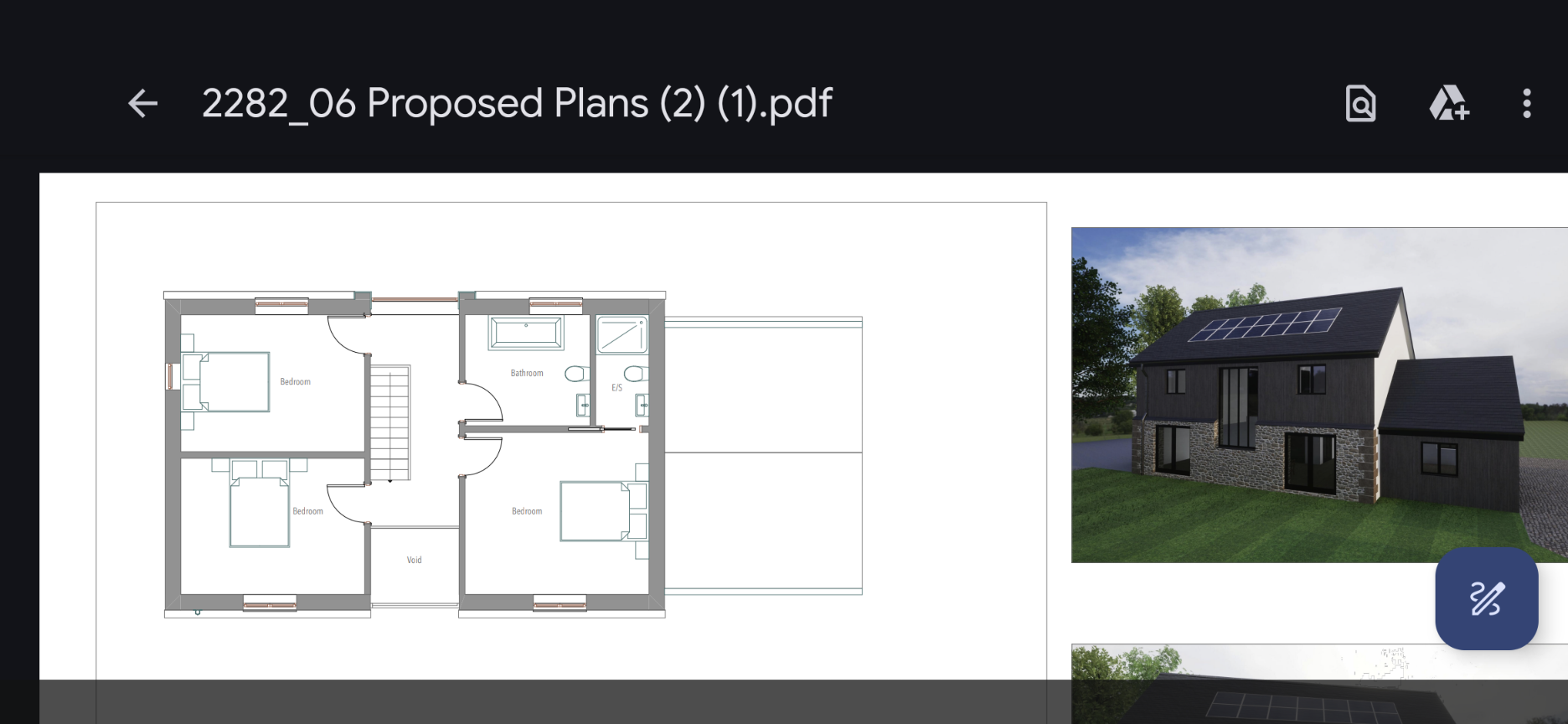

edd05surf Posted August 24 Share Posted August 24 Hi everyone. Long time listener, first time caller here. Myself, my wife and 2 young children are heading towards our first and hopefully last build project here. We have pretty much finalised our plans for a knock down and re build and was wondering if we could tap the hive mind for anything obvious we may have overlooked. This is not quite the final design, we've asked the architect to make the main house 0.5m deeper to make the main living/dining area a bit more spacious. Also the 1st floor is to be flipped to put all the bathrooms above the utility room to simplify plumbing etc. Thanks in advance for all your help. A little context about the site as it's not obvious from the drawings. The front door faces NW, from the upstairs landing there are views across the countryside. The rear faces SE and opens out onto the garden. I hope this explains it well enough! Thanks again Link to comment Share on other sites More sharing options...
Dave Jones Posted August 24 Share Posted August 24 the warehouse style layout, make some rooms. Plenty room for another en-suite. Link to comment Share on other sites More sharing options...
nod Posted August 24 Share Posted August 24 You may not need the extra space But as always with me From a cost perspective Taking the single story room up to full height will cost you Pennie’s in the grand scheme of things We all have moans about what we should have done once complete But I can’t remember anyone complaining over building something to big Look good and uncomplicated to build 1 Link to comment Share on other sites More sharing options...
G and J Posted August 24 Share Posted August 24 The trouble with answering a post like yours is that I pretend to myself that I’m being objective but in reality I can’t help unconsciously putting my personal preferences forward. So be warned….. but… If I’ve understood correctly the main bed faces south east, and the end gable of the single story bit faces roughly north east, i.e. the direction the sun come up in in summer. I’m with Nod on making the single story bit double, and I’d be tempted to use it for a bigger and more luxurious main bedroom with a really nice sized bathroom and dressing room. And I’d face the windows (plot and planning allowing of course) towards the morning sun, with the bed facing the windows. (Oh look, I’ve just described our build lol) It’s lovely that you appear to be giving your kids so much room but fast forward to when they’ve their own families and you may find that layout means you are cramped but not using a large area of upstairs. I’d price up putting steel in so the wall between kitchen and snug could be removed (which would be a lot cheaper if you did go two storey above the snug) to allow reconfiguration of downstairs later as your needs and preferences change. And I’d allow for plant somewhere (not the loft), maybe a decent sized cupboard. Link to comment Share on other sites More sharing options...
edd05surf Posted August 24 Author Share Posted August 24 Hi everyone. Thanks for all the feedback. We have had the discussion about making the snug double height, it would make a lovely ensuite, then we could make the family bathroom bigger or even squeeze in a box room. However, part of the brief was to have a vaulted living space, my wife particularly is a big fan of this! I appreciate that everyone has opinions, but it's nice too hear from people who have actually been there and done it. It's hard to get an idea of what works just from some drawings! With regards to a plant room, I was hoping there would be enough space in the utility. Im thinking wall mounted mvhr, air source heat pump on gable wall with associated hot water tank and what not just inside. Battery and electrical will hopefully be in the existing garage. Does that sound feasible, or is it wiser to have a separate plant and utility room? Link to comment Share on other sites More sharing options...
torre Posted August 24 Share Posted August 24 Looks like you've a gallery landing open to the kitchen space below. Have you looked at the fire safety impact of that? Possibly fire doors on the bedrooms and windows suitable as means of escape. Link to comment Share on other sites More sharing options...
edd05surf Posted August 26 Author Share Posted August 26 On 24/08/2024 at 22:39, torre said: Looks like you've a gallery landing open to the kitchen space below. Have you looked at the fire safety impact of that? Possibly fire doors on the bedrooms and windows suitable as means of escape. Fair point , thanks. I think the architect mentioned about needing fire doors. I'll keep in mind about escape windows Link to comment Share on other sites More sharing options...

Bonner Posted August 26 Share Posted August 26 Have you considered flipping the bedroom layout so your bathrooms are over the utility? Reduces pipe lengths, hot water losses and unwanted noise in living areas. Link to comment Share on other sites More sharing options...

edd05surf Posted August 27 Author Share Posted August 27 On 26/08/2024 at 08:09, Bonner said: I have all plant in the utility, makes it a little cramped for washing etc. but yours looks double the size. That's good to know, thanks very much. I've seen some people on here have some pretty extravagant plant rooms, which makes me pretty envious! We're planning on flipping the upstairs for exactly your reasons. Great minds think alike! Link to comment Share on other sites More sharing options...
