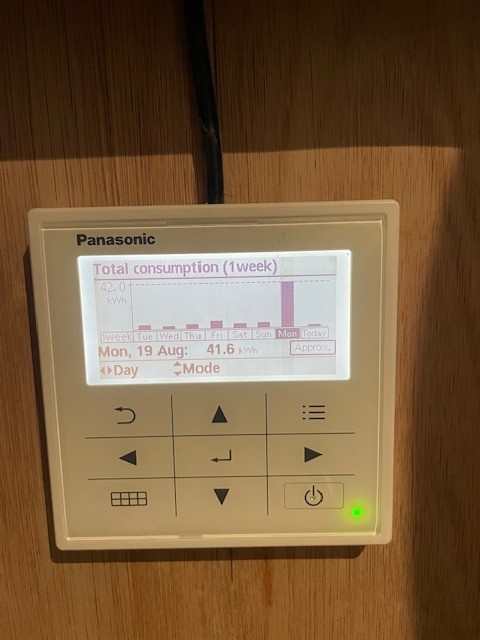

richo106 Posted August 19, 2024 Share Posted August 19, 2024 Good Evening I have an ASHP and 300L DHW tanks, I was just looking at a few things tonight regarding energy and realised the weekly sterilisation cycle on my tank uses around 48kwh of electricity The current sterilisation set up is 1am Monday morning, the sterilisation temperature is 60 degrees for 1 hour is this normal? Can the duration be reduced to say 30 minutes? My normal set point of the water tank is 52 degrees Any advice/suggestions welcome, many thanks Link to comment Share on other sites More sharing options...

JohnMo Posted August 20, 2024 Share Posted August 20, 2024 7 hours ago, richo106 said: weekly sterilisation cycle on my tank uses around 48kwh of electricity Not sure it can you are only adding around 3kWh to the water to get from 52 to 60 degs. Where are you getting this usage figure from? I suspect to get to 52 degrees every day the immersion is kicking in more frequently than you think. Have you checked? Do yourself a favour and read the details of legionella. We store at 50, within 2 hrs 80-90% of legionella is dead - if it was there in the first place. We do not do a legionella cycle. Link to comment Share on other sites More sharing options...

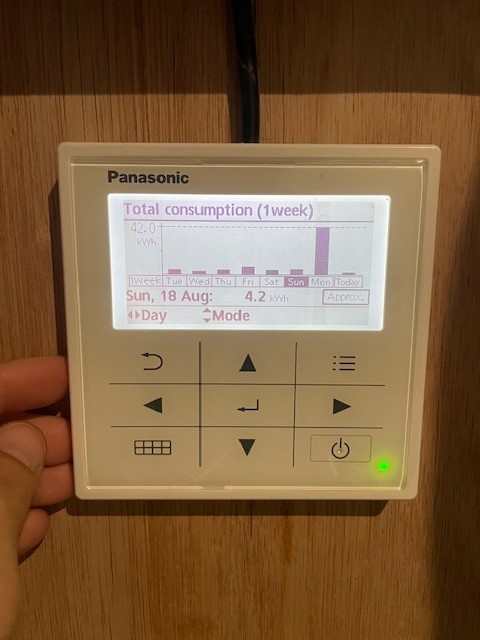

richo106 Posted August 20, 2024 Author Share Posted August 20, 2024 Hi I have attached some pictures of my energy monitor As you can see I normally use around 4kwh per day except on the day my sterilisation where its above 40, it was 47.2 kwh last week Is this normal? Or do i need to speak to my installer about this? It just seems high to me Many Thanks Link to comment Share on other sites More sharing options...
Alan Ambrose Posted August 21, 2024 Share Posted August 21, 2024 It does seem odd - generally a quick temperature rise should be proportional to energy input. I would guess the correct number should be 5 or 6. What temperature does it get to in both cases and what was the inlet temperature? Could it be this is unvented and the pressure increase causes a bunch of hot water to exit via the tundish? 40 kwh in the small space where a tank is normally kept would have the room at unbearable temperature. How long is it meant to stay at top temperature? Link to comment Share on other sites More sharing options...
ProDave Posted August 21, 2024 Share Posted August 21, 2024 I would question what that meter is actually reading and is it true? for a sanity check, I would read the dial on your electricity meter (not any in home display if you have a smart meter). If you know the time of the sterilisation cycle you can read your meter before and after the cycle and see how much electricity it is really using. Try and not use any other big loads in the house during that time to get an accurate reading. Link to comment Share on other sites More sharing options...
marshian Posted August 21, 2024 Share Posted August 21, 2024 3 hours ago, ProDave said: I would question what that meter is actually reading and is it true? for a sanity check, I would read the dial on your electricity meter (not any in home display if you have a smart meter). If you know the time of the sterilisation cycle you can read your meter before and after the cycle and see how much electricity it is really using. Try and not use any other big loads in the house during that time to get an accurate reading. I'd definately do that..... I'd also be seeing if 1. Store temp was actually 52 or something much lower 2. What temp it was heating the store to on the legionaires cycle Quick on line math ignoring the COP of the heat pump from here https://www.omnicalculator.com/physics/water-heating Store temp 50 at start Store temp 60 at end Volume of water 300 L Energy required 3.5 kWh So 41.6 kWh is bonkers Link to comment Share on other sites More sharing options...

John Carroll Posted August 23, 2024 Share Posted August 23, 2024 (edited) On 20/08/2024 at 21:38, richo106 said: Hi I have attached some pictures of my energy monitor As you can see I normally use around 4kwh per day except on the day my sterilisation where its above 40, it was 47.2 kwh last week Is this normal? Or do i need to speak to my installer about this? It just seems high to me Many Thanks Change the sterilisation day and see does the consumption follow it. Edited August 23, 2024 by John Carroll Link to comment Share on other sites More sharing options...

richo106 Posted September 13, 2024 Author Share Posted September 13, 2024 On 12/09/2024 at 11:03, marshian said: Any update @richo106? I am pretty sure it’s an error on the ASHP energy monitor, it doesn’t seem to tie up with the smart meter I have just installed. I have set a reminder in my phone to make sure I read my meter before and after Link to comment Share on other sites More sharing options...
