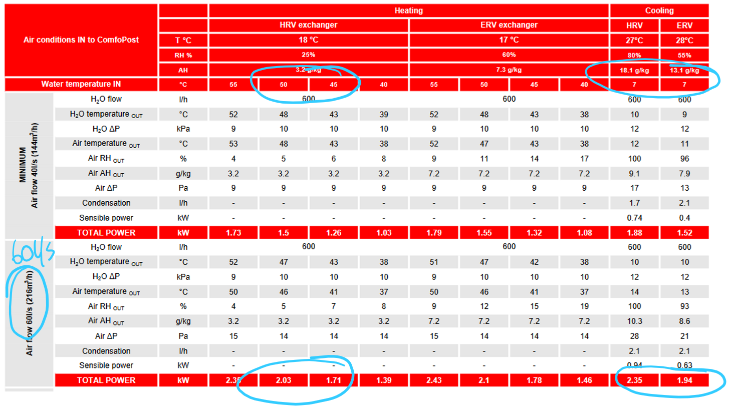

Crispy75 Posted September 6, 2024 Share Posted September 6, 2024 I hope @James Allen doesn't mind me hijacking his thread to ask similar-ish questions. My project is a whole-story extension and external insulation to the whole house. Aiming for EnerPHit (although not bothered about certifying), and have got the numbers in PHPP down to 1.9kW (15W/m²) heating load and 1kW (8.3W/m²) cooling load. It doesn't take much of a boost in airflow rates to get PHPP to say Yes to both heating and cooling via supply air (190m³/hr =52l/s). First I went looking for all-in-one solutions and got quoted an absolute fortune for the PKOM4 (£25k! Excluding install and commissioning!!) Now I think the ComfoPost as reccomended by @Nick Laslett alongside a more off-the-peg ASHP. The Zehnder literature seems to think so anyway. What air flow do you run yours at Nick? Link to comment Share on other sites More sharing options...
Nick Laslett Posted September 6, 2024 Share Posted September 6, 2024 (edited) @Crispy75, my MVHR is not commissioned yet. I would be somewhat hesitate at this stage to recommend the ComfoPost without these caveats. There are other members like @Dan F with more experience, with good comments in other threads. I won’t be running the water in my ASHP in cooling mode any lower than 13°C. My aspiration is to knock 1° to 1.5°c off the house temp with the ComfoPost. Looking at the design spec for my install the supply air (240m³/hr =67l/s). Hope that helps. Edited September 6, 2024 by Nick Laslett Link to comment Share on other sites More sharing options...
JohnMo Posted September 7, 2024 Share Posted September 7, 2024 11 hours ago, Crispy75 said: doesn't take much of a boost in airflow rates I would be wary of doing that, just because of the amount air drying that will go on - you could get an unhealthy humidity level mid winter. Even just below normal levels of ventilation last year we were getting to 30% humidity. Bumping up ventilation rates and heating the air - not sure I would. Heat pump and fan coils kor UFH and fan coils in bedrooms) or A2A and separate MVHR. Link to comment Share on other sites More sharing options...
Dave Jones Posted September 8, 2024 Share Posted September 8, 2024 On 06/09/2024 at 22:49, Nick Laslett said: @Crispy75, my MVHR is not commissioned yet. I would be somewhat hesitate at this stage to recommend the ComfoPost without these caveats. There are other members like @Dan F with more experience, with good comments in other threads. I won’t be running the water in my ASHP in cooling mode any lower than 13°C. My aspiration is to knock 1° to 1.5°c off the house temp with the ComfoPost. Looking at the design spec for my install the supply air (240m³/hr =67l/s). Hope that helps. i have the comfopost, its crap. honestly dont bother. for the price of it you can get a lot of fancoils which do actually work. 1 Link to comment Share on other sites More sharing options...
