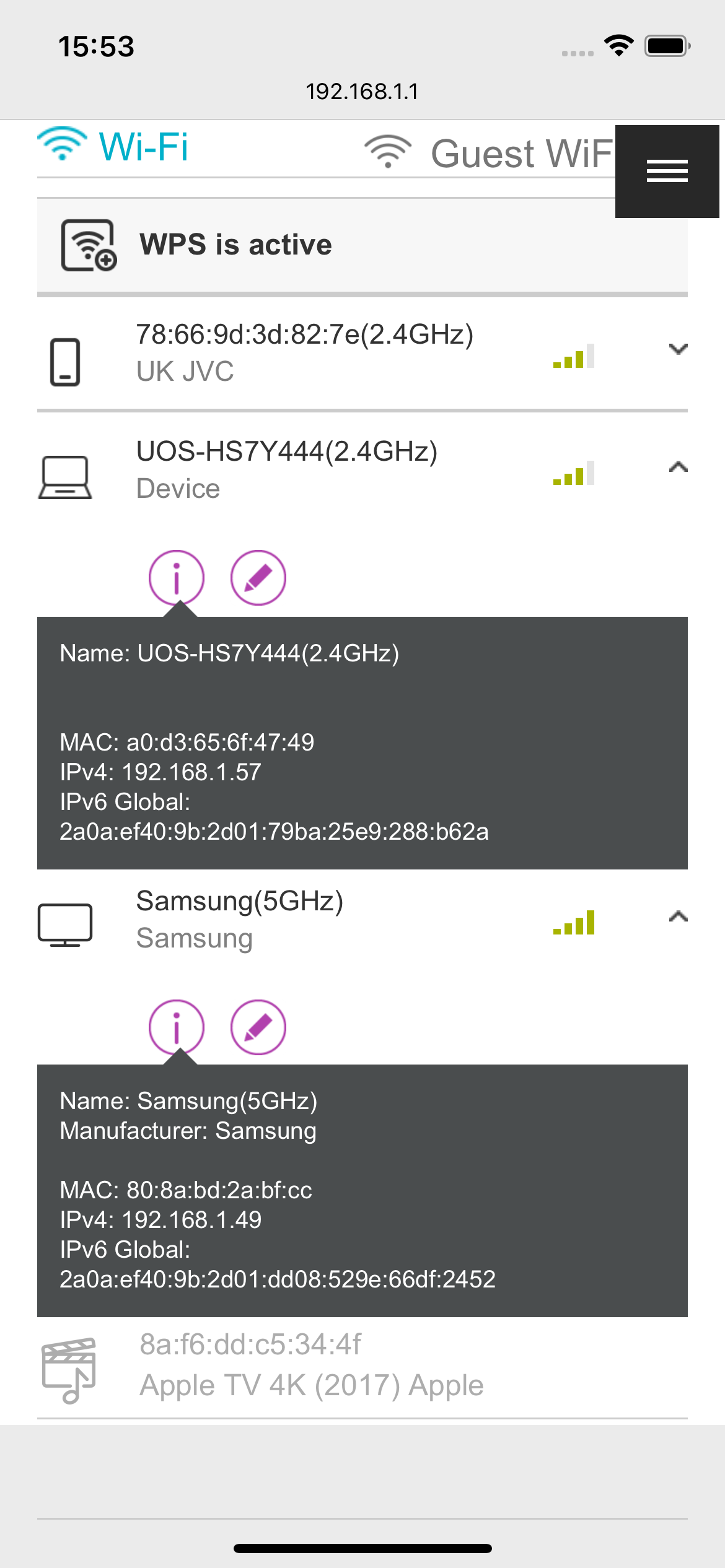

Dan1983 Posted August 13, 2024 Share Posted August 13, 2024 Afternoon all Just come back from holiday and out broadband provider has changed from BT to Vodafone The cameras went down on switching day and are now not working after new router install Will this be due to the change of IP address? We have a serage SR8004N NVR Is there a simple fix or will a technician need to be called? many thanks for any pointers Link to comment Share on other sites More sharing options...

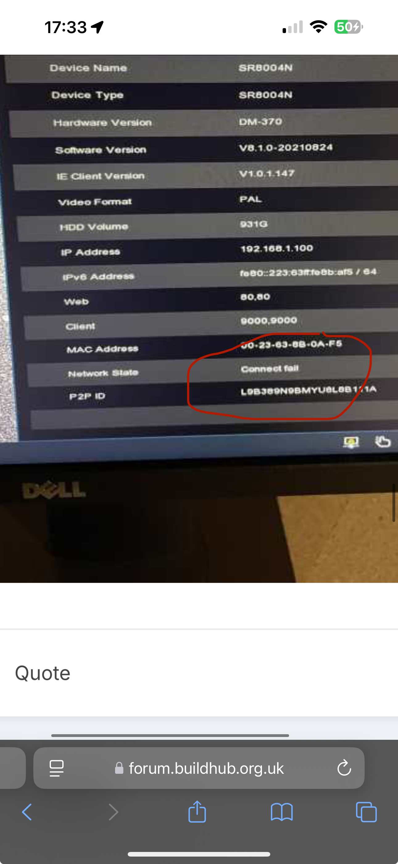

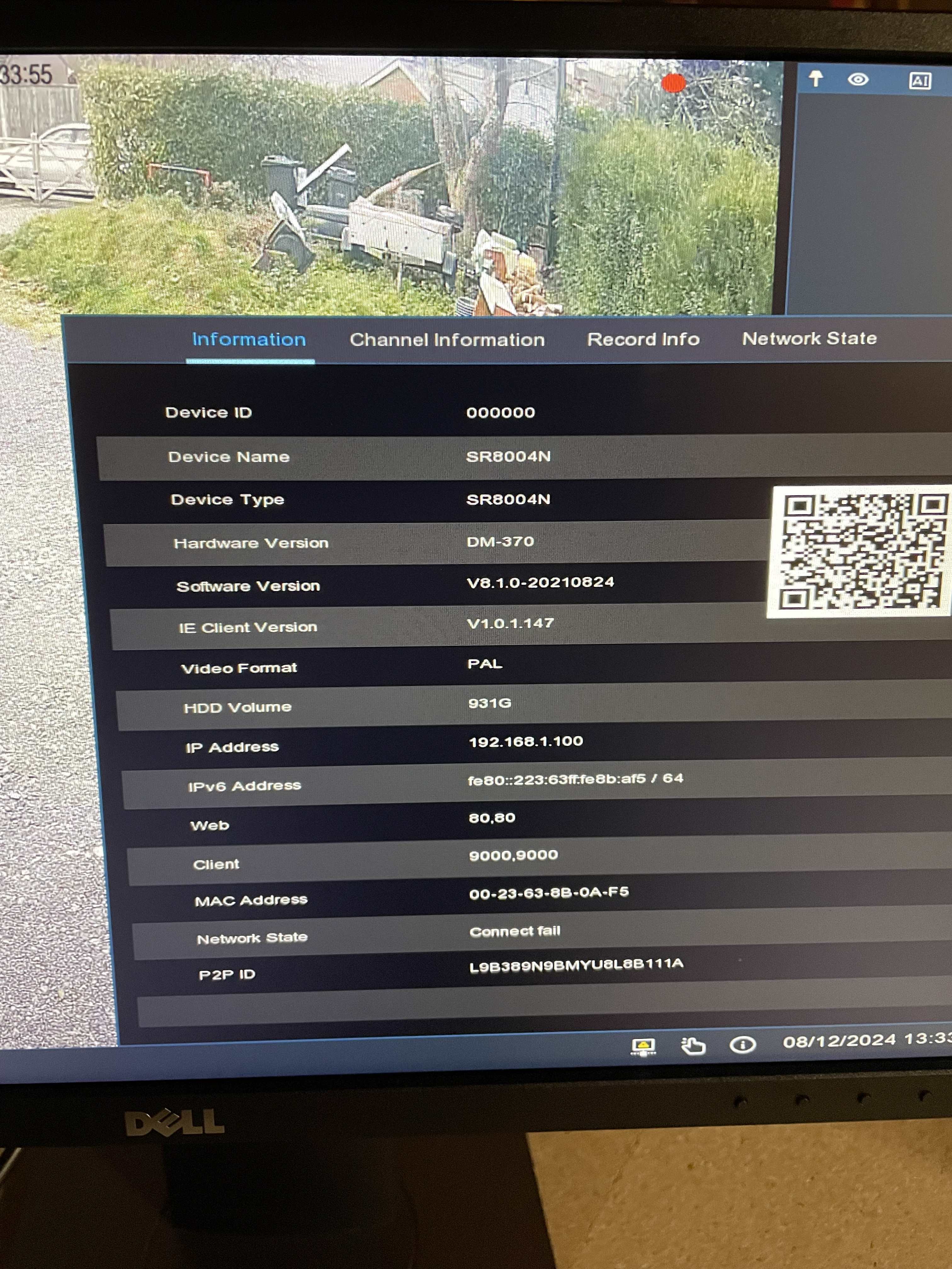

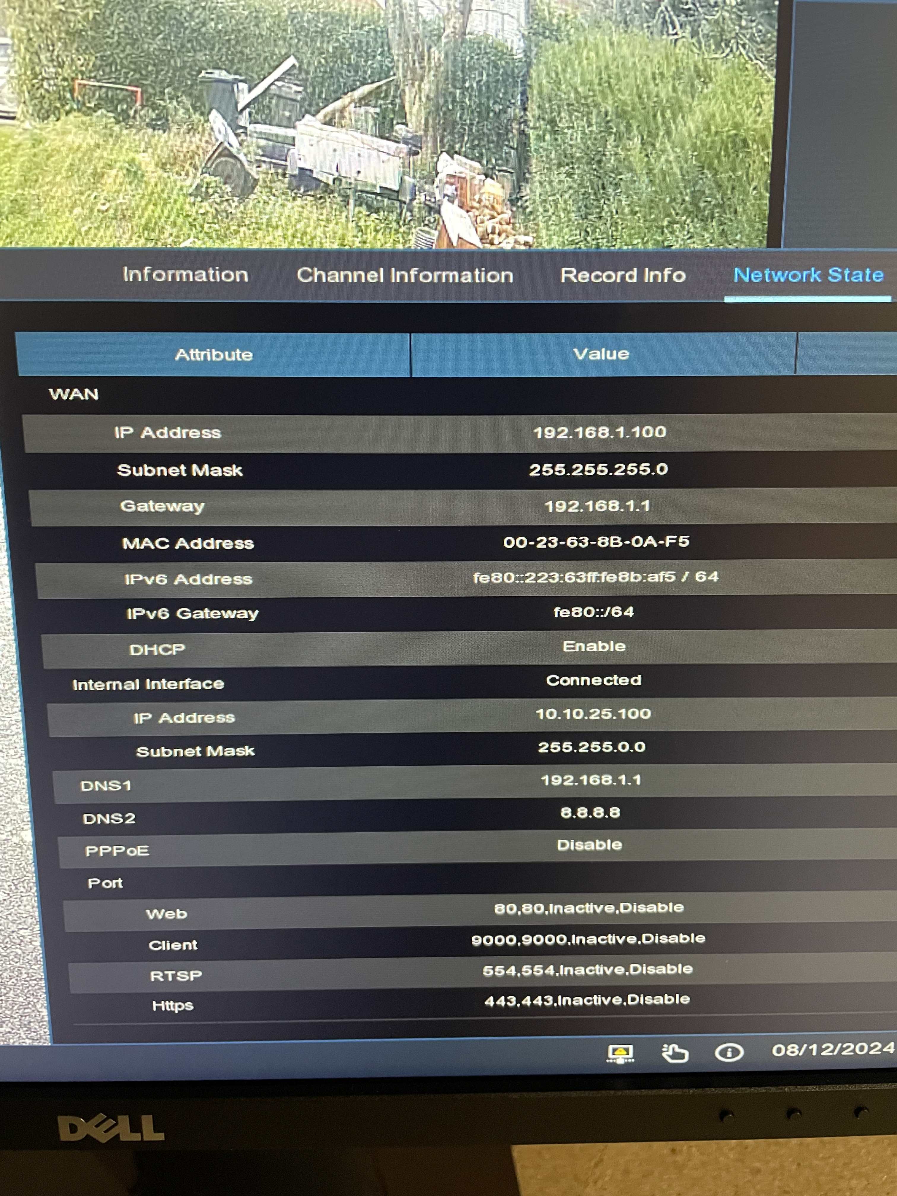

Dan1983 Posted December 8, 2024 Author Share Posted December 8, 2024 Just hooked up a monitor but don’t think I really understand enough about it 1 camera working but other 2 are not connected From logging in to the router it does not seem like the nvr is connected as not showing on the list Link to comment Share on other sites More sharing options...

Pocster Posted December 8, 2024 Share Posted December 8, 2024 Log into the router . So go into a browser and do 192.168.1.1 That should bring up your router login screen . Assuming you’ve never changed the password you’ll need to enter the default for that brand . Might even be printed on the back of the router . Do that stage next 😊 1 Link to comment Share on other sites More sharing options...
Dan1983 Posted December 8, 2024 Author Share Posted December 8, 2024 Yes sorry also logged in to router and the NVR is not showing on there Link to comment Share on other sites More sharing options...
Pocster Posted December 8, 2024 Share Posted December 8, 2024 Aren’t those screenshots your nvr though ? 192.168.1.100 ? Link to comment Share on other sites More sharing options...
Dan1983 Posted December 8, 2024 Author Share Posted December 8, 2024 Yes screen shots were from the NVR Do you need a screen shot of the router list? 1 Link to comment Share on other sites More sharing options...

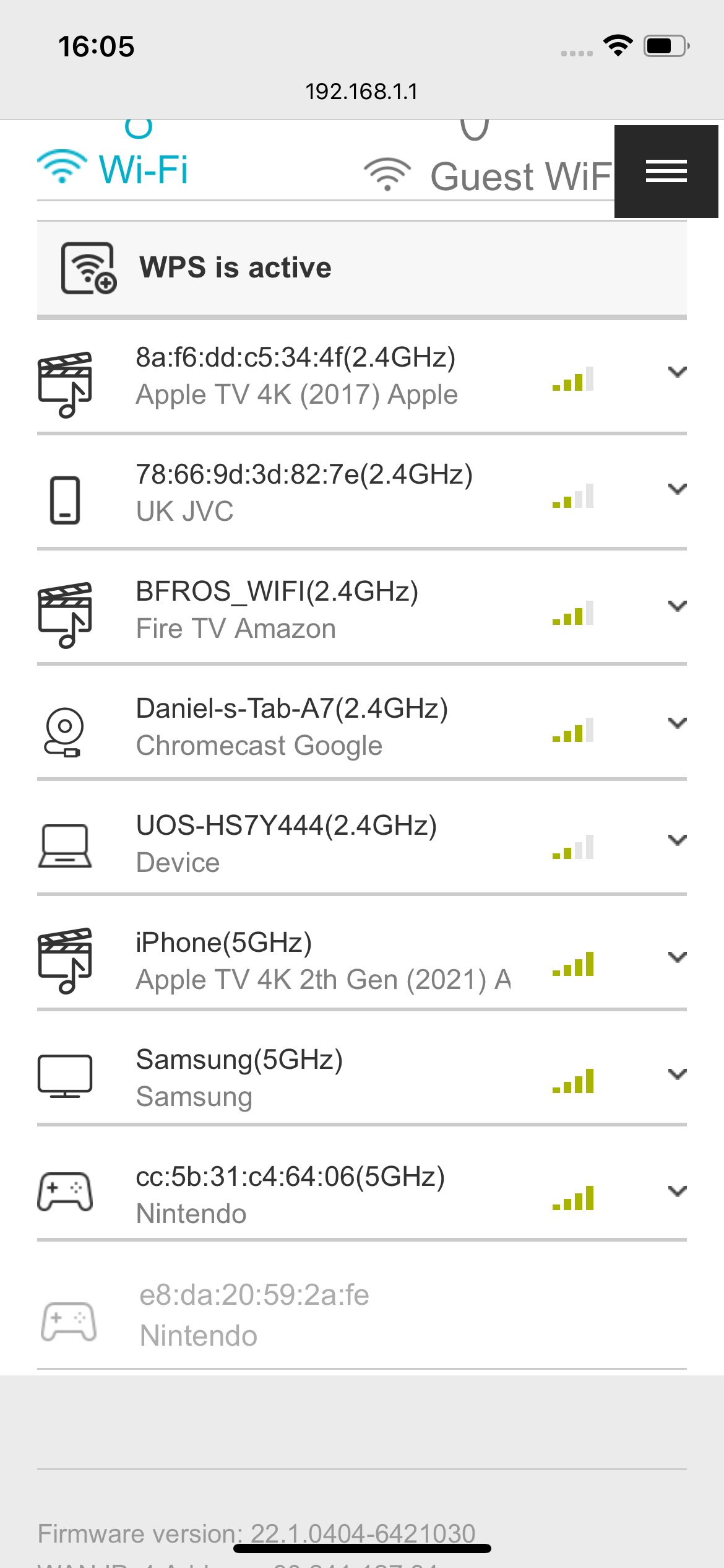

Pocster Posted December 8, 2024 Share Posted December 8, 2024 15 minutes ago, Dan1983 said: Yes screen shots were from the NVR Do you need a screen shot of the router list? Yes please Link to comment Share on other sites More sharing options...
Dan1983 Posted December 8, 2024 Author Share Posted December 8, 2024 Link to comment Share on other sites More sharing options...

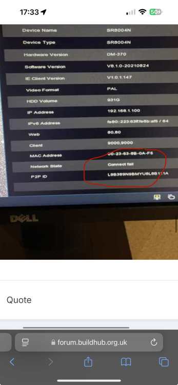

Pocster Posted December 8, 2024 Share Posted December 8, 2024 That it ? The entire list of connected devices ? This says connect fail yes ? It’s going to something very simple but really hard without being hands on to fix . Undoubtedly an IP type addressing issue Link to comment Share on other sites More sharing options...
Pocster Posted December 8, 2024 Share Posted December 8, 2024 Can you show me the ip address of any of those devices listed ? . Any one will do . Link to comment Share on other sites More sharing options...
Dan1983 Posted December 8, 2024 Author Share Posted December 8, 2024 Yes says connect fail I'm afraid I’m out at the moment, will try and sort the above when home Many thanks for the help on this, hopefully simple, the strange one is only one camera showing on the system, the other 2 must have power as red lights are on when looking outside 1 Link to comment Share on other sites More sharing options...
Dan1983 Posted December 9, 2024 Author Share Posted December 9, 2024 Please see attached info for a couple of the devices on the list Link to comment Share on other sites More sharing options...
Pocster Posted December 9, 2024 Share Posted December 9, 2024 Can’t see anything obviously wrong tbh . I was hoping for a different ip address range for nvr from your router - but they seem correct . Link to comment Share on other sites More sharing options...
