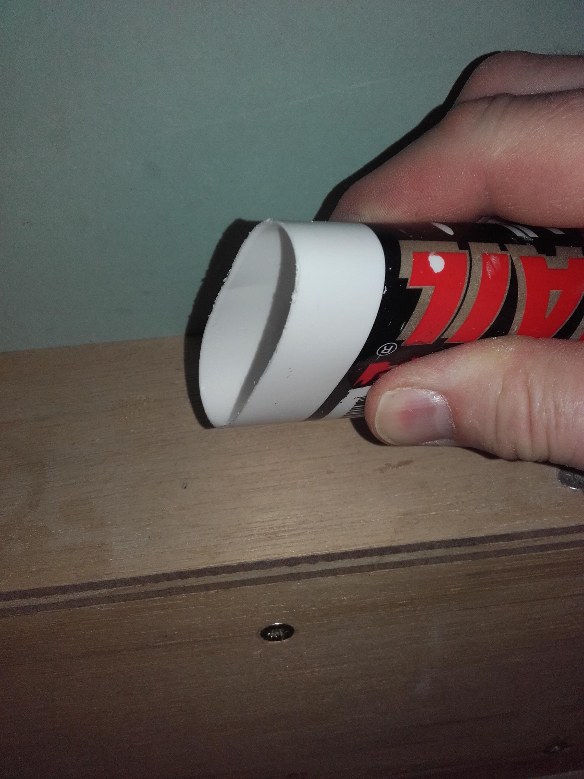

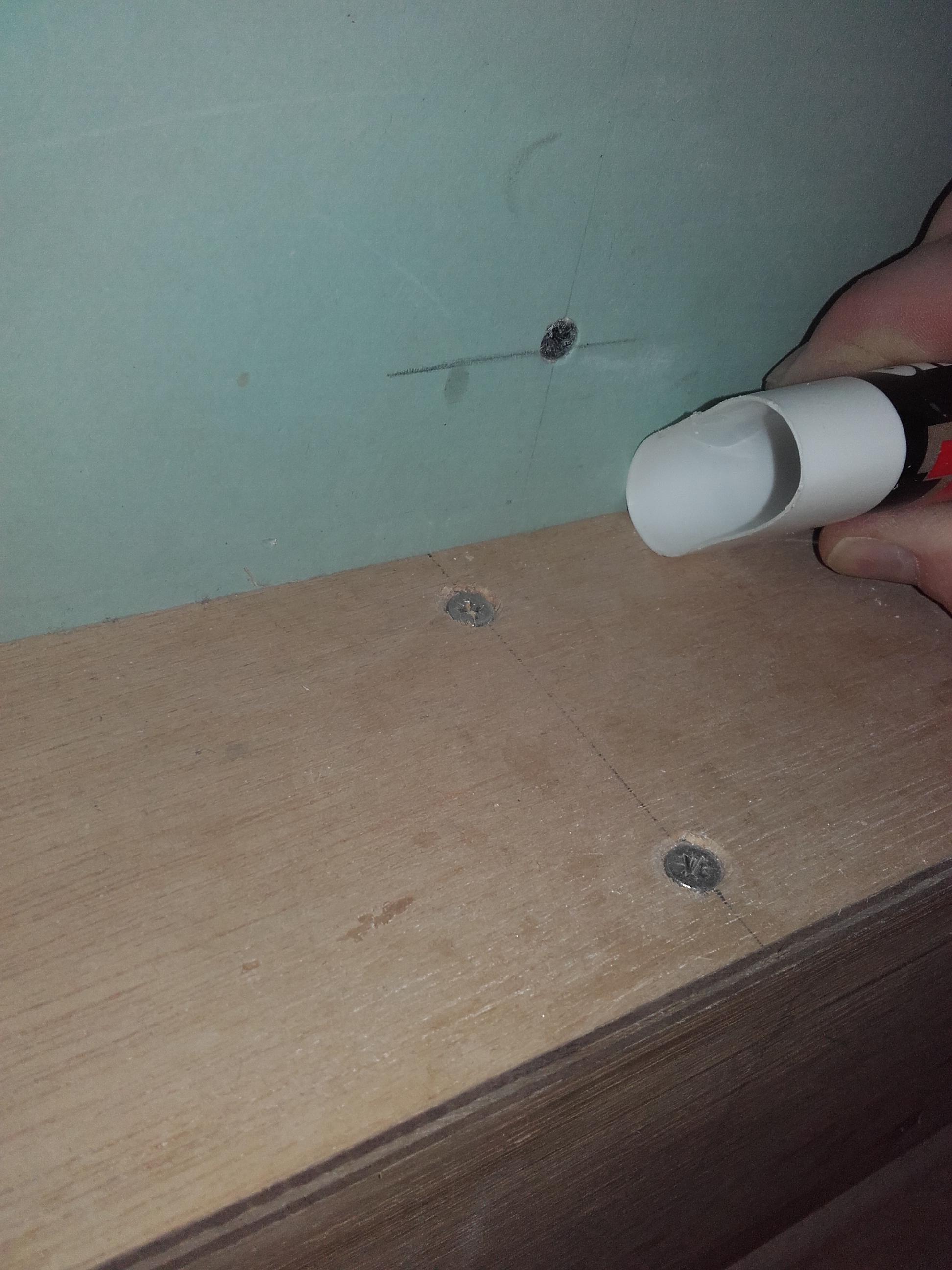

Onoff Posted October 29, 2017 Posted October 29, 2017 Special tool? Nah, don't bother. On a long run like that an EMPTY silicone tube is what you want. Put a drop of Fairy in a jug with some water. Cut the end off the silicone tube SQUARE. None of that 45deg b@llocks. Flatten the end a bit and dip the in the soapy water. Go along your silicone and it leaves a lovely neat filet. Excess collects in the empty tube. Periodically re-dip in the water: Maybe I'll do a video! Taught to me by a Moldovan commercial glazing fitter. 2 1
