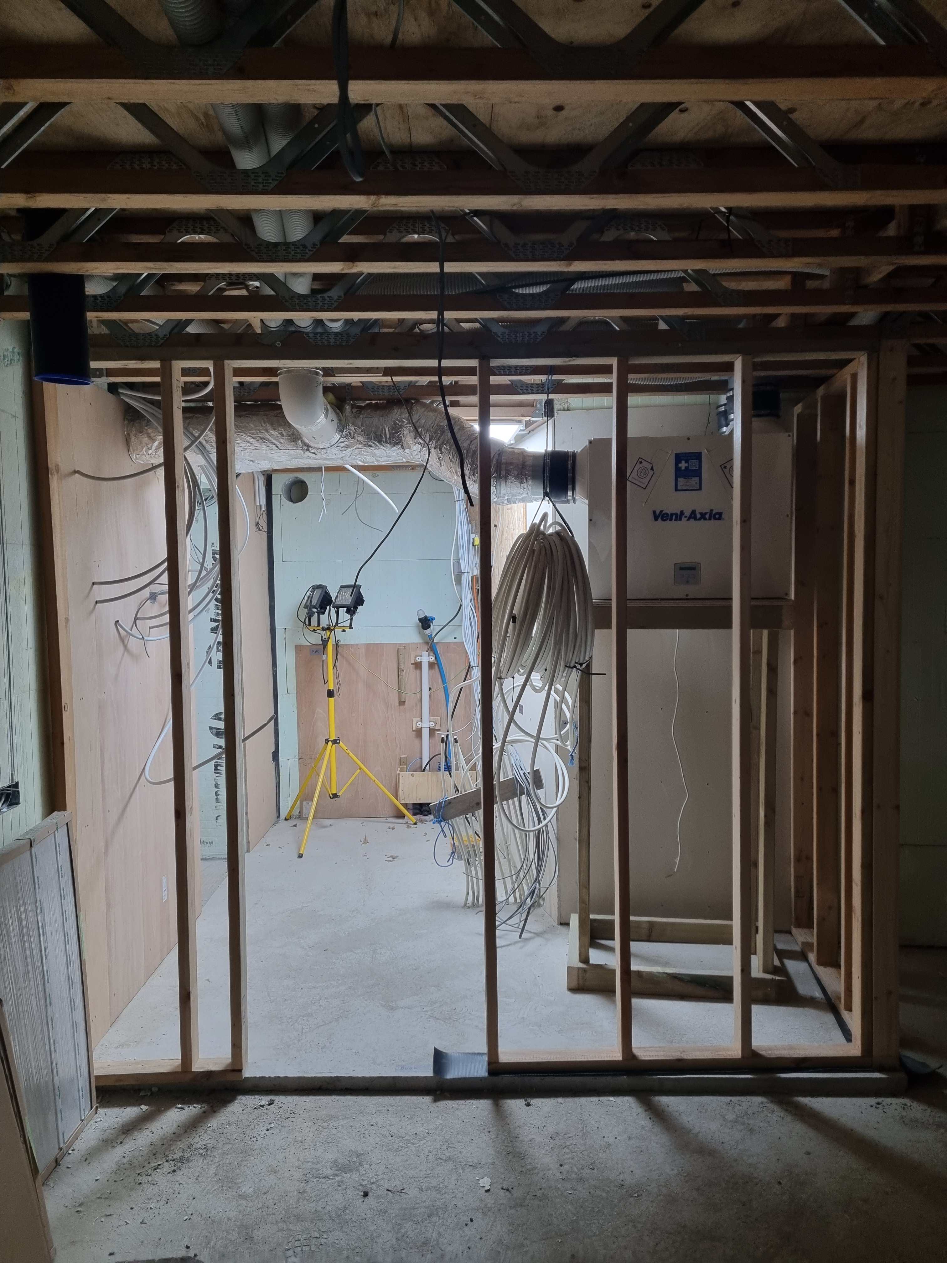

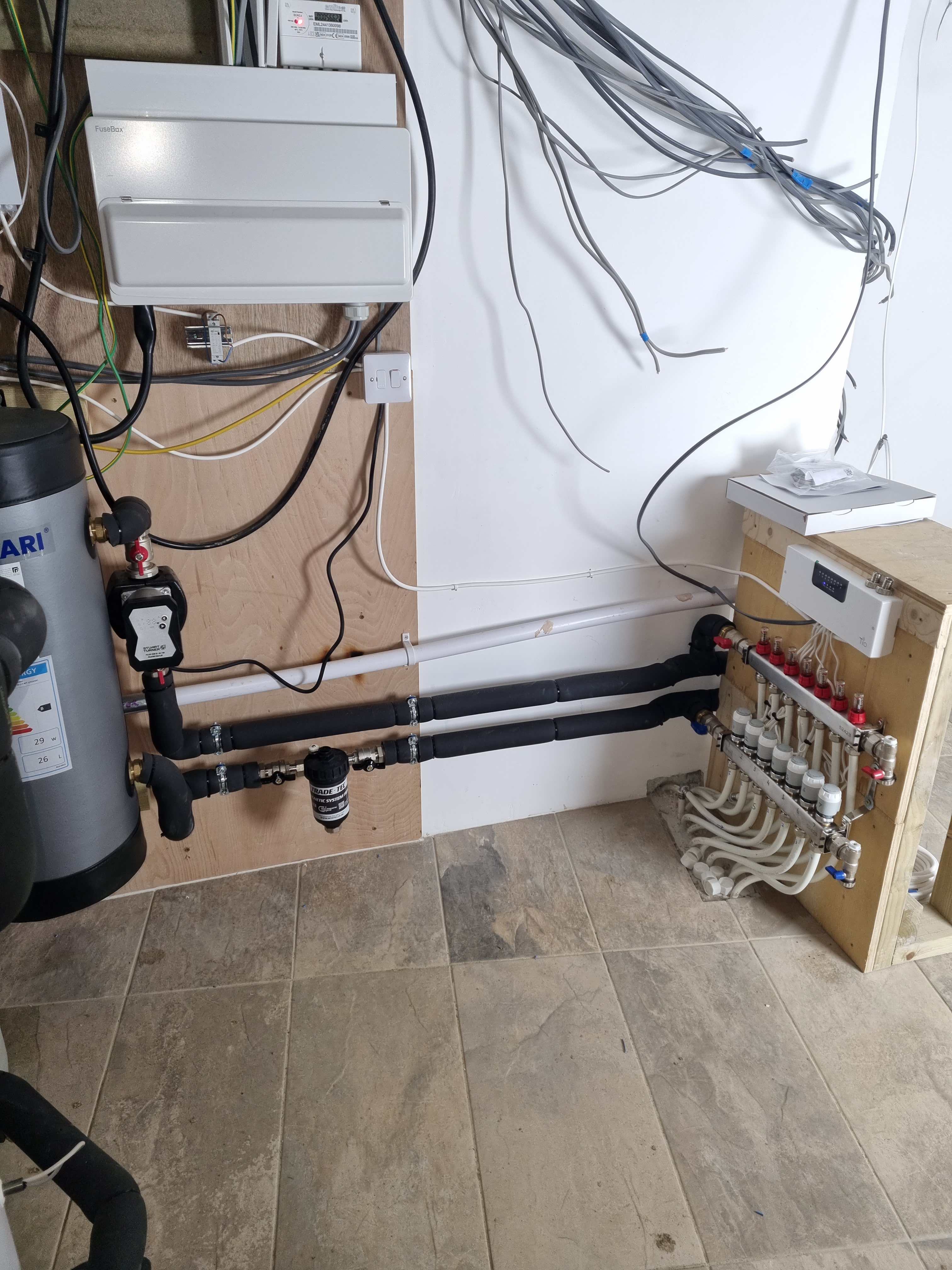

Plant room size - big enough?
What’s going in there?
Mine will be about half that for ASHP cylinder and solar batteries, inverters, etc.
On 12/08/2024 at 16:24, BotusBuild said:
How big is it? What's going in there? Have you planned it out?
It was a rhetorical question 😁
But answer your Qs:
Yes it's been planned.
HWC
Buffer tank for UFH

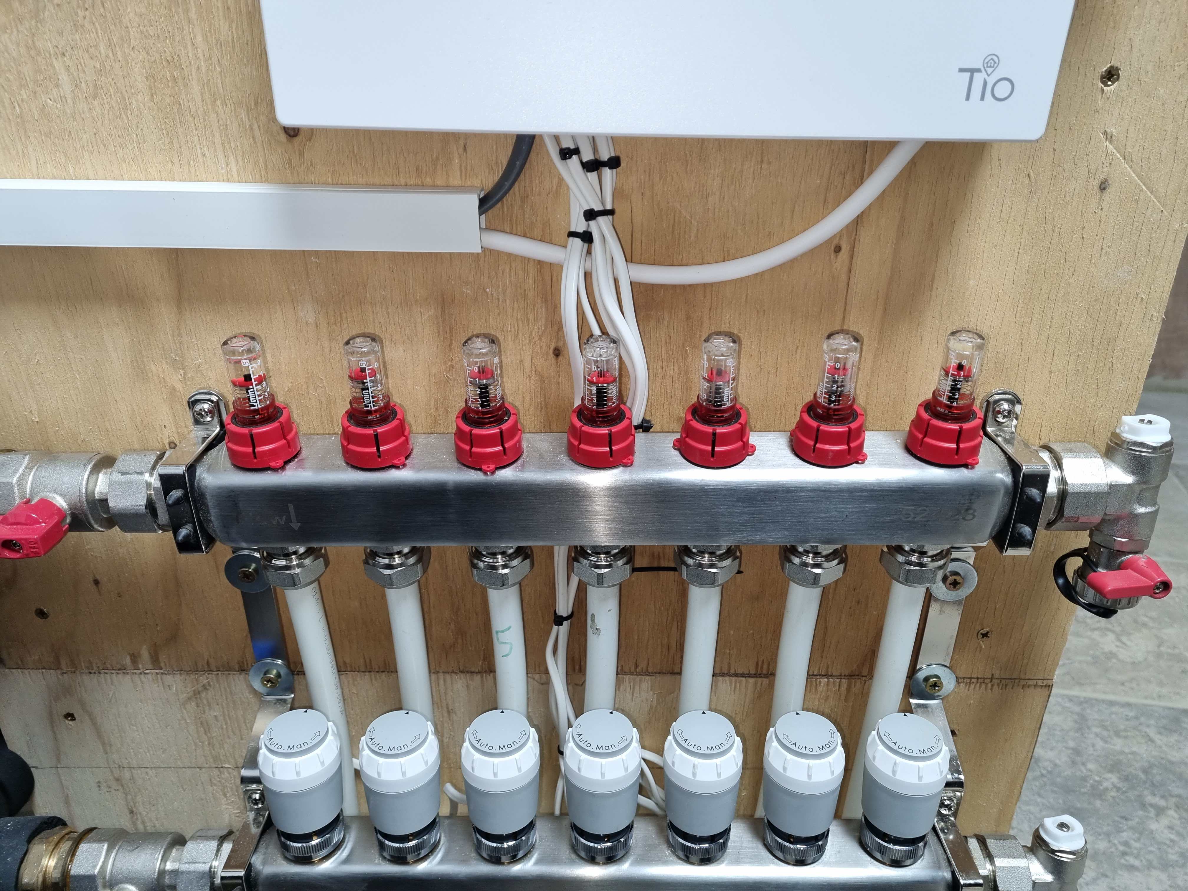

UFH manifold for lower floor
The electrical CU's
A comms cabinet
The MVHR (already there on the right)
H & C manifolds ( to those pipes on the left)

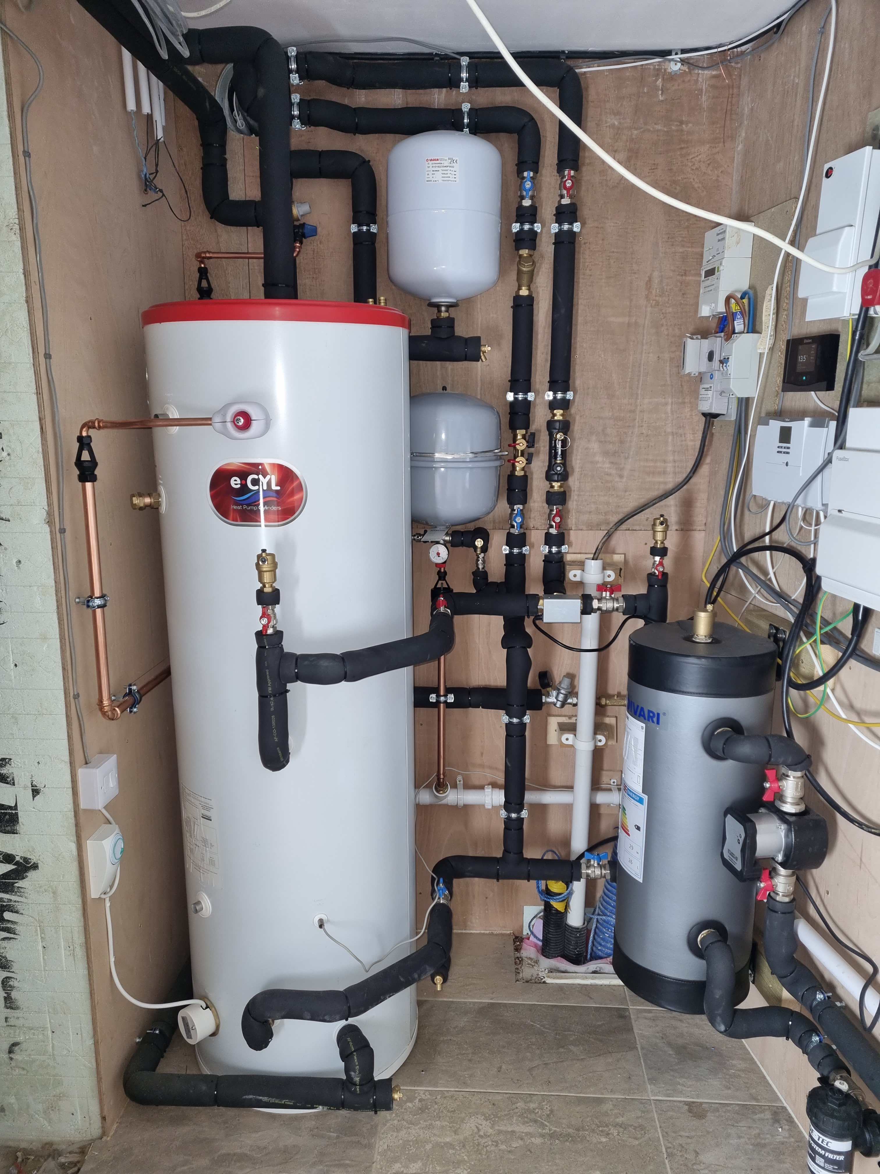

Mine is a 0.8 × 1.4 m cupboard off the downstairs loo. 🤣  The electrical panel and OSO UVC (a later SunAmp replacement) are in the utility.  The MVHR is in the loft floor drying / storage room.

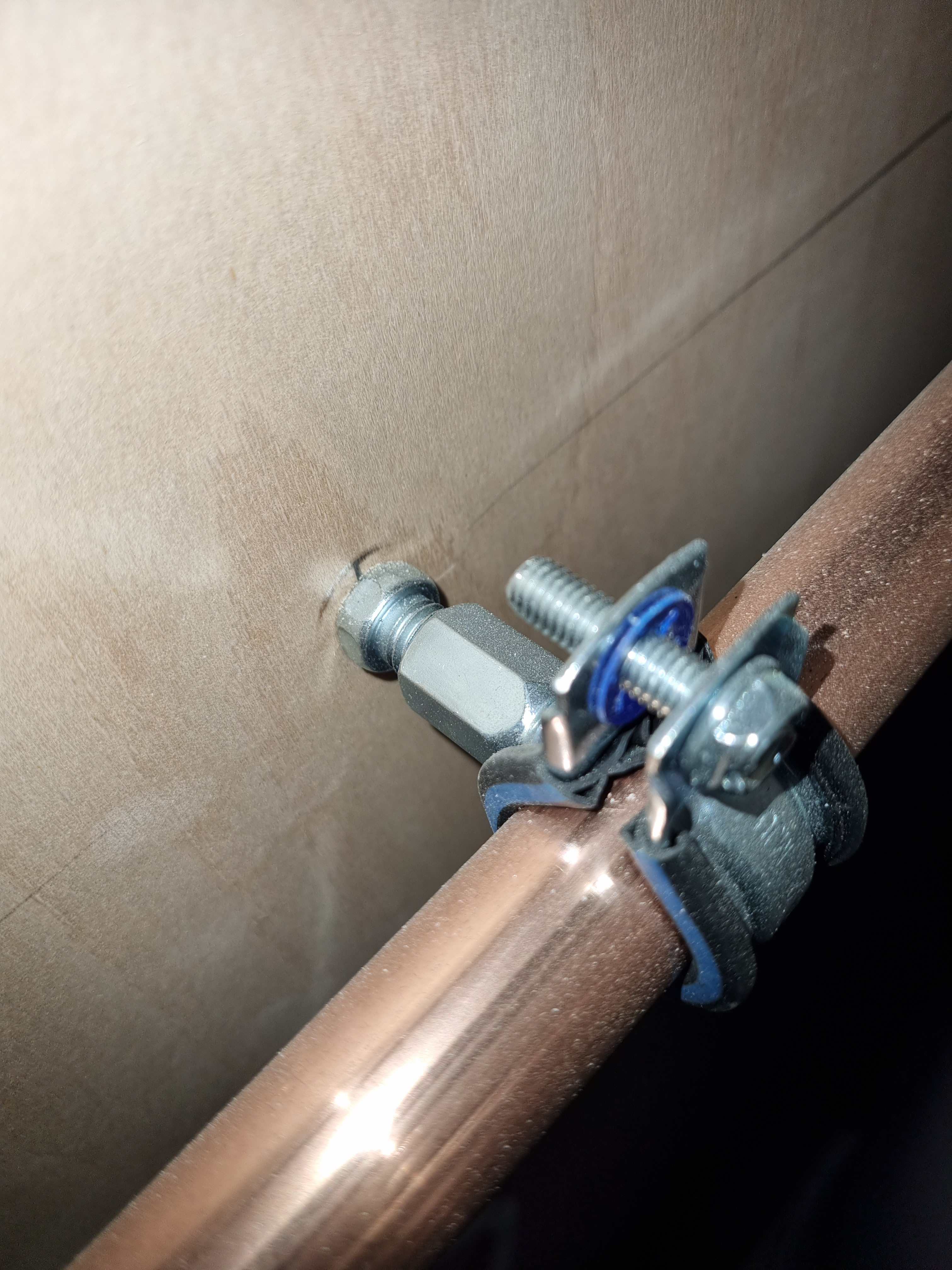

Same as the one you can see clearly at the front - metal clip with rubber
2 hours ago, Nickfromwales said:
These bad boys ;)
That is what I thought but zooming in you can see that it is not - looks like either nutserts, see below, or a bolt with the head on the wall side of the board, which is why I asked.
Ah, yes, more zooming-in for me from
now on lol.
It wouldn’t surprise me if the threaded bar isn’t just wound into a slightly undersized pilot hole, maybe with a bit of mastic.
