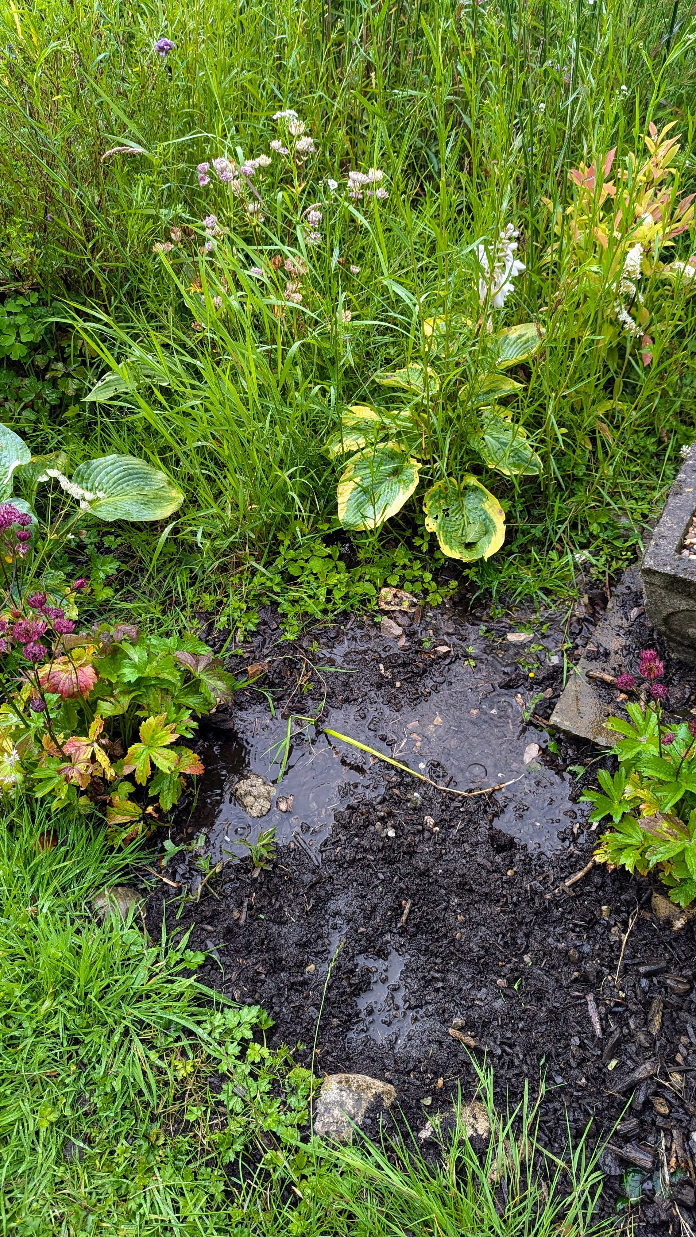

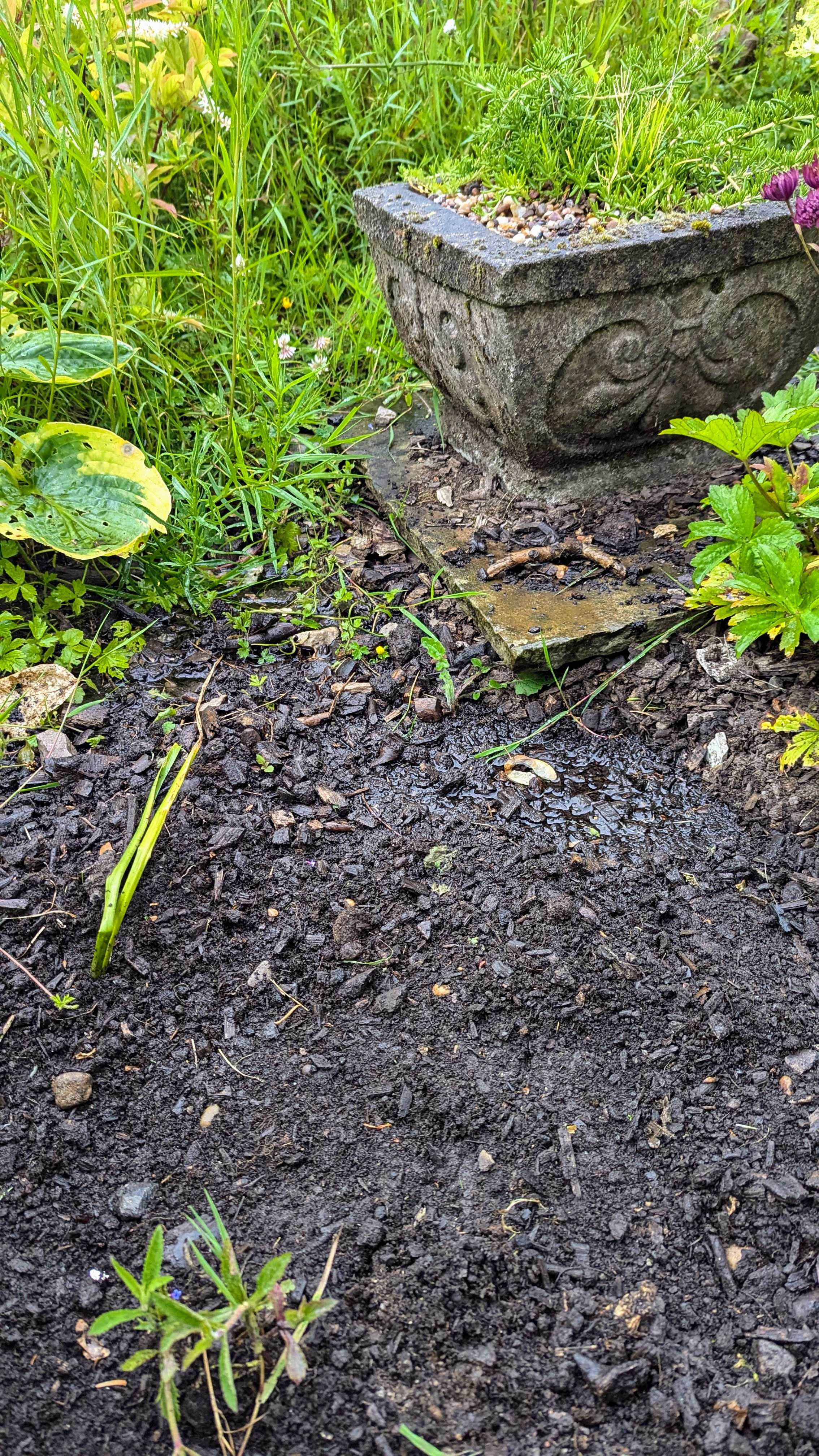

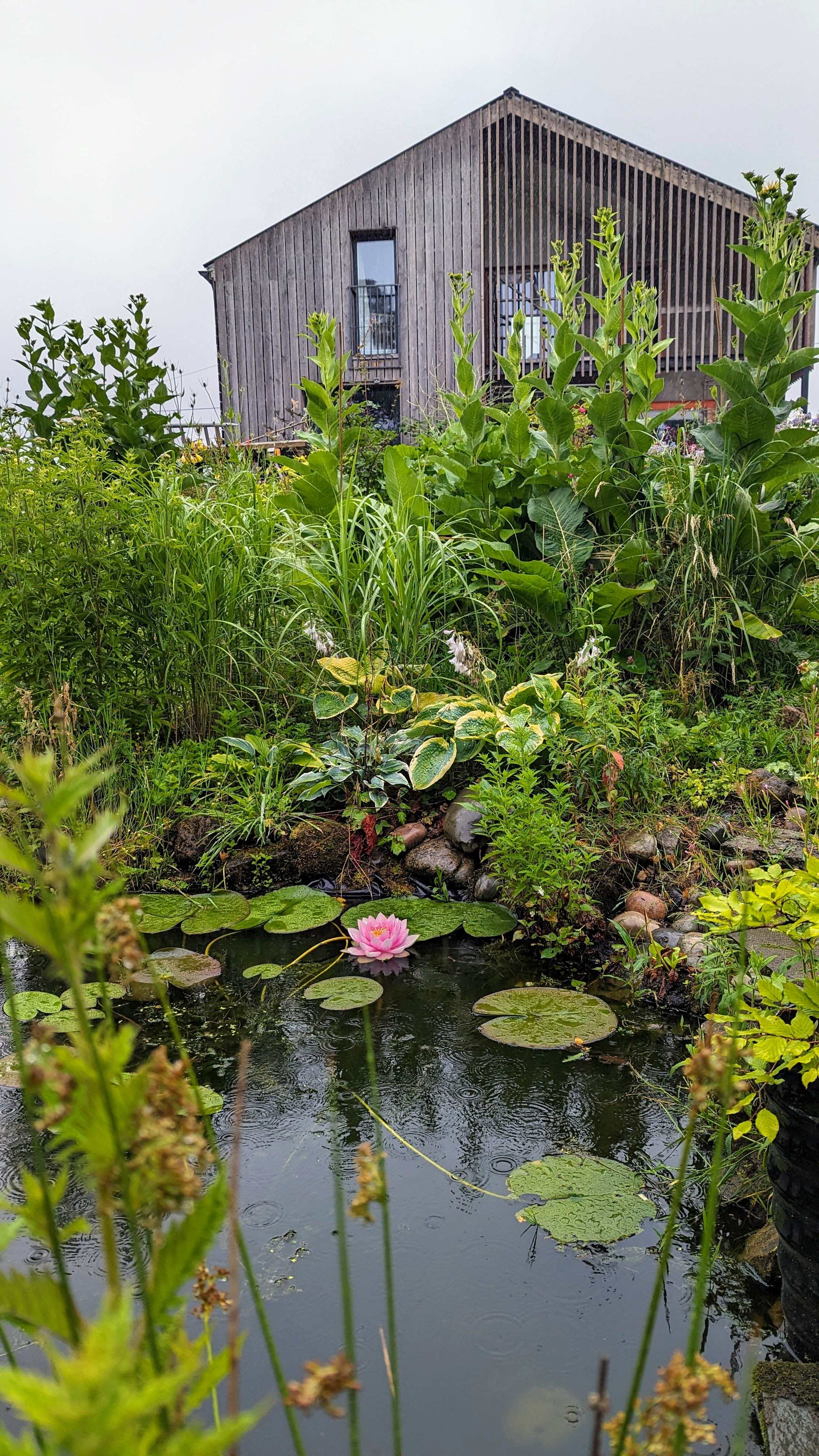

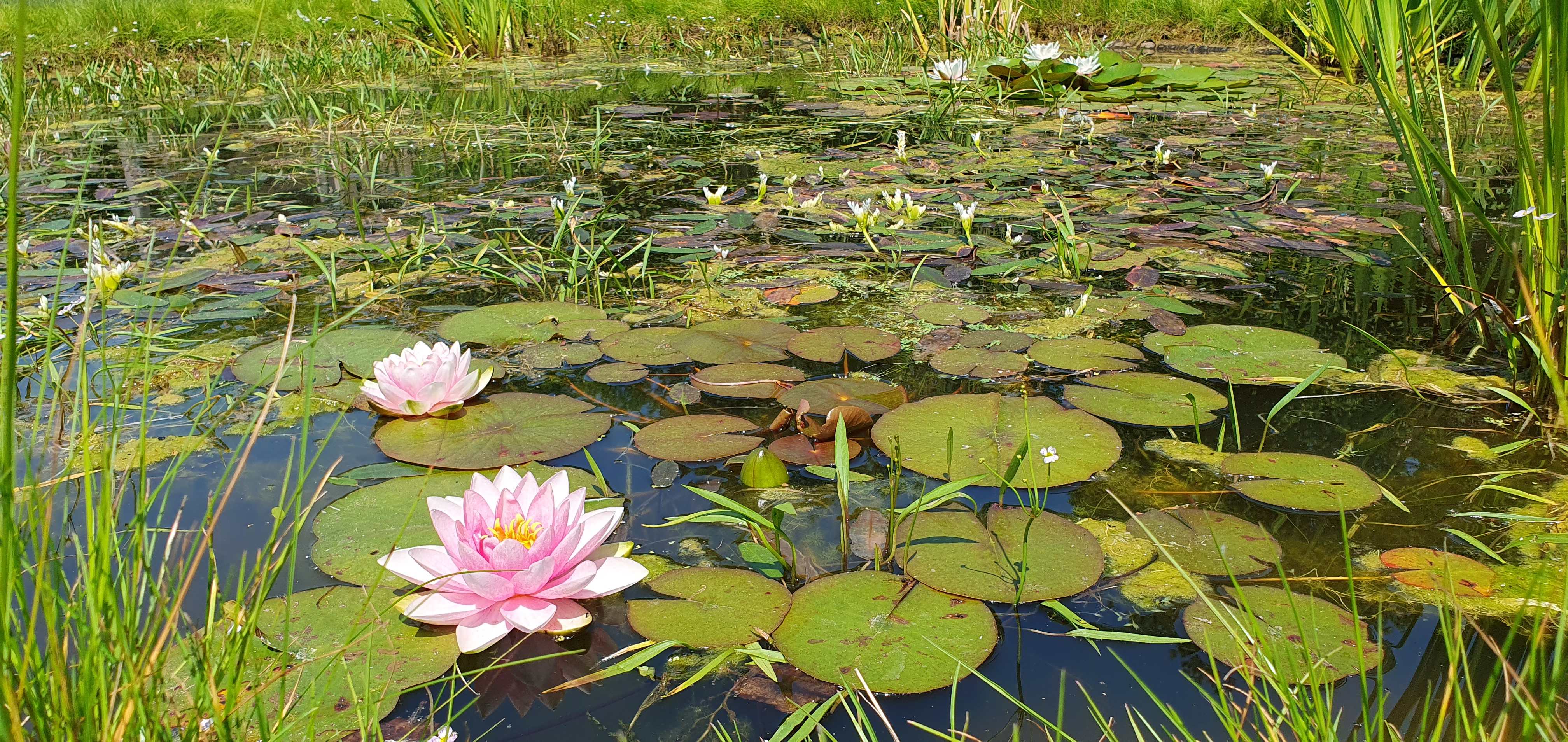

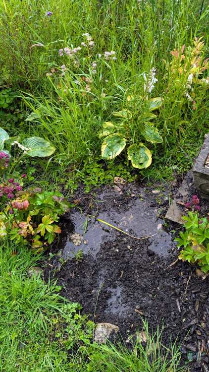

ToughButterCup Posted August 9, 2024 Posted August 9, 2024 2 hours ago, mjc55 said: Anyone done this/thinking about doing this on their plot. ... Yes. And here's what we've done..... This was all build rubble. All of the planting was done by SWMBO. I can't stand gardening. We are surrounded by GCNs - loads of them. 15 at least in this pond , and many hundreds in the 2 ponds either side of us. We named the house Salamander Cottage. Can't beat them? Join them then. The pond is fed by the rainwater from both our roofs, through a rain-garden - here's what happens during a recent thunderstorm .... The water is ducted off the roof into a sand bed - 4 tonnes or so of sharp sand - that is over-planted with water loving stuff. If there's enough rain this happens ... The rainwater pipe terminates under that concrete planter. and a few minutes later Next stop - the pond. The BCO could not have been less interested in our SUDS compliance if he had tried. But we have a healthy population of all sorts of aquatic creatures. And vast numbers of dragonflies - no idea why. The key issue for you is Planning and Sustainability . A similar 'process' simply explained in your Design Access Statement is one of the keys that could help you unlock your Planning Permission Cost? 4 tonnes sharp sand 20 meters of 110 foul drain pipe 5 tonne digger for one day Pond liner Some planning time Visit to RHS Manchester show to look at practical examples £500 max.... maybe £600 Hell of a laugh doing it: especially the grandchildren. Not sure we'll ever tell the parents what we actually got up to but during the digging out but it rained hard that day ......... among other things they got to push their grandad into a pond. No photos ..... 3

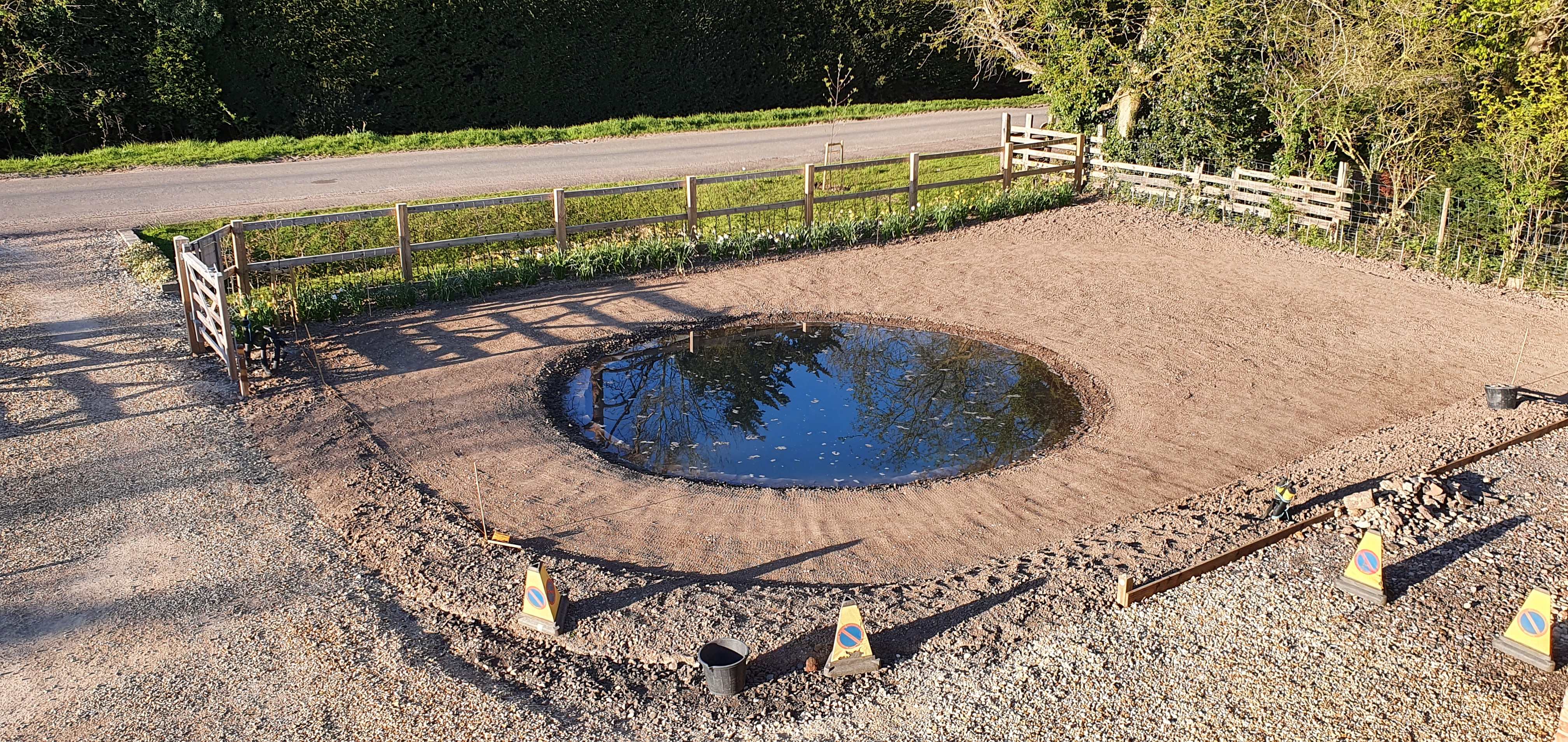

Roundtuit Posted August 9, 2024 Posted August 9, 2024 Our rainwater runs to a dyke. There didn't seem to be any advantage in putting it into a lined pond as its not going to soak away effectively, and I didn't want an unlined soakaway that dries out in summer. Also, I built it several years after moving in, so conflict with newts and house construction. April 2021 June 2023 3
