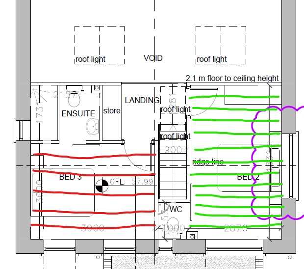

mike2016 Posted August 7 Share Posted August 7 I am planning to close off the vaulted ceilings in the upstairs bedrooms (new timber frame build) at the 2.4m height. One room is 3.4 wide and will need 12 x 175 x 44 joists, the other is 4 meters wide and needs 5 x 225 x 44 joists. The first room is fine but it's the second with the longer span that the joist height squeezes any useful storage space as it has an ensuite blocking some of the available space to contend with. I was hoping Pozi Joists, i-joists or Glulam would be available to reduce the height of the joists a bit but they are all 200mm deep at a minimum. I could reduce the joist depth to 200 or less but for that span if someone does put a load of books up there the deflection could cause issues / be unsafe. I could try splitting the span with a joist at 90 degree midway but there's only 2x4 stud at one side to support this whereas the other is structural. Question is - can I get away with a smaller joist if it's not habitable, storage only and to support a person crawling around? No water tank etc. Or just state NO storage here please and have limited flooring to discourage it. Might fit a Xmas tree but that's it! The other question is I plan to use a ledger board at either side with joist hangers, are there any good guides / specs for this & nails etc online? I could get an SE but it's a bit overkill for the use it will be put to. Open to advice on this though. Thanks! Link to comment Share on other sites More sharing options...

mike2016 Posted August 7 Author Share Posted August 7 Thought it would be echo'y and while I have a shed storage is always handy. Also I've to fit a MVHR system up there - the ducting will be going out the gable end in the left room with the unit situated in the "hot press" on the landing. Big 210mm pipes. I can box these out a bit but have to keep 2.5m separation when they exit the building if possible - off the left hand side. There is a major road 2 meters off to the right of the house blocking that path. Worth considering though, will have to have a think about the ductwork..... Link to comment Share on other sites More sharing options...
JohnMo Posted August 7 Share Posted August 7 (edited) 10 minutes ago, mike2016 said: Big 210mm pipes. I can box these out a bit but have to keep 2.5m separation To need 210mm pipes your house must be huge? Use a directional terminal on the wall, these have the inlet and outlet pipes next to each other. Zero separation required. Use coanda supply nozzles, these can be situated anywhere in a room near the ceiling and air follows the ceiling for quite a few meters before coming down. So assuming you have the unit in the landing cupboard and ensuite ceiling is flat. Bed 3 duct would go over ensuite and out of the wall, bed 2 could have the supply nozzle above the door. Edited August 7 by JohnMo 1 Link to comment Share on other sites More sharing options...

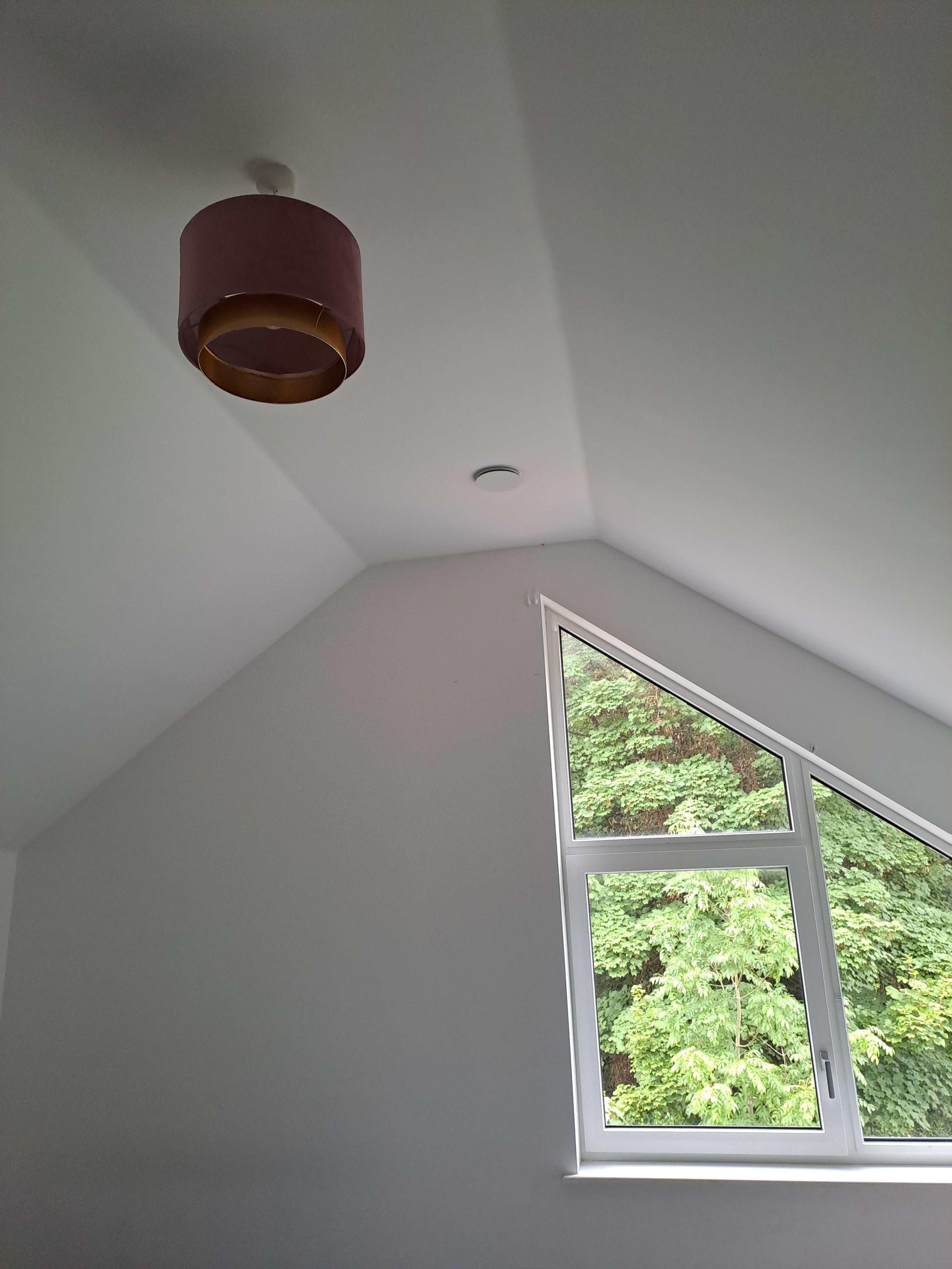

Conor Posted August 7 Share Posted August 7 This is our master bedroom. We put in a ceiling 200mm below the ridge beam to allow for services. Still gives us 3m ceilings. 1 Link to comment Share on other sites More sharing options...
mike2016 Posted August 7 Author Share Posted August 7 One problem is the neighbour fitting a wood burning stove and the chimney is closest to the ensuite, was hoping to place the intake closer to the front of the house where the prevailing wind would better clear any smoke from entering the system if it gets blown down the side passage between the two houses. Also have to fit two manifolds somewhere or push the MVHR unit downstairs. That 210mm is the insulated pipe diameter, it's smaller inside. Will have a look around the space later and make a decision. Will probably put joists in Bed 2 as it's only meant to be used as an office and not rented out (unless I blow my Budget!) and that will give me storage. As for Bed 3, full ceiling gives me the most options with ducting, it's always push here and it sticks out there with houses isn't it?!! I like the idea of the mid ceiling though but the intake would be obvious that way unless I bury it in the wall somewhere, ah decisions, decisions!! Link to comment Share on other sites More sharing options...
ProDave Posted August 7 Share Posted August 7 We have a frght mixture of upstairs ceiling heights. The whole roof structure is hung from ridge beams so all rooms could be vaulted right to the ridge if wanted. But we only did that with one room, which has a mezanine above the adjoining small bedroom. Landing and bathroom we did a normal 2.4 metre ceiling to give us a just about standing headroom bit of loft space. And the master bedroom we did with a 3M ceiling height still giving us a feeling of most of the available height, while giving a further bit of crawling height loft space access via a step up from the main loft. If you want smaller joists to preserve headroom why not fit more of them at 400mm centres or even closer? At 400mm centres I used just 12mm OSB as the loft flooring to preserve headroom. 1 Link to comment Share on other sites More sharing options...
mike2016 Posted August 7 Author Share Posted August 7 The 400mm centers is an option, just need one set wider at 600mm wouldn't I to make it possible to get up there after a turkey dinner at Xmas?! Or possibly access it from a hatch in the landing? Was using first floor spanning tables but switched to attic tables today and found with c24 I can do 44x175 in Bed 3 and 44x150 in Bed 2 which is much better. Just a bit harder to get hold of. Link to comment Share on other sites More sharing options...
