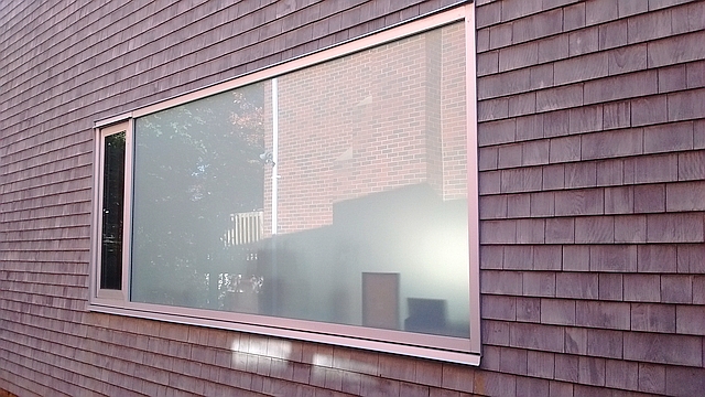

SteamyTea Posted October 28, 2017 Posted October 28, 2017 Having little to do over here, I have been walking a lot (better weather than a Cornish summer). I have noticed that nearly all the windows are set to the very front of the wall. The only ones that seem to be set a little further back are the brick places, and these were probably commissioned by English immigrants (like my family). So why do we set out windows so far back in England?
billt Posted October 28, 2017 Posted October 28, 2017 I'd guess it's because we used timber frames universally until very recently. A timber frame installed like that will rot very quickly as you'll have water resting on the top of the frame and penetrating the sides. It's much easier to minimise water penetration with traditional build methods if the window is recessed.
SteamyTea Posted October 28, 2017 Author Posted October 28, 2017 I am sure it has been discussed before on other places, but I can't remember if anyone came up with a reason. I can't see any engineering issues, and thermally it is probably better. Many of the houses have timber windows here, I would say the majority in the older parts of town. The weather here is severe, it is Atlantic coast and gets hit by tropical storms and hurricanes (46°N), temperature swings are greater, but humidity levels are similar. I suspect that it is just tradition, and that very British way of making an easy job difficult.
Jeremy Harris Posted October 28, 2017 Posted October 28, 2017 (edited) 25 minutes ago, SteamyTea said: The weather here is severe, it is Atlantic coast and gets hit by tropical storms and hurricanes (46°N), temperature swings are greater, but humidity levels are similar. My recollection is that the weather swings in winter can be far more severe over there than here. I can remember driving to work in Dartmouth, across the Macdonald bridge, in sub-zero temperatures, with ice on all the bridge decks, having heavy snow by lunchtime, then driving back home to Halifax in pouring rain with the temperature up around 10 deg C. It seemed that 15 to 20 deg C swings in temperature in a day were not that uncommon in winter, which seemed to play hell with the surfaces of the roads. My guess is that the windows may well be fitted out flush to make it easier to keep the weather out of the siding as much as anything else. As most of the houses are made of timber, the style and design has probably evolved to deal with all-timber construction, with conventional timber siding or shingles as the rain barrier. Edited October 28, 2017 by JSHarris

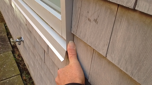

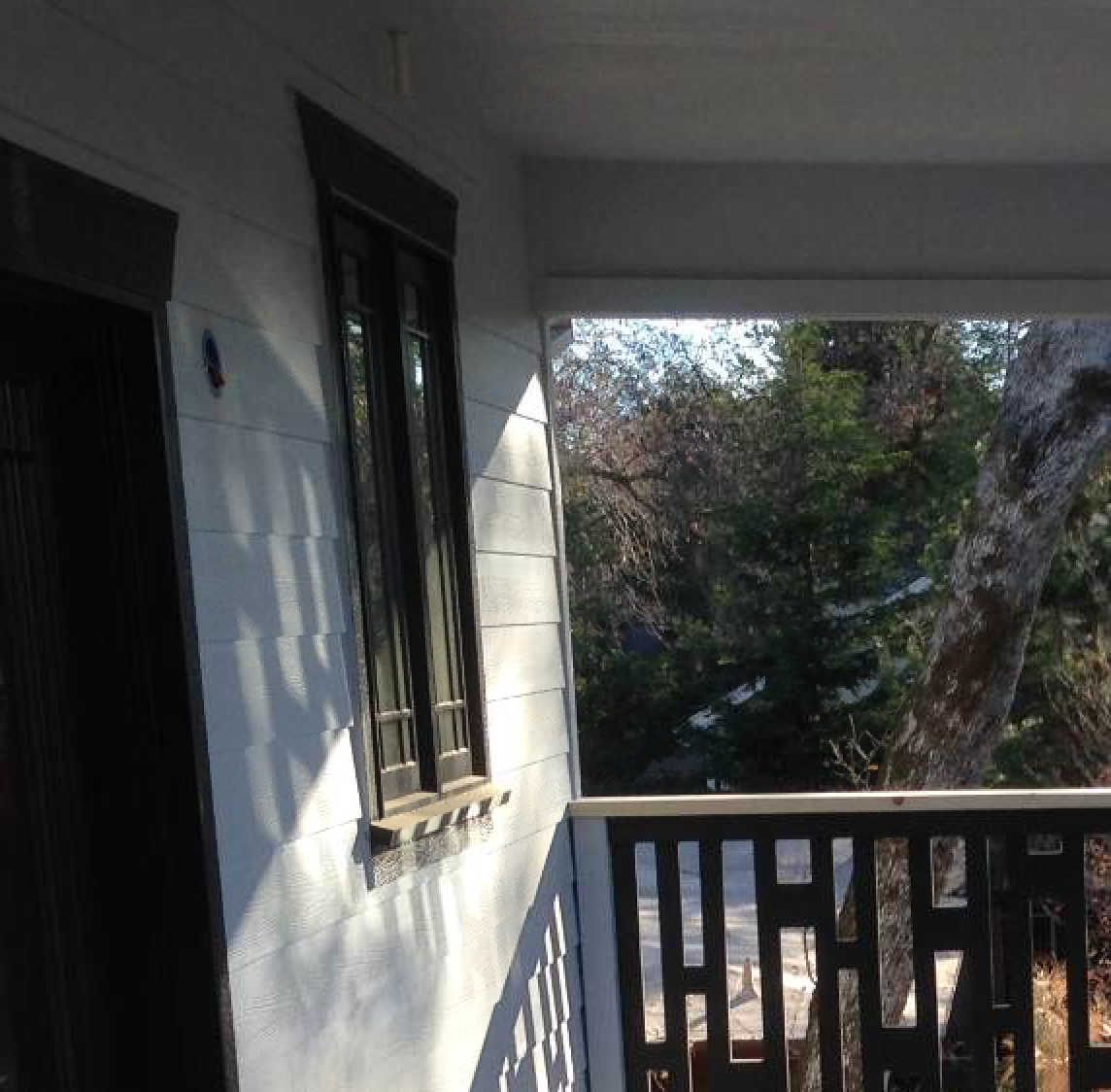

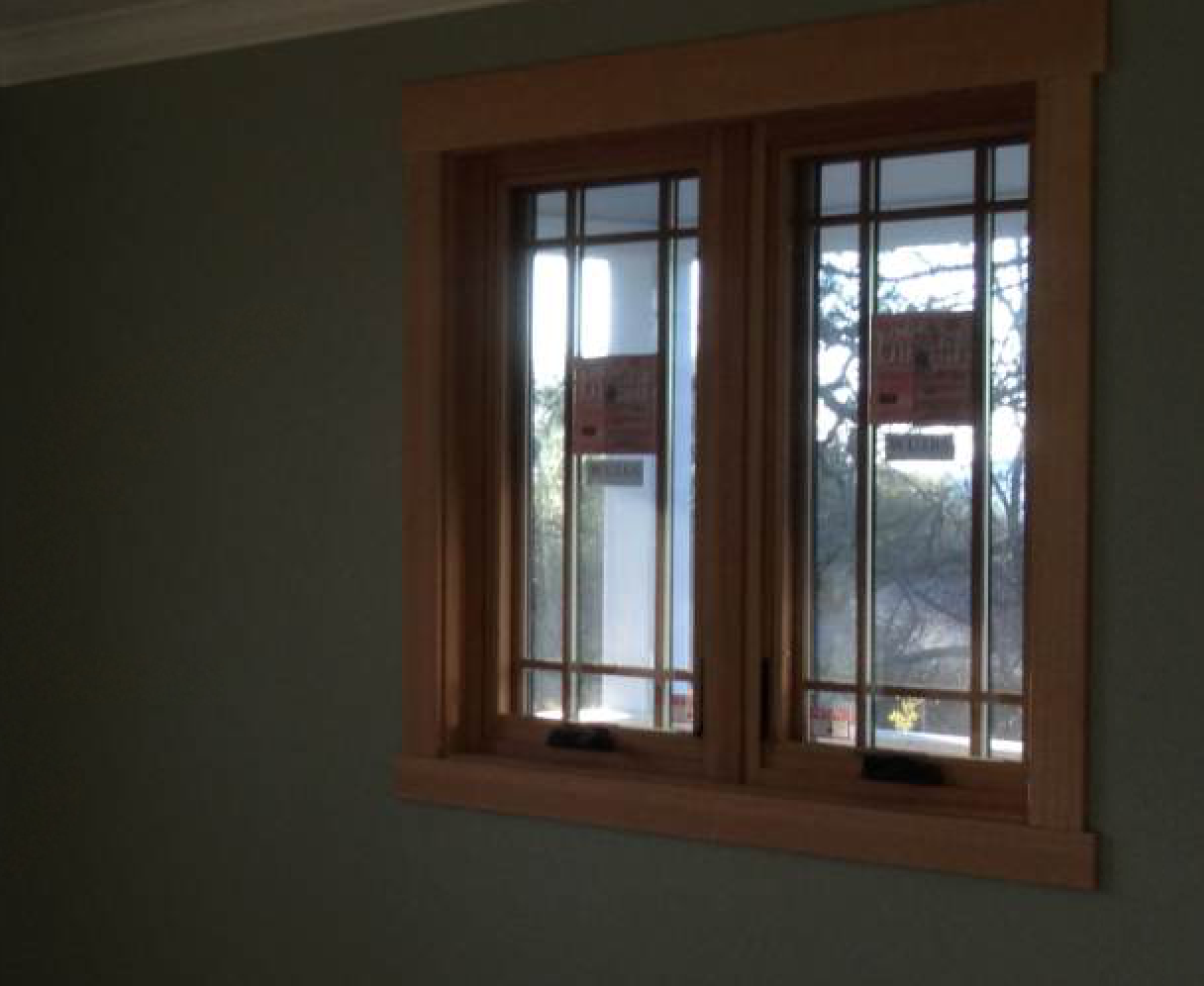

AliG Posted October 28, 2017 Posted October 28, 2017 (edited) The walls are so thin that the windows have to be flush with the outside, my in laws house outer walls are probably less than 150mm thick. Basically the walls are going in the timber frame that would be the inner layer of most houses here. If the windows were set back there would be too much risk of water getting inside the frame I would guess. I found a couple of pics from when their house was being built showing the inside and outside of a window. This is in California not Canada, it was an on site built timber frame. Edited October 28, 2017 by AliG
