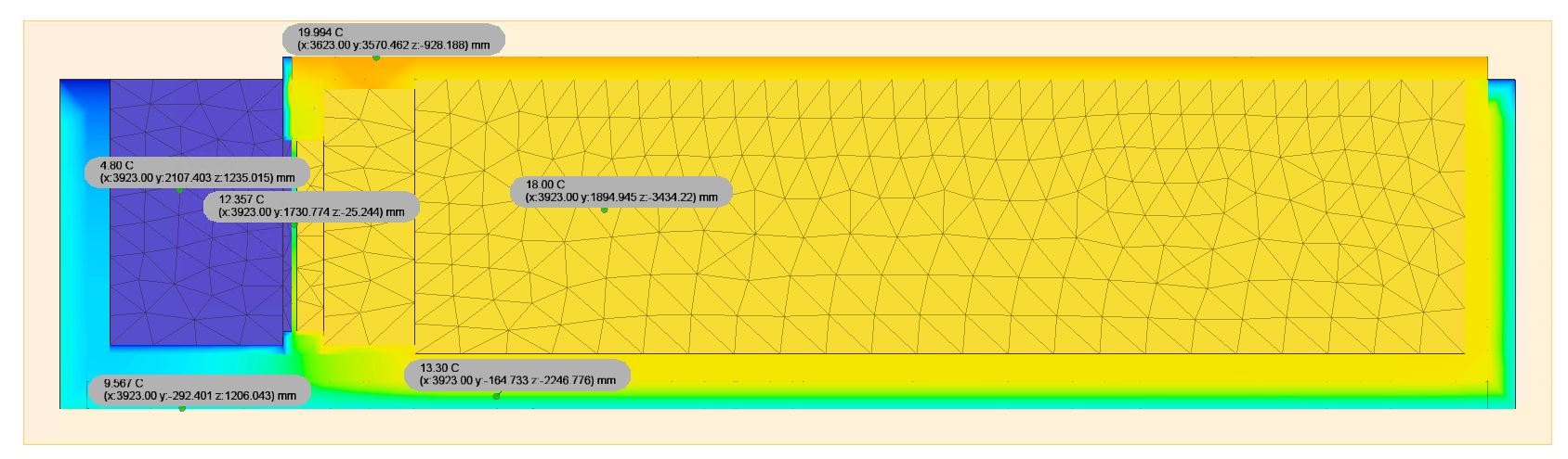

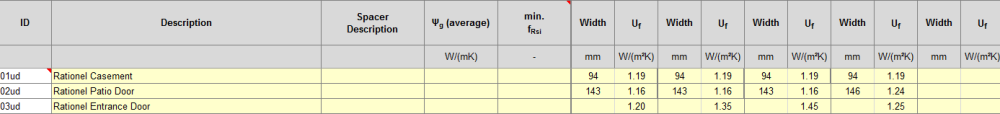

Alan Ambrose Posted August 1 Author Share Posted August 1 Thanks for that, and yes, those instructions are well written. Fusion makes some pretty temperature plots (in 3D) (see below) but doesn't do the last step of calculating total heat flow. Do you have an idea of how well the standard details match real cases? Presumably if they work for standard modern estate builds they're a 'bit high' for better insulated designs. I see from the doc that the BRE have doubled some of the numbers between SAP 2012 & 10. They say part of the rational is to encourage people to do their own calcs. Well great if that was easy. Re: windows I found that e.g. Rationel publishes U-Values and psi-values. I assume other suppliers do the same although I have not looked. How reliable are they - anyone's guess. Link to comment Share on other sites More sharing options...
Dan F Posted August 1 Share Posted August 1 (edited) @Alan Ambrose Remeber that the SAP and PHPP calculations are different. One uses internal measurements and one uses external, also the boundary conditions and/or external temps might be different (can't remember). I've seen defaults of 0.040 used as slightly conservative a number for(presumably good spec and well installed) windows and 0.1 used for thresholds. Great installation and this could be less though, and if you have a blind system or poor insulation this could be more, but I think those are good starting points. If rational publish psi values then that will be based on assumptions about the installation situation and fabric make-up, so may not be accurate or valid. Also need to check if rational numbers use SAP or PHPP methodology. Window/doors installation of course aren't the only thermal bridges, you have all the building juntions too. 🙂 Edited August 1 by Dan F Link to comment Share on other sites More sharing options...

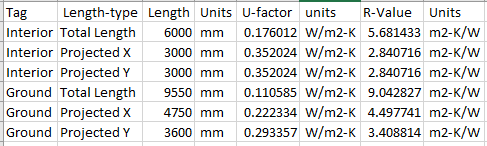

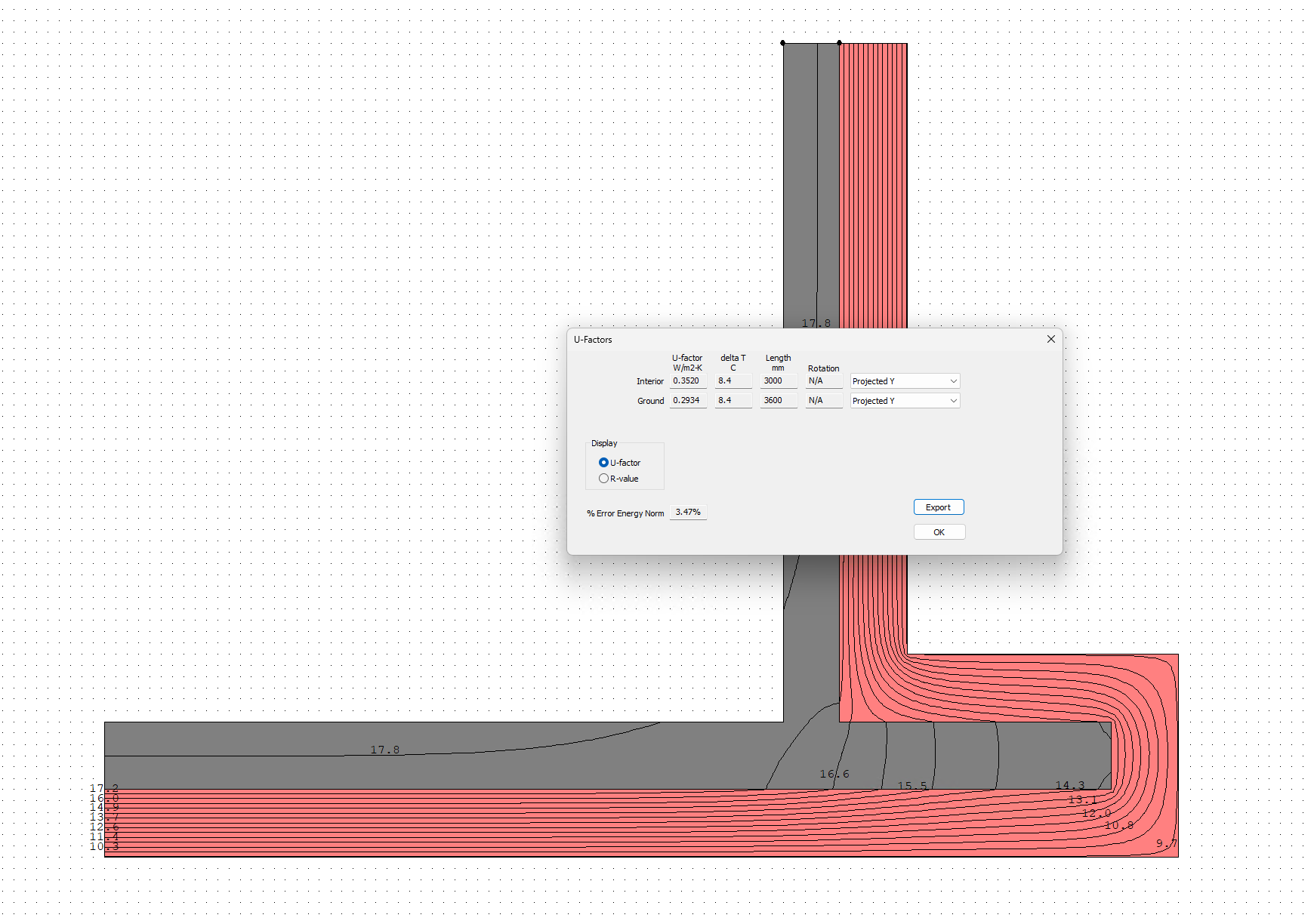

Alan Ambrose Posted August 6 Author Share Posted August 6 OK some progress. Now I need to check all my inputs and back out the psi thermal bridge value... Also had to trace my dxf file for now (rather than getting a direct import). Couple of hours work so far. Link to comment Share on other sites More sharing options...
