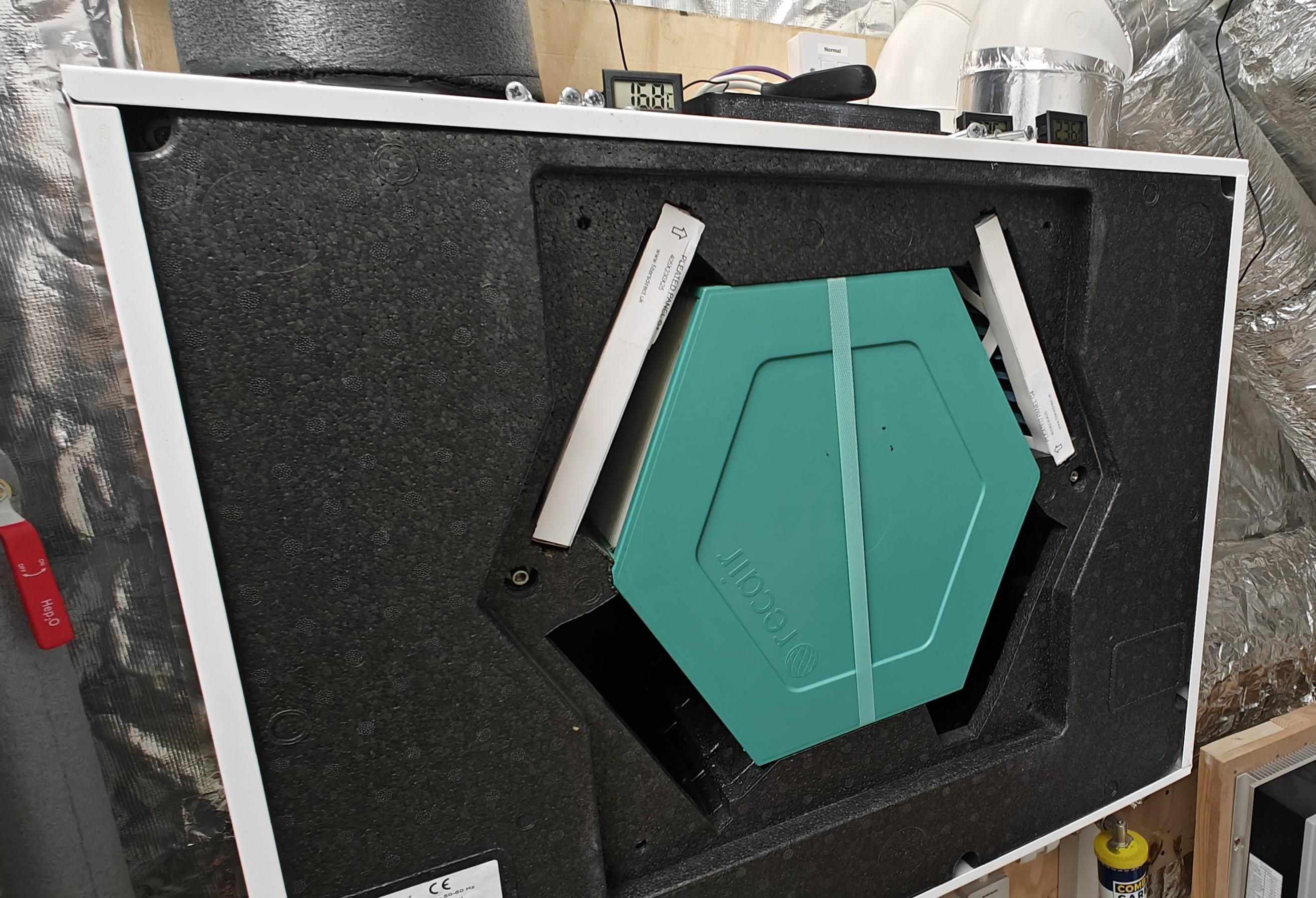

Simon R Posted July 29, 2024 Posted July 29, 2024 52 minutes ago, kevinm said: I would be skeptical of any unit making big claims and not getting PH certification. One would have thought so, but it's not universally the case. My MVHR (which I'm very happy with) is the Blauberg SB-550. It does not have PH certification, the SB-350 does. Given the unit efficiencies are the same, I asked Blauberg why the 550 unit was not PH certified. The reason is cost, they sell far more of the 350 units and could not justify the cost of certification on the 550. True you don't need to have all your components certified to get PH certification, but it's probably a whole raft of pain to use units which are not certified. Our house meets PH requirements and comes in at less that 15kWh per metre per annum. I'm in no rush to get certified, but very grateful for all the work that has been put into PH design.
JohnMo Posted July 29, 2024 Posted July 29, 2024 We have two Titon units neither are PH certified, there is nowt wrong with them. Could quite easily have chosen a PH certified one from Titon, but it didn't suit out needs flow rate wise. 1 hour ago, kevinm said: Most high-performimg MHRV units have PH certification now, I would really doubt that.
kevinm Posted July 30, 2024 Posted July 30, 2024 17 hours ago, Simon R said: One would have thought so, but it's not universally the case. My MVHR (which I'm very happy with) is the Blauberg SB-550. It does not have PH certification, the SB-350 does. Given the unit efficiencies are the same, I asked Blauberg why the 550 unit was not PH certified. The reason is cost, they sell far more of the 350 units and could not justify the cost of certification on the 550. True you don't need to have all your components certified to get PH certification, but it's probably a whole raft of pain to use units which are not certified. Our house meets PH requirements and comes in at less that 15kWh per metre per annum. I'm in no rush to get certified, but very grateful for all the work that has been put into PH design. Heat recovery drops with increased capacity, there is a strong trend to support this, look at the Zehnder/Helios/Brink units. The bigger units in a product family have lower heat recovery efficiency. The SB-350 achieves 79% heat recovery. The bigger SB-550 would be very close to the 75% minimum heat recovery requirement for PH certification. Maybe they dont want to risk the cost if they are not certain that it will pass? 17 hours ago, JohnMo said: We have two Titon units neither are PH certified, there is nowt wrong with them. Could quite easily have chosen a PH certified one from Titon, but it didn't suit out needs flow rate wise. I would really doubt that. The PH-crtified Titon looks different to all the other HRV3 machines, the filter access is different. That suggests there is more than just the cost of certification at play, looks to me like they made a special unit targeting high efficiency.

JohnMo Posted July 30, 2024 Posted July 30, 2024 2 hours ago, kevinm said: the filter access is different Same as the HRV10 I have. Basically the front cover comes off. Instead of a patch panel.

Sparrowhawk Posted August 1, 2024 Posted August 1, 2024 (edited) On 29/07/2024 at 16:25, JohnMo said: We have two Titon units neither are PH certified, there is nowt wrong with them. How do you compare their heat recovery to other units, as to me that's the benefit the PH certified MVHR units bring? There's a variation between the SAP and PHI heat exchange efficiency tests (PHI being closer to real world) which makes comparing the numbers between certified and non-certified units tricky - see https://www.heatspaceandlight.com/cheap-mvhr-expensive-heat-exchanger-efficiency/ for a discussion. Edited August 1, 2024 by Sparrowhawk
JohnMo Posted August 1, 2024 Posted August 1, 2024 (edited) 30 minutes ago, Sparrowhawk said: How do you compare their heat recovery to other units, as to me that's the benefit the PH certified MVHR units bring? There's a variation between the SAP and PHI heat exchange efficiency tests (PHI being closer to real world) which makes comparing the numbers between certified and non-certified units tricky - see https://www.heatspaceandlight.com/cheap-mvhr-expensive-heat-exchanger-efficiency/ for a discussion. It seems to have only two distinctions in the article 1. PH approved 2. Cheap brands that are poorly insulated. There is a lot of middle ground missing from the article, PH certified isn't the be all, ends all of equipment. The Titon units are neither a cheap brand nor are they poorly insulated. So missing entirely from the comparison made in the article. "How do you compare" you research, you buy cheap brands (you can pay cheap prices), make your choice, then get on with life. Inside a Titan HRV10 - a huge chunk of insulation, within a metal box, very tight fitting filters and heat exchanger. It's a huge unit and the large HE looks small but it's pretty big. Edited August 1, 2024 by JohnMo
