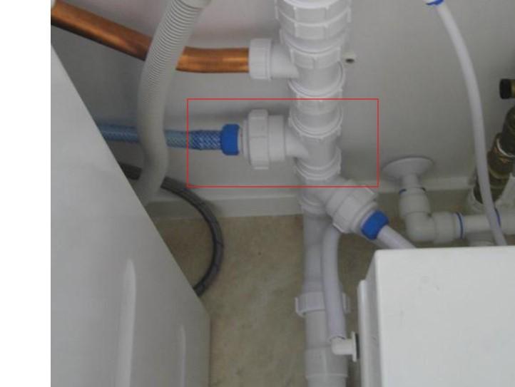

Need to connect hose pipe to waste
Hi Looking for a spigot to connect waste pipe to standard garden host.  I saw the attached photo and not sure if this is a special T and a certain spigot used or just washing machine fitting
Why? What is the “garden hose connected too”?
it is a waste for water filtration when it does its regeneration
I thought I recognised that picture from around 2018. It was cobbled together connections for the EASHP condensate and the water softener regeneration outflows. It was a standard swept T junction with threaded male end with a reducer with threaded male end. I just searched for female threaded spigots to fit the pipes I had. IIRC they were smaller than washing machine waste fittings.
