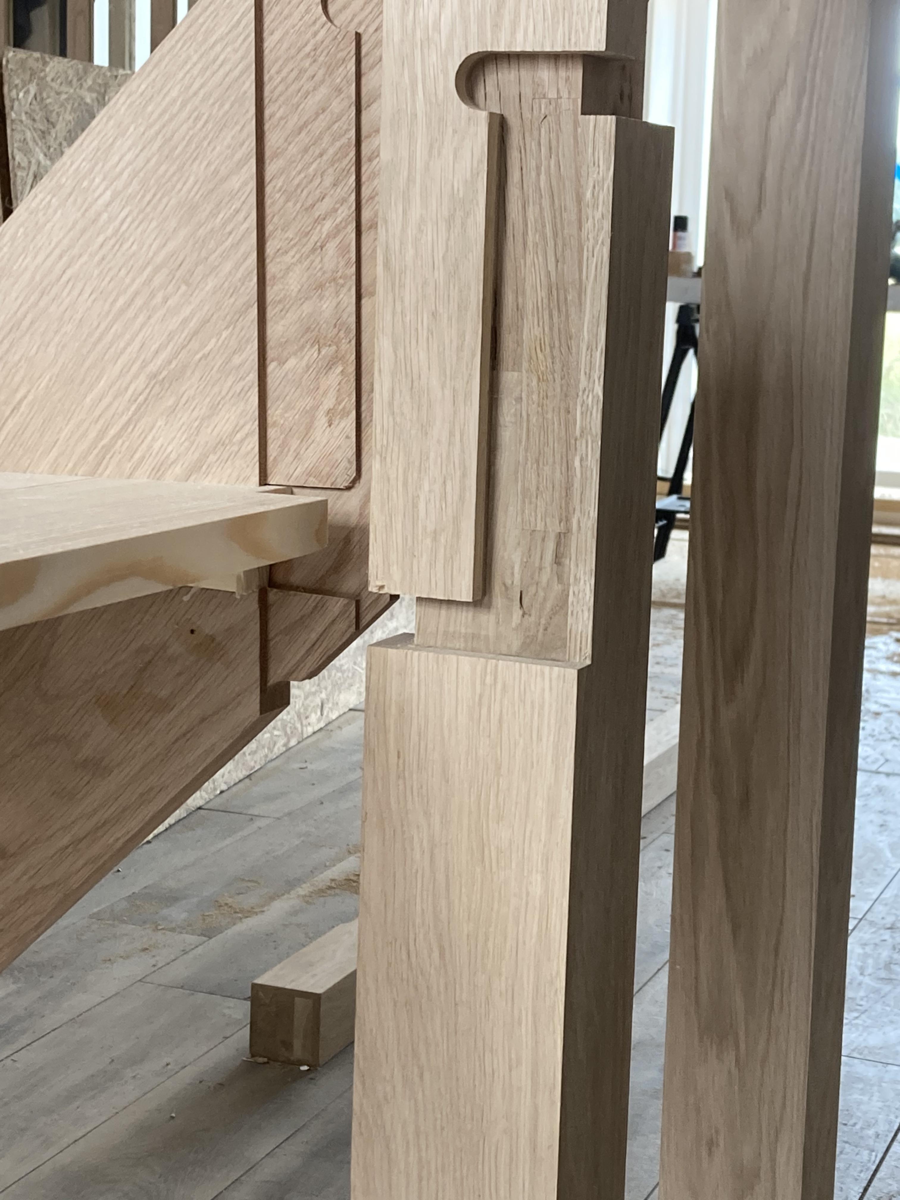

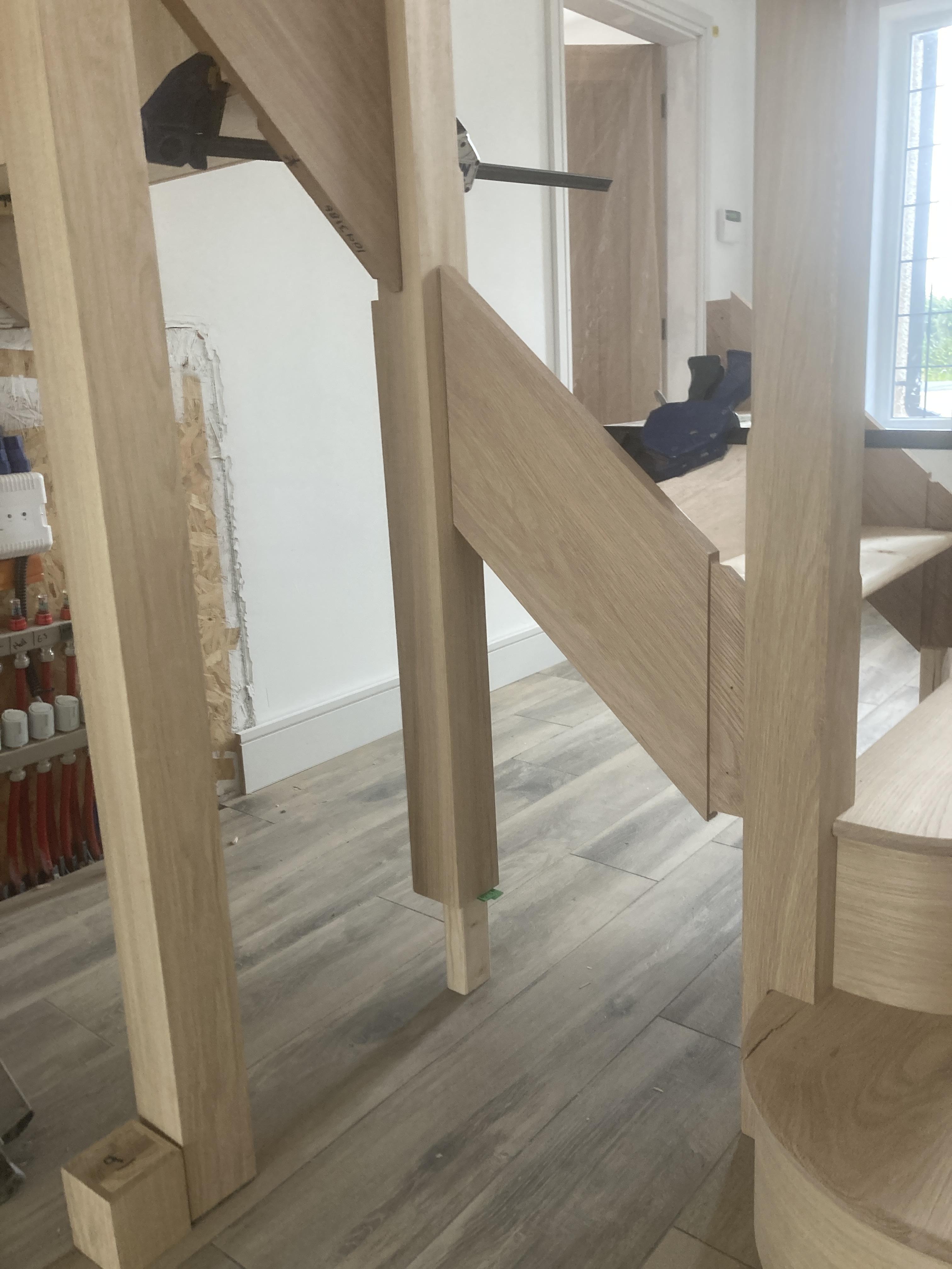

nod Posted July 7, 2024 Share Posted July 7, 2024 I started fitted the stairs yesterday Made by a company that I’ve used numerous times They have totally cocked up there calcs With at least two newel posts cut wrong and a bigger problem that 30 mil of the bullnose height would need trimming Which of course can’t be done Personally I think there’s to much reliance on cad I currently framing on a university where nothing is working to drawings Looks like half a day off work tomorrow to meet up with the stair manufacturer Moving in date is creeping up 25th of this month Link to comment Share on other sites More sharing options...

ProDave Posted July 7, 2024 Share Posted July 7, 2024 Is it as bad as you think? In your picture the bottom string looks at too high an angle (compared to the newel post it is trying to engage with) if it was at the correct angle it would be lower and the "adjustment" needed would be less. Still the manufacturers problem, unless they start throwing the "you checked the drawings" card at you (I know someone that got stung by that) Ours got the newel posts wrong as well, but thankfully that was all, and it then took them 2 more tries to get the newel posts right. Link to comment Share on other sites More sharing options...
nod Posted July 7, 2024 Author Share Posted July 7, 2024 1 hour ago, ProDave said: Is it as bad as you think? In your picture the bottom string looks at too high an angle (compared to the newel post it is trying to engage with) if it was at the correct angle it would be lower and the "adjustment" needed would be less. Still the manufacturers problem, unless they start throwing the "you checked the drawings" card at you (I know someone that got stung by that) Ours got the newel posts wrong as well, but thankfully that was all, and it then took them 2 more tries to get the newel posts right. Exactly Dave The newel in shot is propped on a 160 block To make one side fit Once over they would dry assemble prior to sending out Link to comment Share on other sites More sharing options...
ToughButterCup Posted July 7, 2024 Share Posted July 7, 2024 2 hours ago, nod said: ... The newel in shot is propped on a 160 block To make one side fit .... ... and even that's shimmed. Looks like a job for our hero : @Pocster . If he can't bodge it nobody can. 1 Link to comment Share on other sites More sharing options...
Pocster Posted July 7, 2024 Share Posted July 7, 2024 4 minutes ago, ToughButterCup said: ... and even that's shimmed. Looks like a job for our hero : @Pocster . If he can't bodge it nobody can. Yeah I can bodge that , no worries! Link to comment Share on other sites More sharing options...
