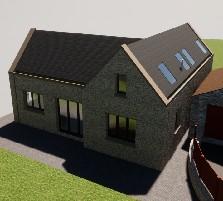

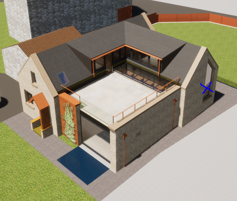

GEO-PAR Posted July 6, 2024 Share Posted July 6, 2024 Doing my first self build and project managing it myself. Just had a big retaining wall done and footings up to DPC level by a groundswork sub-contractor, who has done a good job. Now I need to get someone in to put the walls up (blockwork, cavity, surecav and natural stone on the outside). To keep my costs down, the intention was for me to get all the materials to site ready and then have a few guys on day rate putting it up (with some idea on how many m2 they'll do a day). I was given a recommendation for some guys, but they have been consistently reluctant to give an idea on timescale, overall cost or what m2 they can achieve in a day. The only thing I know is they charge £190 a day each and they're planning to have three of them on site (so £2850 a week for the three of them). I have a lot of respect for and trust the person that recomended them, and he assured me you will get a day's work out of them for the money. However I'm getting very nervous and feel like I could be potentially handing someone a licence to print money, and if we fall out mid way through, no other builder will want to touch it? I also worry I could be going into this a bit blind? Is this normal? I feel like paying someone day rate for small jobs like garden walls etc is fair but not to stick up the walls on a whole house? Link to comment Share on other sites More sharing options...

BadgerBadger Posted July 7, 2024 Share Posted July 7, 2024 (edited) 8 hours ago, GEO-PAR said: I attempted to keep it simple whilst also keeping the planners happy (going for a modern cottage vibe). Looks nice! It's a long way from developer site box-shape though so don't underestimate it's build complexity. My advice if you're going direct with trades is you will need to be across all the technical details, there's money to be saved but don't forget you've cut a level of expertise out that needs to be filled. I found people can be a bit blasé about the difference between contractor led vs individual trades build routes, and we very nearly got caught out. Edited July 7, 2024 by BadgerBadger 1 Link to comment Share on other sites More sharing options...
