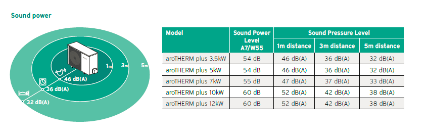

Post and beam Posted July 4, 2024 Posted July 4, 2024 My permission is with East Herts. Initially ( last year) i was told that they would measure the sound from my installed ASHP and determine if it was suitable. I told them there was no way i would buy one first and then find out if it was o.k, nobody would do this. Earlier this year, when i applied to discharge the environmental condition, i had to submit the manufacturers documents for chosen ASHP ( Vaillant 7kW) and make a written response to each line item of the section notice about heat pumps. Visibility from the road, dont mount it on a wall facing the road, listed buildings etc. Sorry i cannot remember the documents correct name. Finally i made the point that in our case we were at least 9 metres from a neighbour boundary. I graphed the sound fall off in dB per metre. They were happy enough to allow me to go ahead. Sorry this does not answer your question with much in the way of specifics. 29dB(A) is like a ticking clock on your mantlepiece, madness. I could tell you who i dealt with at East Herts but not in open forum. You probably know who. There is someone else on the forum who has installed a Vaillant in a Rural location near Stanstead. She may see this thread. keith
