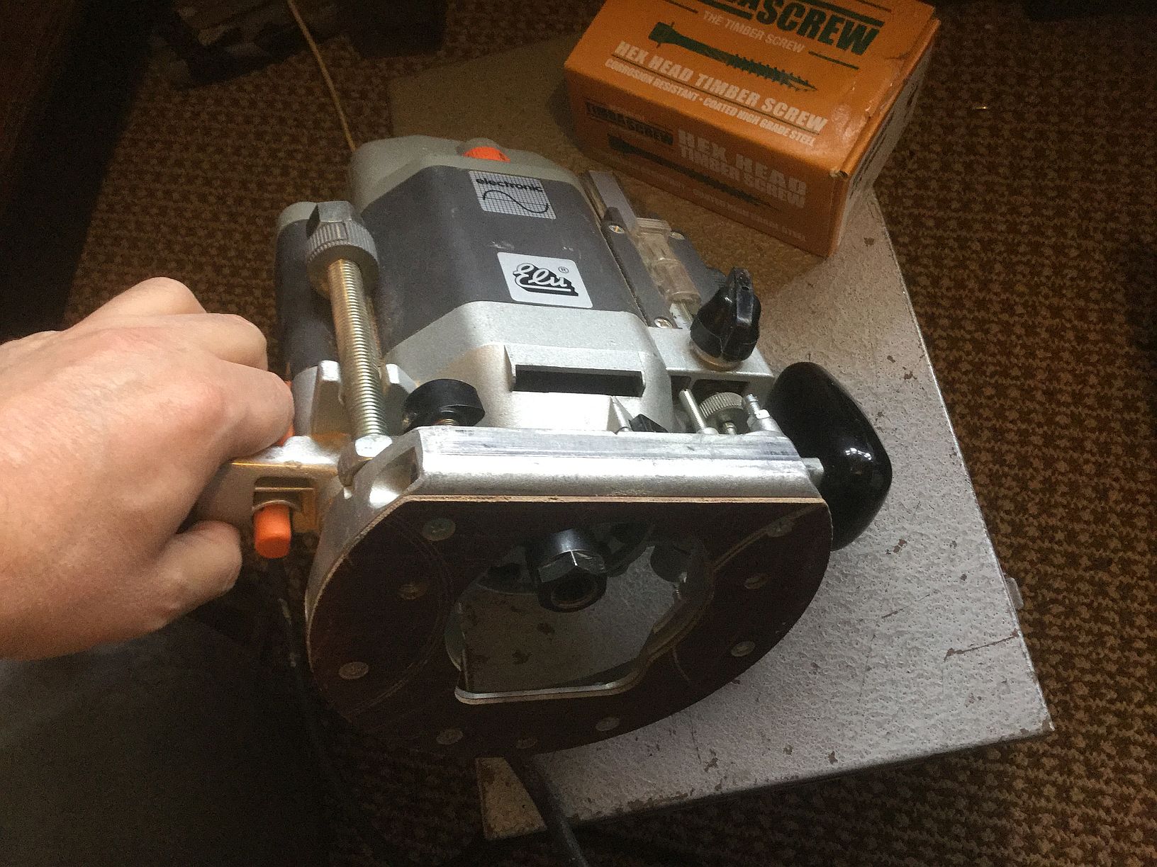

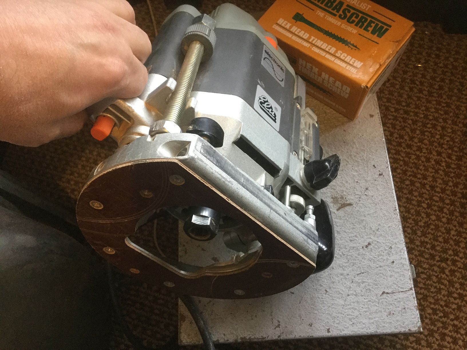

Ferdinand Posted October 22, 2017 Share Posted October 22, 2017 (edited) So, rooting through the power tools inherited from dad I finally investigate the router. It turns out to be one of these Eru MOF 177/2 Type 2, with an 1850W motor. The exploded parts diagram in the manual is stamped Apr. 89. Dad certainly bought good tools. Given that ELU were taken over by deWalt (subsidiary of Black and Decker) in 1994, it must be 1989-1994 vintage. I think it still exists as the evolved deWalt DW625, which can still be bought in Screwfix. I am seeing posts from about 2009 saying "an old 'un but a good 'un - pity they were taken over, buy one secondhand. I have had mine 25 yeas and it is still going strong". So they would be the bees-knees when we still had bees. So presumably dad's choice of tool was pretty good. Is there anything i need to know, never having used a router before? The context is a worktop needing fitting with 2 right-angles on Monday or Tuesday , but for that I think I will oppo for somebody who is experienced, despite having grasped the concepts. cheers Ferdinand Edited October 22, 2017 by Ferdinand Link to comment Share on other sites More sharing options...

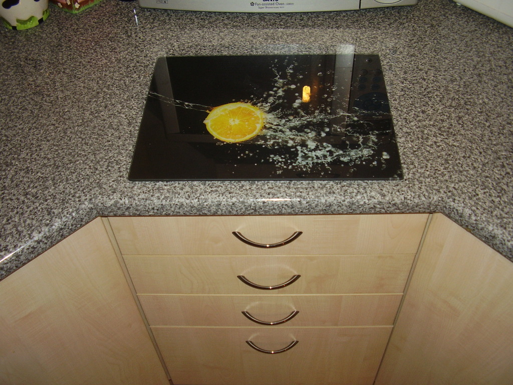

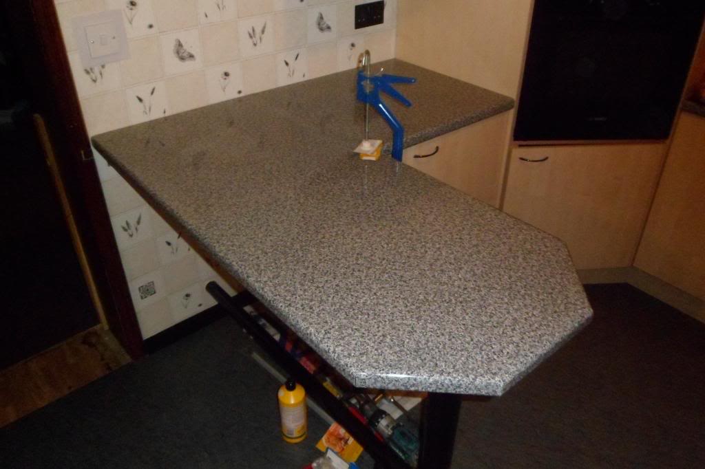

Onoff Posted October 22, 2017 Share Posted October 22, 2017 (edited) Worktop jigs can have different pin holes for different width worktops. Always clamp your jig. Always cut from left to right. Plan your cuts so you'll only ever break out through a chipboard face at the end of the cut NOT the "melamine" face. Routers make damn good edge planers for ordinary Contiboard - jigsaw to within say 3mm of the required cut line then use the router to finish against a clamped fence. Have you a biscuit joining tool or bit for the router? No.20 biscuits too. I was lucky, my chippie mate versed me on routing! Mottled patterns are more forgiving! This is a breakfast bar made in the cheap with standard worktop that had only one rounded edge: Edited October 22, 2017 by Onoff 1 Link to comment Share on other sites More sharing options...
PeterW Posted October 22, 2017 Share Posted October 22, 2017 2 hours ago, Ferdinand said: context is a worktop needing fitting with 2 right-angles on Monday or Tuesday £10 says they aren’t right angles...... Knowing how to set the jig up is key - 89 degrees on a corner will give you a big gap to fill over 3m so understanding the jig is the first starting point. The routing bit is the easy bit. Howdens regularly have their economy kitchen fitter router cutters in the £1 offers - they are Trend branded and good for a decent kitchen fit and are disposable at that price. The bit is more important I think than the unit itself - my 1200w 1/2” is perfect for worktops due to its size and is powerful enough to drive a 50mm bit. It’s not as bulky as my mates 2000w Dewalt lump that is heavier but does it a bit quicker. Link to comment Share on other sites More sharing options...

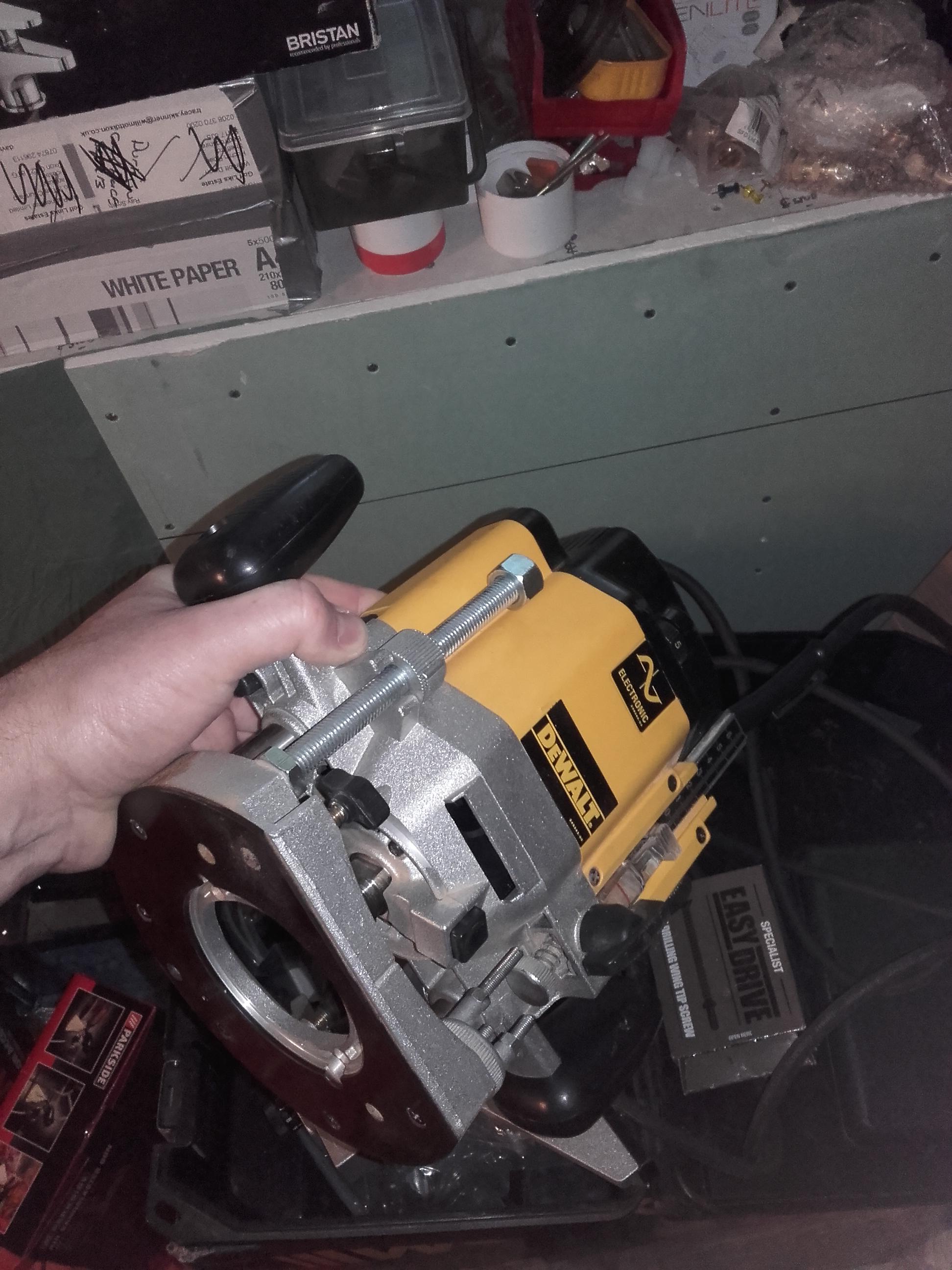

Onoff Posted October 22, 2017 Share Posted October 22, 2017 The 110V DeWalt I have here is a proper beast. Heavy but so, so smooth. Link to comment Share on other sites More sharing options...
Ferdinand Posted October 22, 2017 Author Share Posted October 22, 2017 19 minutes ago, Onoff said: The 110V DeWalt I have here is a proper beast. Heavy but so, so smooth. is 5.1kg heavy? Link to comment Share on other sites More sharing options...
Ferdinand Posted October 22, 2017 Author Share Posted October 22, 2017 1 hour ago, PeterW said: £10 says they aren’t right angles...... Do you mean the walls it is going against, or the worktop when finished :-). ? This is going to cost you £10. The wall is already right-angled, 'cos one side is boarded out make it so. If you meant that, fork out now my friend. 1 Link to comment Share on other sites More sharing options...
Onoff Posted October 22, 2017 Share Posted October 22, 2017 35 minutes ago, Ferdinand said: is 5.1kg heavy? Yep, noticeably so. Picking it up one handed is a feat. This thing is a proper big boy's toy. The weight is off putting at first but the stability and control it affords offsets that. The bearings on this are superior and it has slow start too. DW625E LX: It wouldn't take prisoners if you got it wrong but you might not feel it! Link to comment Share on other sites More sharing options...
