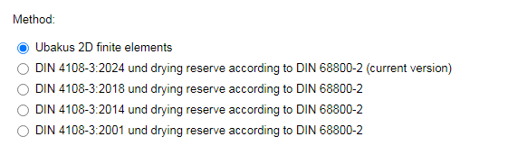

Garald Posted June 23, 2024 Posted June 23, 2024 I've read Ubakus really uses a very simple model to predict condensation. So, what is it, and where can I read about it? What do more sophisticated models (such as the one used by WUFI, which I can't use, as I don't have Windows - just failed to run it using WINE) really do? TL;DR: I would like to install outside insulation on a wall that is already insulated on the inside. I want to actually understand (the physics behind) how to make choices so as to prevent condensation - I can't just follow rules of thumb such as the "1/3-2/3 rule" and "at least 5 times as much resistance to water vapor on the inside as on the other" as they can't really be simultaneously obeyed in this sort of situation.

Alan Ambrose Posted June 23, 2024 Posted June 23, 2024 From memory doesn’t ubakus allow you to choose from a bunch of different moisture models? I’m guessing that a typical moisture analysis usually isn’t so marginal that the choice of moisture model means much anyway.

Alan Ambrose Posted June 26, 2024 Posted June 26, 2024 That's sad, it looks like it was going well. Re Ubakus: yes, here are the moisture models. The OP seems to have vanished, but I would encourage him to try the model options and see what difference it makes.
Garald Posted June 26, 2024 Author Posted June 26, 2024 On 26/06/2024 at 19:49, Alan Ambrose said: That's sad, it looks like it was going well. Re Ubakus: yes, here are the moisture models. The OP seems to have vanished, but I would encourage him to try the model options and see what difference it makes. Expand I haven't vanished! At any rate, I take the DIN this-and-that models are very simple 1-D models one can do with pencil and paper?
SteamyTea Posted June 28, 2024 Posted June 28, 2024 On 26/06/2024 at 20:40, Garald said: I take the DIN this-and-that models are very simple 1-D models one can do with pencil and paper Expand We can do those simple models, and probably use a 'solver' to make it a 2 or 3D model, but not many people can.
Alan Ambrose Posted June 28, 2024 Posted June 28, 2024 I’m guessing that they are 1D differential equations - probably more suited to simple code that pencil & paper. Did you test out what difference the various moisture models made to your stack-up or not?

Alan Ambrose Posted June 29, 2024 Posted June 29, 2024 Google the DIN standards maybe? Easily available for sale but only in German (like a lot of PHPP detail). Maybe there’s an English language explanation somewhere on the web.
