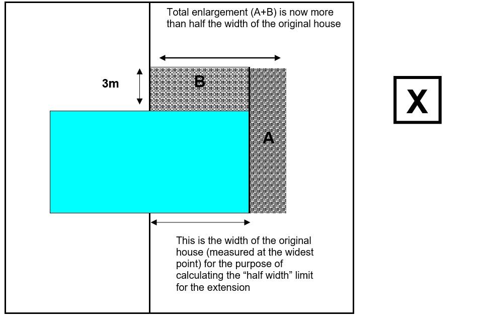

Temp Posted June 22 Share Posted June 22 (edited) 2 hours ago, Penny926 said: We have a detached house which on purchase had a side extension already in place (2 story), which extended 3M out to the back. The original house had not been extended. We applied for permitted development for a 6M rear extension for the original house. Did the planners not say anything about the combined extensions being wider than half the width of the original house? Suppose the original house was 8m wide and the first extension "A" made it 3m wider and extended out the back 3m. If you then want to build a rear extension "B" onto the original house that connects to the previous side extension "A" its width is limited to just 1m. That's because the width of the combined side and rear extension cannot be more than 4m wide (4 being half of 8m). If on the other hand your rear extension "B "did not connect to the previous side extension "A" its width could wider. In practice it could be say 6m wide, just not the full 8m as that would connect it to the first side extension. This is from the Technical Guidance.. Edited June 22 by Temp Link to comment Share on other sites More sharing options...

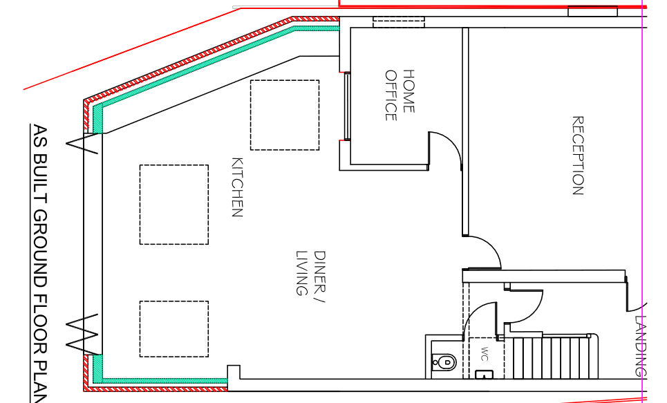

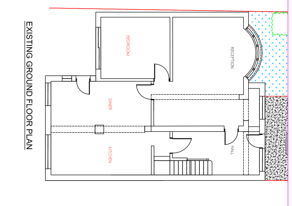

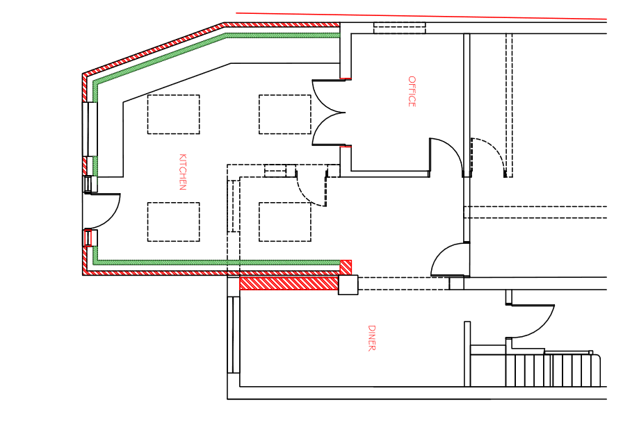

Penny926 Posted June 23 Author Share Posted June 23 Thank you all! This is very helpful! I think it might be easier to show with pictures, the side extension here is shown on the existing plan as the 'kitchen', it is unusual side extension (dates back to 1975), where they built the side extension and moved the stairs etc. Attaching the 1) Existing plan image and the 2) Approved plan under permitted development and 3) What we have built (just the shell, so substantial completion). The infill i am referring to would fill the gap between the 'diner' (on the approved plan) and the new rear wall from the approved extension. Their decision notice states: Conditions: 1. The materials used on the external surfaces of the development shall match those used in the building to which it is attached in terms of style, colour, texture and, in the case of brickwork, bonding, coursing and pointing. 2. All openable parts of any side windows in the extension shall be more than 1.7 metres above finished floor level and permanently retained as such. Any side windows shall be in obscure glazing and permanently retained as such. Once built, no further side windows shall be installed. Informative: 1. The Council cannot confirm that this development is lawful until it has been built and until you have complied with the conditions of this decision. Once you have done so, if you would like such proof, you will need to submit an application for a certificate of lawfulness of existing development and show that you have met the conditions. 2. The approved extension shall not be attached to the existing side extension. Failure to comply may result in the approved extension being unlawful. So there is a clause, about the extensions not being attached, but hard to interpret that - does it mean maintain a gap between the two? Given they are likely to reject the infill, the scenario I am hoping for is that we restore the property to what was approved and then appeal for the infill. Link to comment Share on other sites More sharing options...
MikeSharp01 Posted June 23 Share Posted June 23 1 hour ago, Penny926 said: So there is a clause, about the extensions not being attached, but hard to interpret that - does it mean maintain a gap between the two? 1 hour ago, Penny926 said: 2. The approved extension shall not be attached to the existing side extension. Failure to comply may result in the approved extension being unlawful. Couple of observations - not sure they are helpful though. I interpret that as meaning you cannot extend the existing side extension (the 1975 one) you could build off the the second one and, as you say maintain a gap between them but that would mean your kitchen diner having a pair of walls, with a gap, jutting out into it where the diner window is now so it seems a daft thing to do. Given that, there must be some other motivation for the clause and I have no idea what that might be. On another matter you seem to have removed the pillar in the middle of the original kitchen diner - presumably with some structural work, will having to restore the building compromise that? Have other houses in the road done the same thing you have done? Finally do we take it that you still have a right to normal retrospective planning permission or is permitted development your only available route here for other reasons - maybe I missed something. Link to comment Share on other sites More sharing options...
Penny926 Posted June 23 Author Share Posted June 23 Thank you Mike! Yes maintaining a gap would be odd - which is why I kind of think that clause is also kind of strange. I'm hoping we can appeal on those grounds. We have indeed moved the middle pillar, but will have to incur cost now to move it back and correct the structure. We live on a road with a varied style of houses, but yes there are examples of this kind of extension. I think the council are being very strict on the extension of an extension rule, which I can understand but is frustrating. We have put the 'as built' image through retrospective - this is what I think they will reject. Link to comment Share on other sites More sharing options...
DevilDamo Posted June 23 Share Posted June 23 Firstly, all PD/PA works have to be built/completed prior to applying for or building any extensions under Full Planning. Secondly, I’m surprised you were granted Prior Approval as it doesn’t comply with the PD requirements. Reason being is that it’s a wrap-around extension and the width is greater than half the width of the original house. Link to comment Share on other sites More sharing options...

Penny926 Posted June 29 Author Share Posted June 29 Hi all - an update on this matter. I sent the council an email asking them what the likely decision would be.. here is what they said: - there is nothing that indicates the prior approval extension had been built in accordance with the plans or legislation. - In order to rectify this, you will have to demolish part of the extension and built in accordance with the plans submitted as part of the prior approval application. There would need to be a gap between the extension and the existing side/rear projection - You can withdraw this application and once the extension has been rebuilt in line with the above, you can then apply for the infill extension. This will very likely be the quickest way to resolve this. Firstly, I am grateful that they took time out to respond. I responded back saying we would start the rectifying work they requested. I also suggested instead of withdrawing, could we rectify and update the application, the statutory expiry date is not till the 10th July, so if we can get the work done and show it to them then no need to withdraw.. (i'm not sure if they will accept this, but seems more logical then withdrawing and resubmitting..) Link to comment Share on other sites More sharing options...
DevilDamo Posted June 29 Share Posted June 29 Logic and Planning do not go in the same sentence. Amendments like that would require re-consultations and those persons would normally be given 21 days, which will take the application beyond the target date. I’d be surprised if they were to agree to any amendments this late in the process. Link to comment Share on other sites More sharing options...
