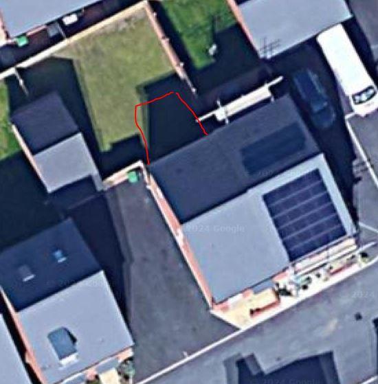

recognized Posted June 19 Share Posted June 19 Hello, This is my first time writing here. I want to build a Lean to veranda to the back of the house. It is a semi-detached property build in 2020. There is no conservation etc. How high I can start for that Lean-to ? Building regs are quite vogue about it. Link to comment Share on other sites More sharing options...

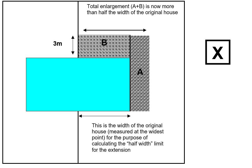

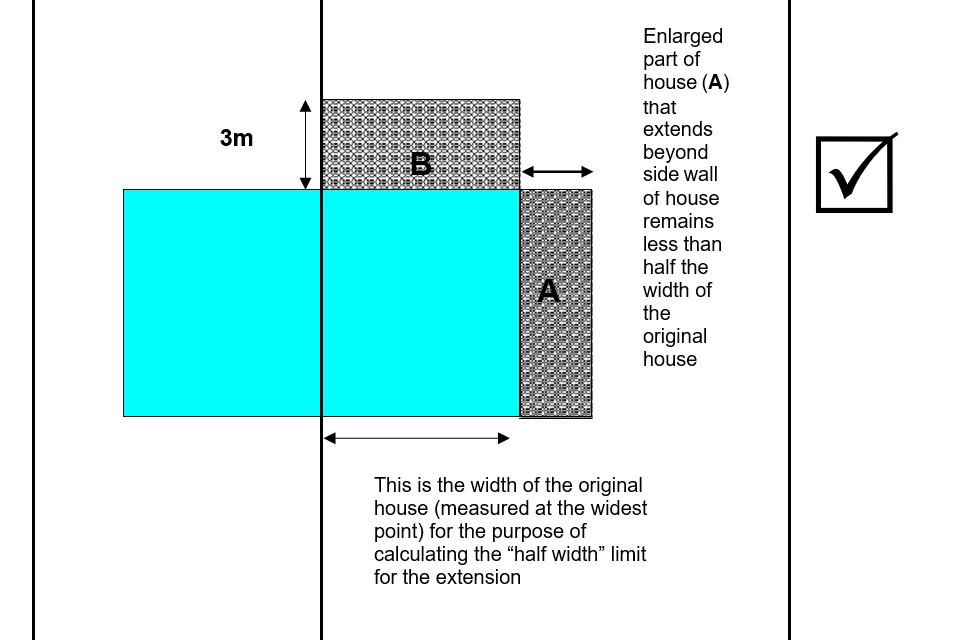

joe90 Posted Tuesday at 20:21 Share Posted Tuesday at 20:21 For my own knowledge I have been looking into this and it’s odd that a rear extension is allowed up to 3m in depth but not a veranda 🤷♂️. Also planning portal talks about “half the width of the original house but in this looks to be ok for the full width of the house (B), am I going senile. (Don’t answer that) Link to comment Share on other sites More sharing options...

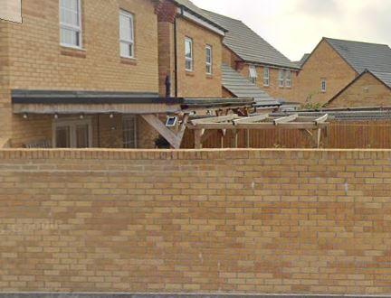

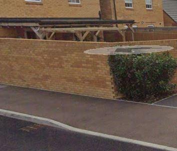

recognized Posted Thursday at 15:36 Author Share Posted Thursday at 15:36 That what I actually meant with "its vogue about it" in a nutshell I just want to something of similar size like on the picture minus pergola thing beside it and roof of that corrugated plastic that you usually seen used in these applications. Mine is picture 3 (satellite). As I understand pergola becomes a veranda as soon as you attach it to the house? What about the decking under 300mm? Link to comment Share on other sites More sharing options...
