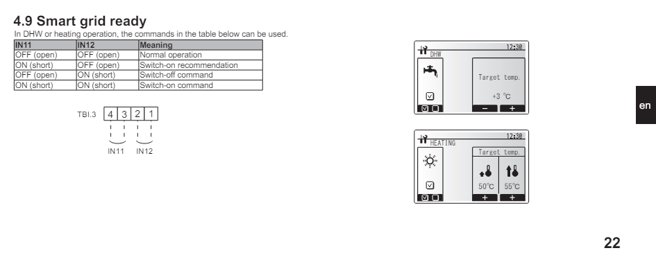

joth Posted June 13 Share Posted June 13 (edited) What battery do you have? (And what inverter is it connected to?) Rather than worry about the PV at all, really the main thing you want to know is "Is the battery full". Whenever it is, then put the ASHP into "DHW boost" mode. The ecodan this is fairly easy: you need a relay to close input IN11 (the so-called Smart Grid Ready feature) which tells it a switch-on recommendation. Then in the settings, you configure a DHW target temp boost of +10C or whatever in the smart grid settings -- see page 22 of the FTC6 installer manual The tricky bit is knowing the battery is full - very battery dependent. Note I'm assuming that you can charge the battery at the rate of excess energy generated, i.e. 13kW minus your base load. If you are limited on the battery charge rate you may indeed want to trigger the DHW boost sooner, based on grid export exceeding a threshold or PV generation above a certain level. this should be possible from a correctly shelly energy monitor, and a 240V coupling relay to connect into the FTC6 - see https://www.instructables.com/Shelly-EM-Auto-Toggle-Based-on-Solar-Panels-Produc/ Edited June 13 by joth Link to comment Share on other sites More sharing options...
