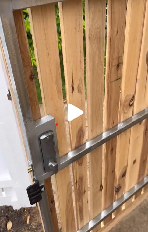

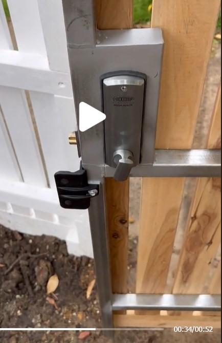

ToughButterCup Posted June 12, 2024 Posted June 12, 2024 I need to make a gate for what I hope will be a reasonably secure area in our outhouse. That means a metal frame. The frame will carry some lightweight cladding - The question is what's a reasonable spec for the metal used in the frame ? 30mm square section tube?, Is that too heavy? Here's a couple of screen-grabs of a design that I'd like to follow. (from TikTok) What do you think? 25mm, square section enough ?
markc Posted June 12, 2024 Posted June 12, 2024 I would go 30mm thin wall, 1.5mm ish for stiffness. You won’t be having high compressive or tension loads so no need for thicker wall thicknesses. 1
Russell griffiths Posted June 12, 2024 Posted June 12, 2024 As mark said, it’s the wall thickness that will decide the weight 25 x25 x5mm. Will be heavier than 30x30x1mm wall thickness have a think how it’s being welded this might guide you choice of wall thickness. 1.5mm isn’t a bad place to start. remember we have seen your welding previously. 😂😂😂 1 1
