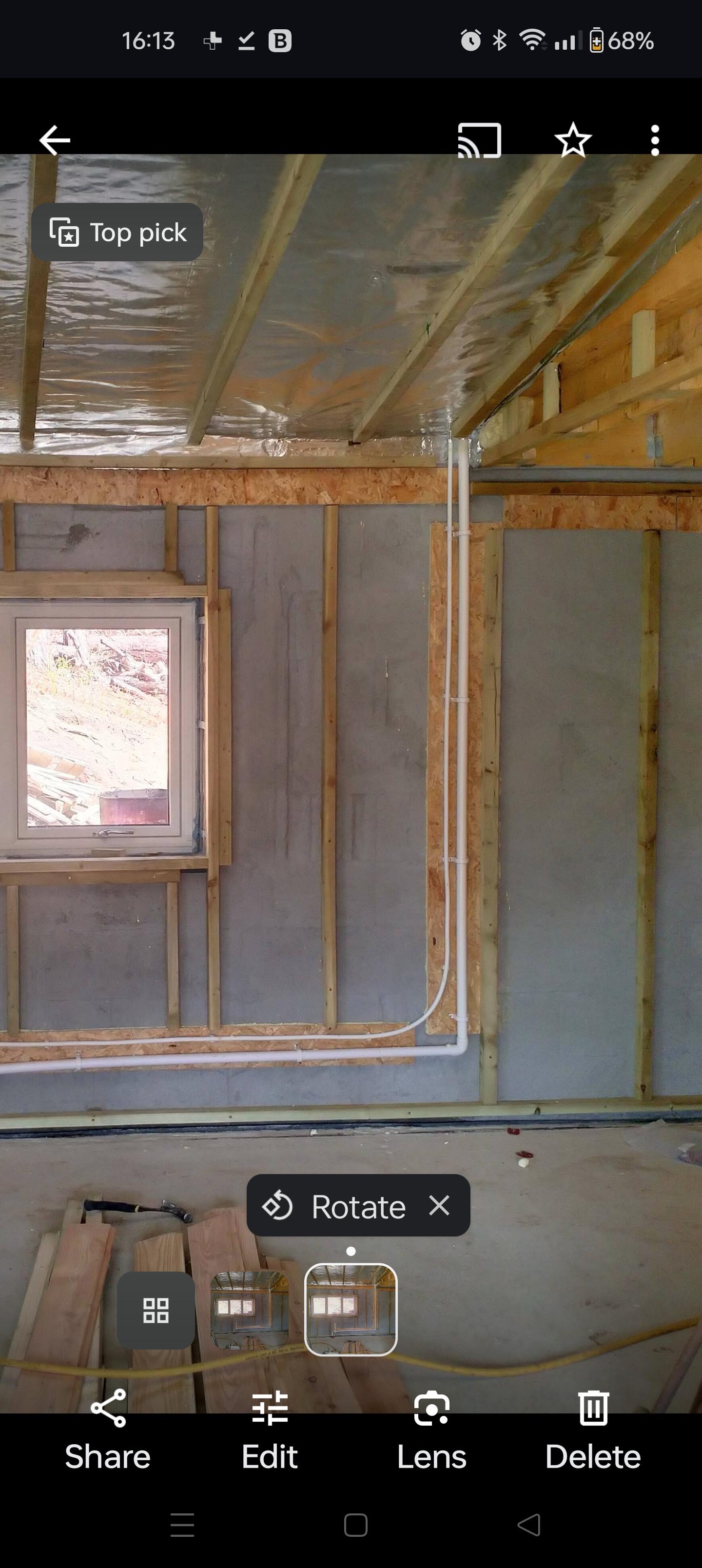

Doesn't really answer your current need, but for anyone reading, I used 50mm service cavity and added a sacrificial strip of osb to the wall so the electrician could pin to their cables if they wanted. Made it thick enough to take the pins and not go through where I didn't want them. Used expanding foam adhesive to stick the osb in place. Used the same method for the plumbing also.
Thought why fight what they will do, as soon as I am out the room, just tell them where the wires have to go.
Osb strip at top of wall for wiring.
