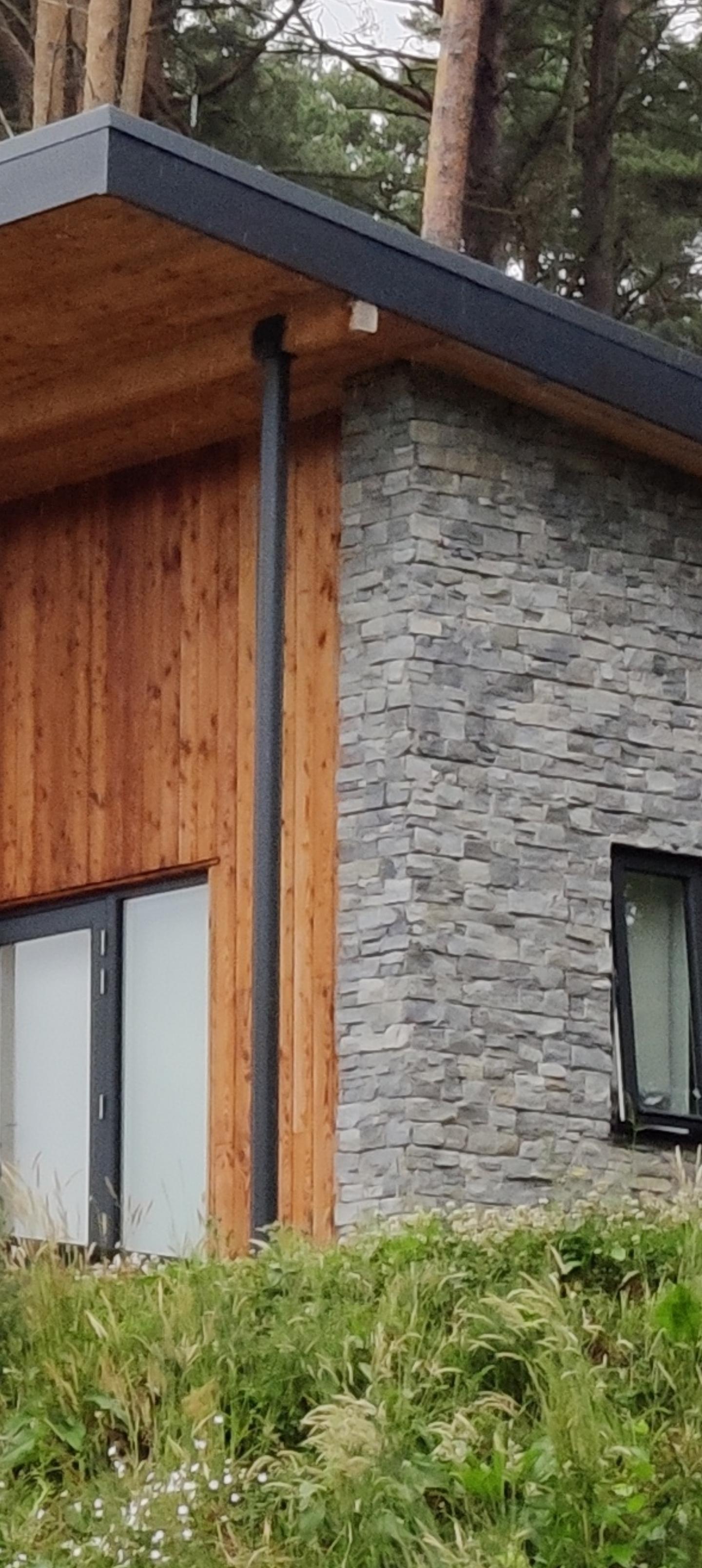

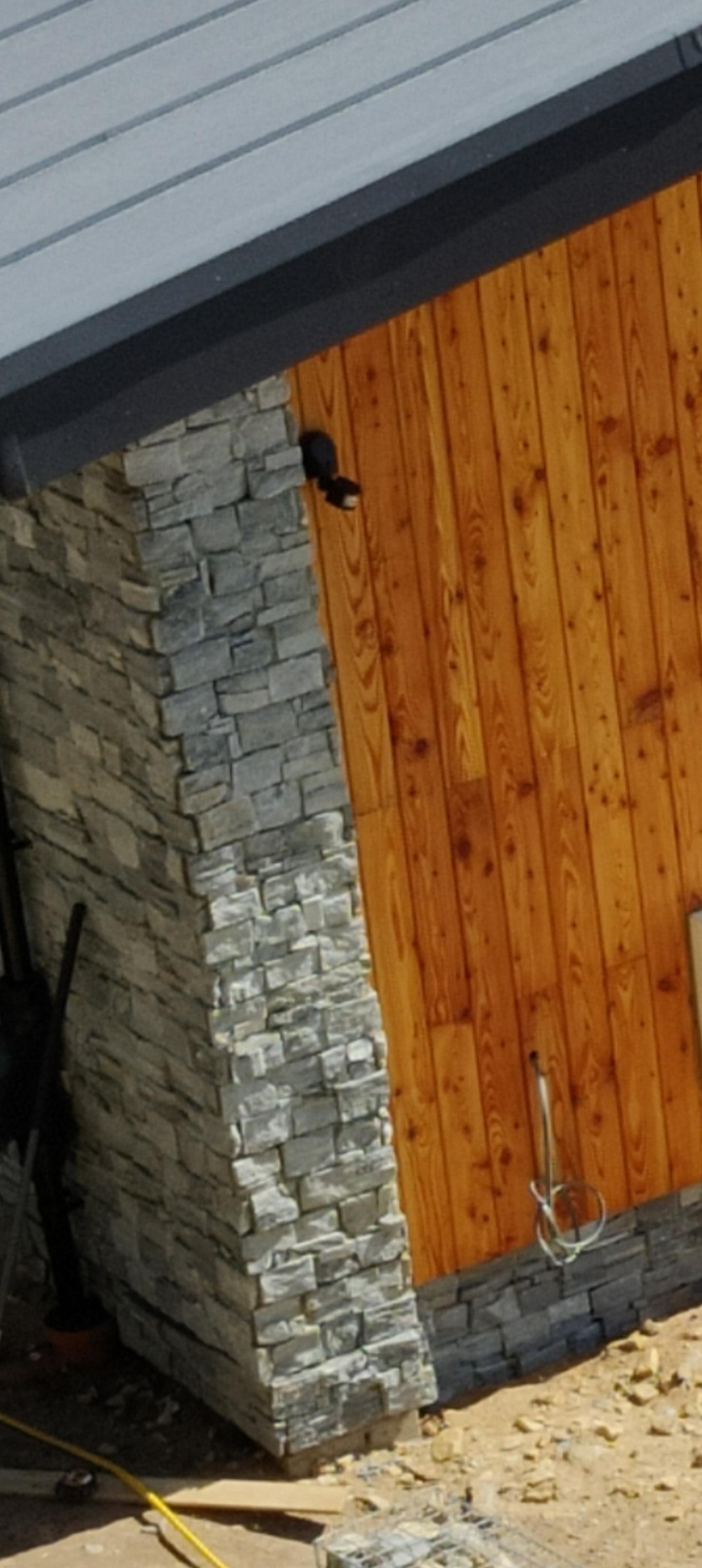

G and J Posted June 19, 2024 Author Share Posted June 19, 2024 1 hour ago, JohnMo said: Taking a pragmatic look at this. You will have larch everywhere except the end of the building which will be some sort of non combustible so will not look the same as the rest of the building. So instead of doing the same effect with different looks which may look odd. Do the polar opposite, do a finish on ends completely different. Not saying do this, but as an example, we have a mix of cladding and stone slips. So your end walls are fully compliant you get a different design feature and the different design may actually lead to a thinner wall (maybe). A couple of different images Interesting idea. The non larch bits are either glass or render and I think the render will be ok on the same wall build up as the larch. (Dangerous thing, assumption!) We put a lot of thought into the look of our new pad and we’d be disappointed if we have to change it, plus, I’ll not be going back to the planners unless I have to. They’re lovely, helpful peeps but it slows everything down so much! Link to comment Share on other sites More sharing options...
