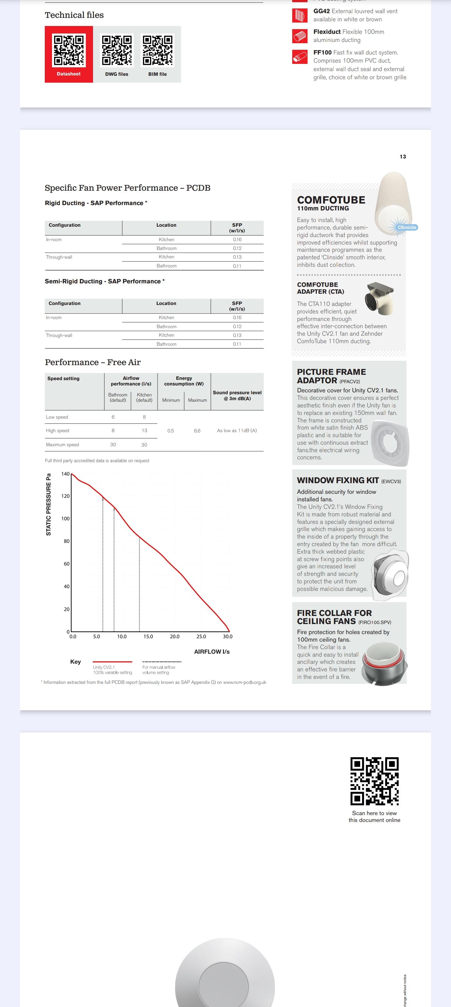

Would an inter room fan work better?
Something like this will do 70m3/h - but very pricey.
https://www.ventilationland.co.uk/en_GB/p/brink-indoor-mixfan-co2-controlled--up-to-70-mh/17927/
An alternative could be a greenwood CV2GIP, or similar control boost via a couple of temp sensors and switch logic.
Screenshot_2024-06-03-18-48-30-90_e2d5b3f32b79de1d45acd1fad96fbb0f.thumb.jpg.72957177ea3b62f69ce6c77b41b00661.jpg

Brink one does. But the alternative I offered - the Greenwood one, is almost silent in operation and cheap to buy. I paid about £40 for one on eBay.
Let me understand - that's not a MVHR system, but rather a moisture-sensitive quiet extract fan without heat recovery?

@SteamyTea talked about heat pipes, I proposed an inter room fan, which could be ramped up to help even out temperature.  The two types of fan I provided are just fans and nothing really to do with there intended duty. Just being used to move air around the house - not a ventilation strategy, not MVHR or anything else.
Ah, sorry for misunderstanding you. So, what is the role of the Greenwood fan, really? To move air out of wet rooms into the rest of the house?

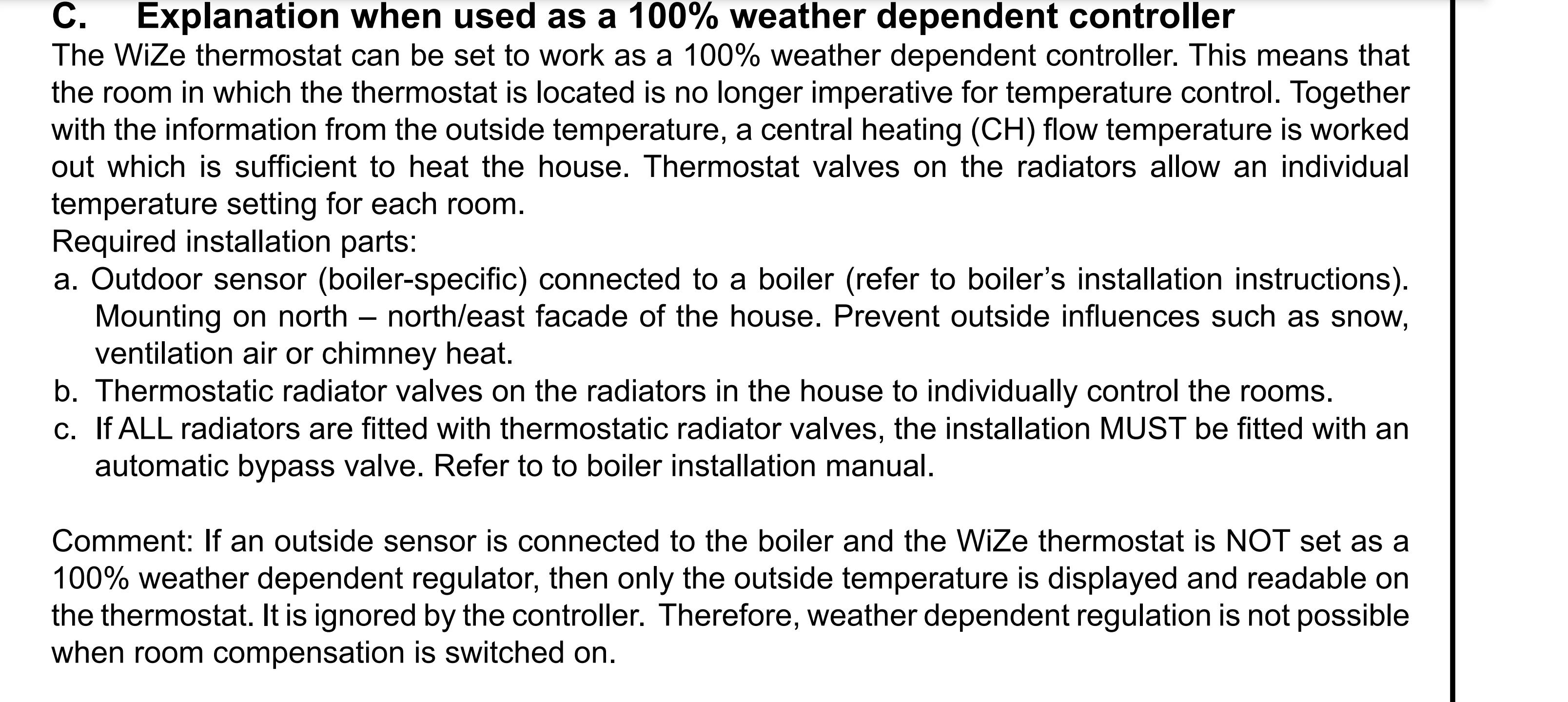

This is what my boiler manual said about weather compensation and how to set up the house and it's heating system. Note: system is operated as a single zone, the thermostat valves should modulate individual room radiators instead of switching on/off as a zone valve would do. So the heat pump just sees a small change in return temperature and then modulates it's output as required.

What would seem intuitive to me would be to have the thermostat in the coldest room in the house, *not* install a thermostatic valve there, and install thermostatic valves in all other radiators.
Of course this is complicated a bit by the fact that I don't use the coldest room of the house much of the time (it's a guest room; I may find another use for it, but haven't yet). When it's not occupied, it's fine (I think) if on winter days it stays at 17.5C while the other rooms are at 20C. The logical thing to do then may be:
- not to install thermostatic valves in either the coldest room or in a room in what is the second coldest space in winter (the attic - the roof insulation is basically that installed 10 years ago),
- if the guest room is being used, set its radiator and that in the room in the attic to max, and let the other rooms regulate themselves; put the thermostat in the guest room; turn down the heating in the attic room if the temperature gets too high or if it isn't being used;
- if the guest room is not being used, set its radiator to a low level (not zero), set the radiator in the attic room to max, put the thermostat in the attic room, and let the other rooms regulate themselves.
I suppose the "interference" between the heat pump and the thermostatic valves comes from the fact that, if the thermostat is placed in a room where the radiator has a thermostatic radiator valve, the radiator valve may (and will) close when the temperature is attained, and then the heat pump will not regulate by lowering flow temperature, and we of course want the heat pump to lower flow temperature.
