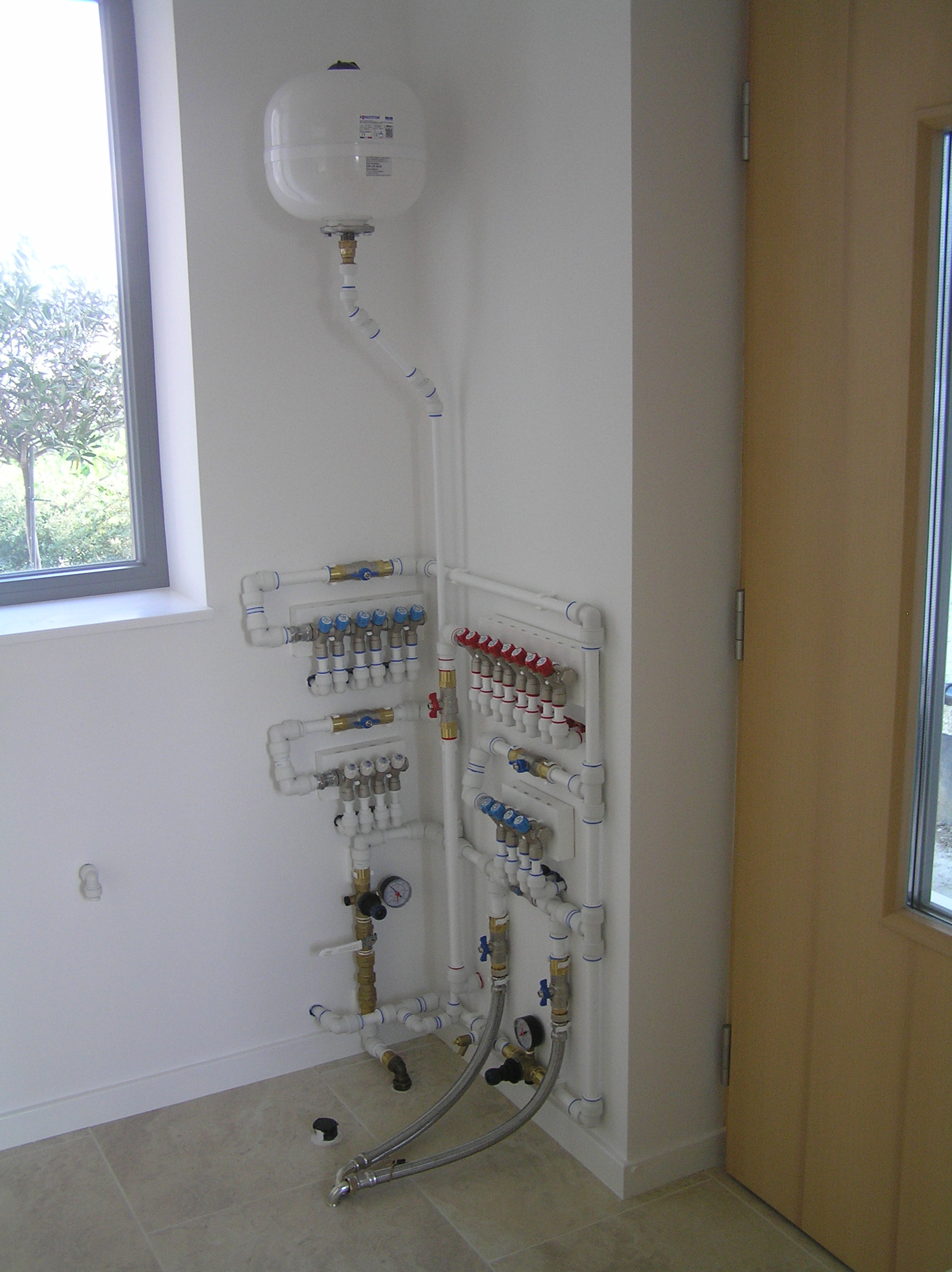

PeterW Posted October 18, 2017 Share Posted October 18, 2017 Playing devils advocate here.... If Genvex sell a unit into the UK market then their MIs should provide for a safe and compliant install as the unit has to be CE marked. To meet that standard it is required to be installed in a manner to meet the regulations of that country. So whilst I take on board what @Nickfromwalessays, I do wonder if this is not actually a standalone UVC, but is actually a complete unit with systems that when installed using the MIs, is compliant with the regulations.... I think an email to the manufacturer asking for the correct installation instructions to meet the UK regulations would be the quickest - and safest - method. And @PeterStarck - nice tidy pipework ..! Are they Speedfit manifolds..?? Link to comment Share on other sites More sharing options...
Gone West Posted October 18, 2017 Author Share Posted October 18, 2017 Just now, PeterW said: And @PeterStarck - nice tidy pipework ..! Are they Speedfit manifolds..?? Yes they are. Speedfit is not everyones favourite but I think for amateur plumbers like me they are safer as when the connection is made and a collet clip is inserted you know its connected properly. Link to comment Share on other sites More sharing options...
