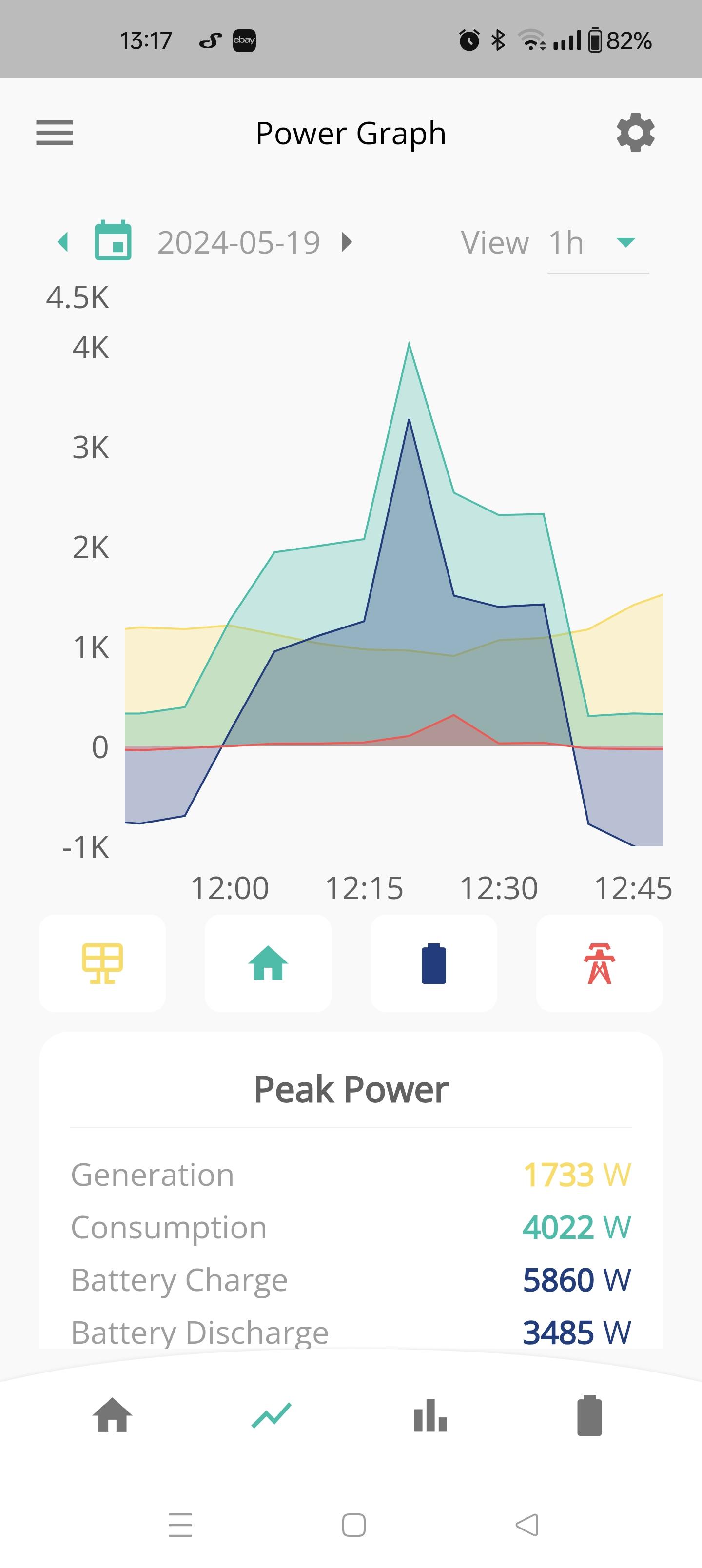

JohnMo Posted May 19 Share Posted May 19 1 hour ago, G and J said: just starting to get my head round how the Solar PV systems can work A snapshot of our battery app. Showing an hour today, doing DHW heating and the spike is kettle going on at the same time. It's cloudy today and only generating around 1kW Yellow is PV output Green is electric demand from house Blue is what the batteries doing, below red line is being charged, above red line is giving electricity to house Red is what the grid is doing. So today, when we do hot water heating, the PV isn't sufficient, so we borrow from the battery, as soon as the heating is finished, excess PV flows in to the battery until fully charged. Link to comment Share on other sites More sharing options...

G and J Posted May 19 Share Posted May 19 2 hours ago, JohnMo said: A snapshot of our battery app. Showing an hour today, doing DHW heating and the spike is kettle going on at the same time. It's cloudy today and only generating around 1kW Yellow is PV output Green is electric demand from house Blue is what the batteries doing, below red line is being charged, above red line is giving electricity to house Red is what the grid is doing. So today, when we do hot water heating, the PV isn't sufficient, so we borrow from the battery, as soon as the heating is finished, excess PV flows in to the battery until fully charged. Interesting. I’ll re read that a few times and try and get my head round it. Our current thinking is that batteries have a payback period of circa 10 years, just based on some fairly broad brush calcs. At that payback we will wait until after we know exactly how much our build will cost overall before finally decide to add batteries or not. I appreciate that it’s a ‘how long is a bit of string’ question, but what sort of payback period do you feel you are looking at for your batteries? Link to comment Share on other sites More sharing options...
