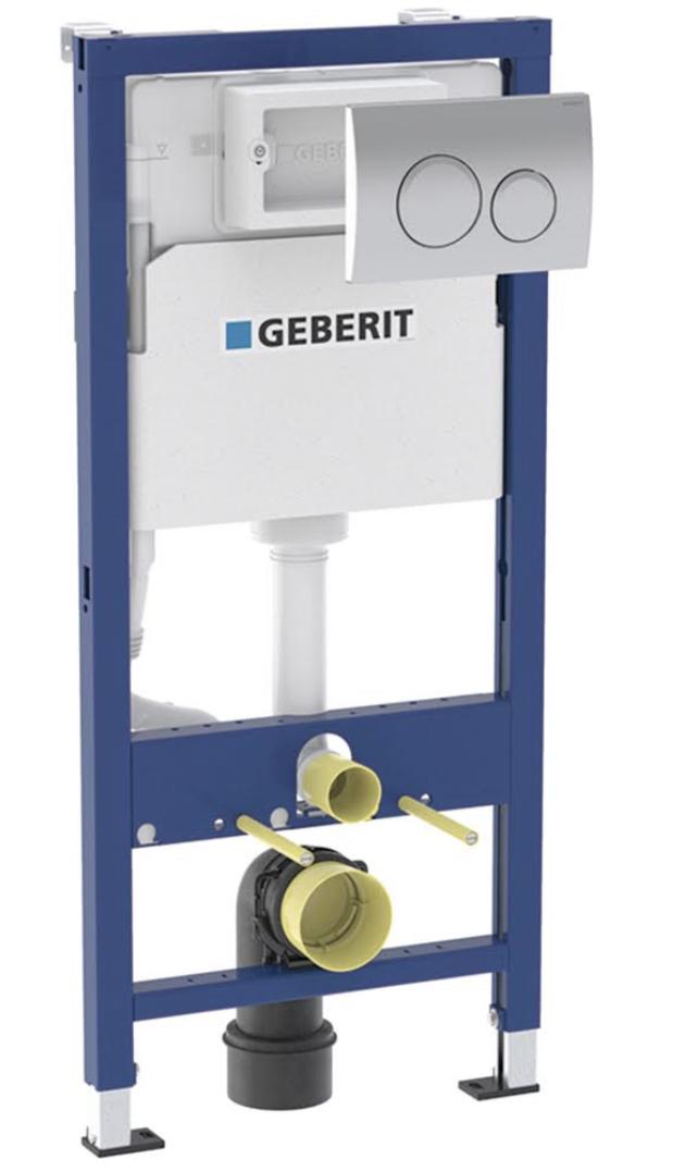

G and J Posted May 17 Share Posted May 17 Hi all. Slowly working through my humongous list of don’t knows in advance of starting detail design. One thing that’s troubling my cynical mind is the use of things like: https://www.plumbworld.co.uk/geberit-1120mm-duofix-frame-delta-concealed-cistern-and-delta20-flush-plate-round-buttons-2255-1274020?utm_source=organic&utm_medium=shoppingfeed&utm_campaign=googlebase&gad_source=1&gclid=EAIaIQobChMI_9vTy4CVhgMVI4hQBh0-lg1BEAQYDCABEgI9CfD_BwE I have searched for goods and bads and haven’t really come up with much. I’ve watched the vids which claim to demonstrate that all necessary maintenance can be done through the hole covered by the chrome plate that surrounds the buttons. We’re having wall mounted potties mounted onto studwork. Anyone had good/bad experiences with these that are happy to share I’d be grateful. Link to comment Share on other sites More sharing options...
nod Posted May 17 Share Posted May 17 I installed four at our house and have had no issues and five at our current As none plumber Very quick and easy to instal Link to comment Share on other sites More sharing options...
saveasteading Posted May 17 Share Posted May 17 (edited) 1 hour ago, G and J said: good/bad experiences with these that are happy to share I’d be grateful. Installed by a plumber, sorted by me. A flush vacuum pipe popped off but could be sorted through the plate. The pan became loose. It needed scarily severe tightening of the plastic bushes that grip it to these protruding bolts. And I recall the installation being easier than the instructions imply. All good. Edited May 17 by saveasteading Link to comment Share on other sites More sharing options...

Temp Posted May 17 Share Posted May 17 We have two wall mounted WC with these concealed frames and cisterns. In my case they are in boxing below windows. You can service them through the flush plate but I formed an access panel on the top of the boxing as I'm over cautious. Haven't needed to use it. Shop around as prices vary. There was once a German eBay seller that was cheap but that was pre Brexit. Note that the distance between flush, soil pipe and bolts is not a standard ! Most pans will fit but it's worth checking before buying as there are some exceptions that won't. Remember to set the height of the feet taking into account any floor tiling. Basically follow the instructions and all goes smoothly. 1 Link to comment Share on other sites More sharing options...

Kelvin Posted May 18 Share Posted May 18 I installed two of them. Really easy. The most important thing is to make sure they are securely fixed so zero movement both of the frame and the plasterboard over it. The instructions include the option of screwing the plasterboard to the frame. You can also stick the plasterboard to the frame. My only complaint is the Delta 20 flush plate is cheap and plasticky. 1 Link to comment Share on other sites More sharing options...
