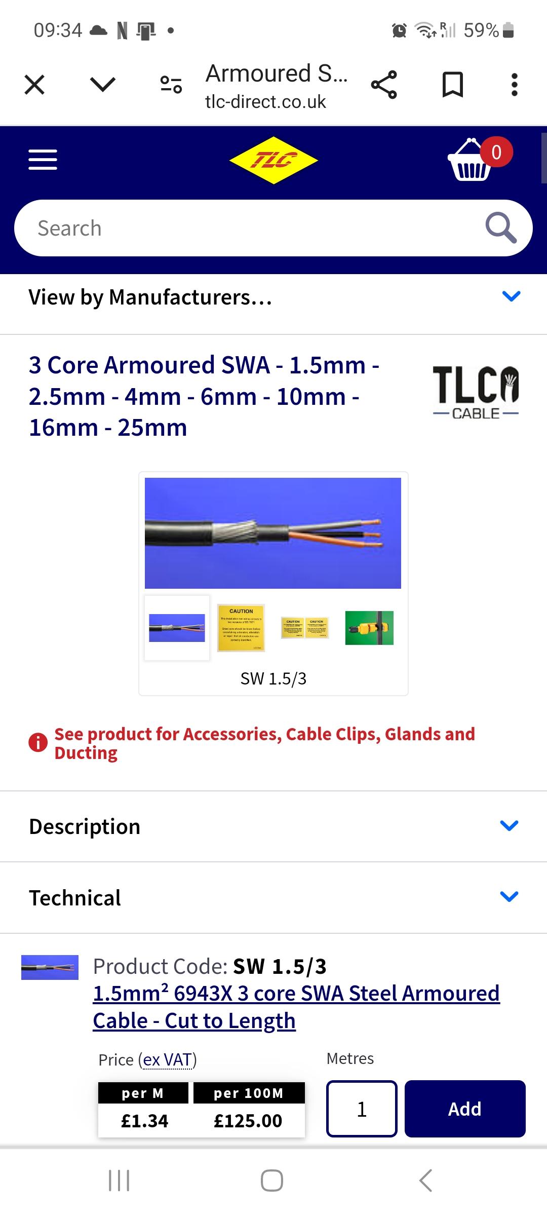

saveasteading Posted May 17, 2024 Share Posted May 17, 2024 2 hours ago, Del-inquent said: on massive lengths of - I only need 5m TLC will supply any length cut to order. They aren't nationwide , but surely some other specialist does this too. 1 Link to comment Share on other sites More sharing options...
Del-inquent Posted May 17, 2024 Author Share Posted May 17, 2024 3 hours ago, saveasteading said: TLC will supply any length cut to order. They aren't nationwide , but surely some other specialist does this too. They don't list it cut to size on their website, I'm going there tomorrow for a few other bits so will ask, cheers Link to comment Share on other sites More sharing options...

saveasteading Posted May 18, 2024 Share Posted May 18, 2024 13 hours ago, Del-inquent said: cut to size on their website Link to comment Share on other sites More sharing options...
Onoff Posted May 18, 2024 Share Posted May 18, 2024 2 hours ago, saveasteading said: I think it's the duct he wants in a short length. 1 Link to comment Share on other sites More sharing options...
